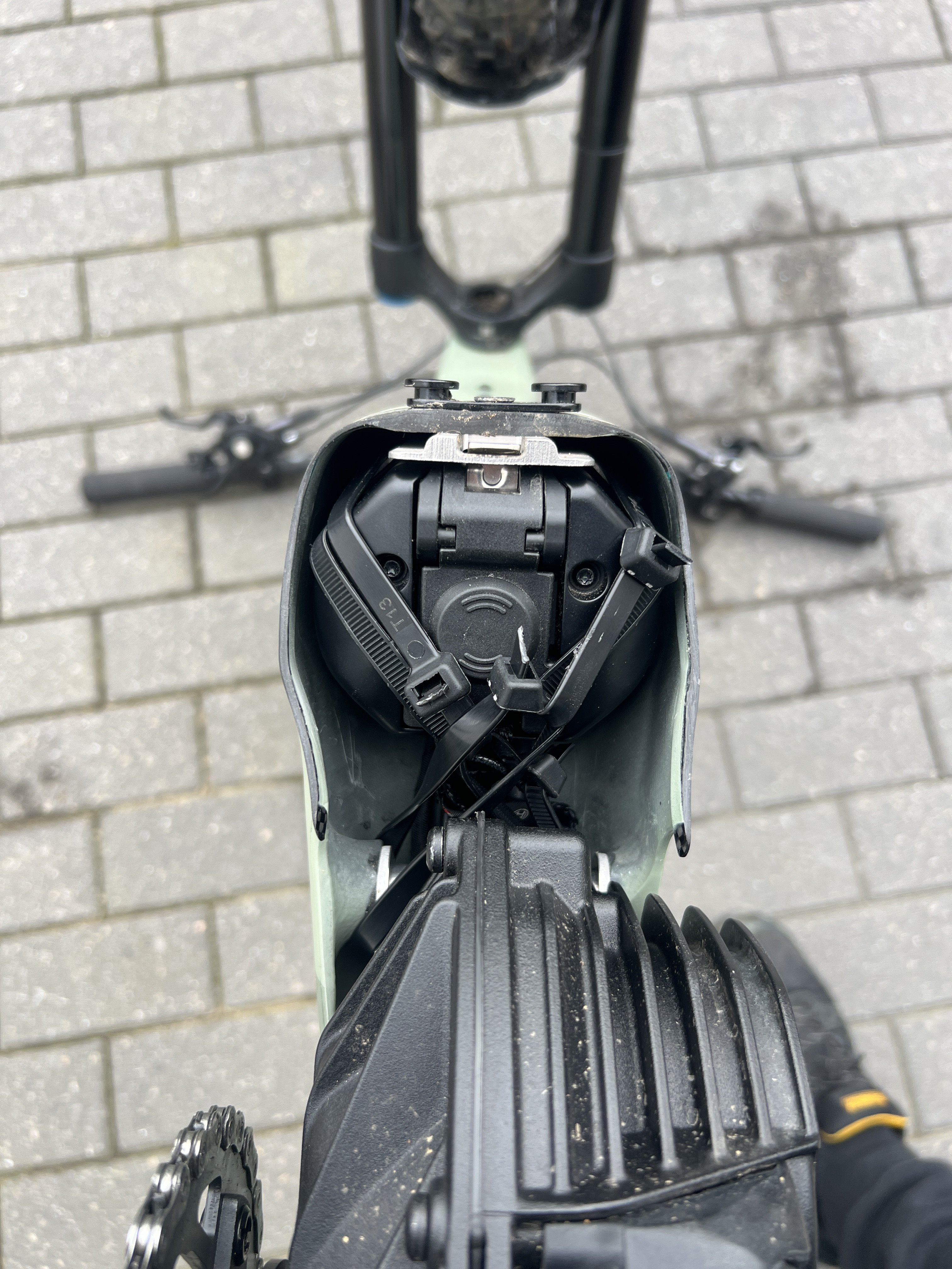

The issue has not returned, since I used this fix. At least for 5 rides of about 3 hours. enduro stuff.
i checked the battery connection last weekend, and it still looks good, no wear.
I also think that the main issue is up and down movement. the snugger it sets the less side to side movement it will have as well.

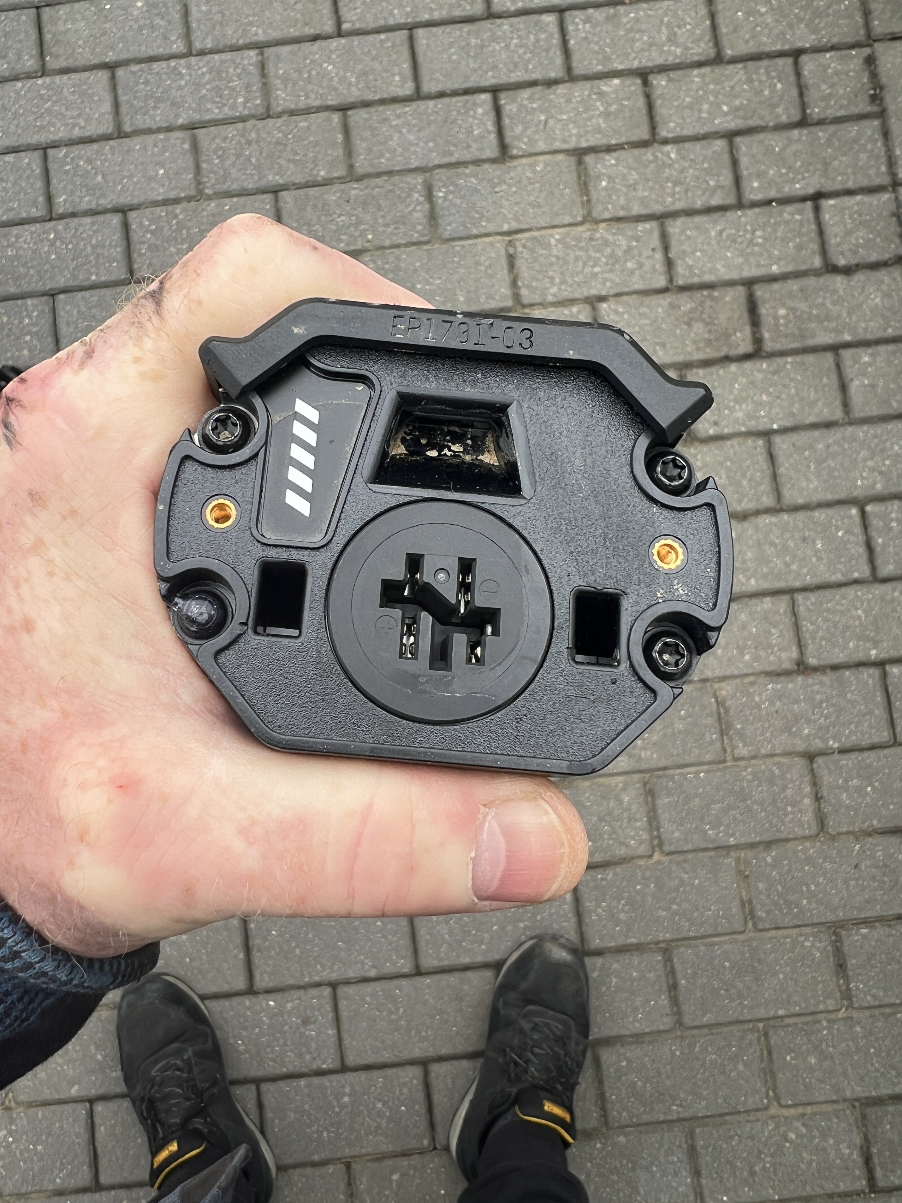

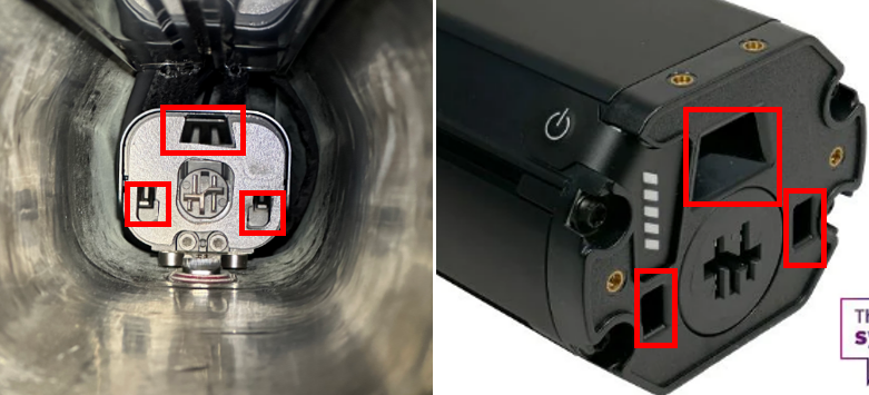

these features keeps it from moving side to side if inserted fully, i think:
your photo is quite informative. The holes surrounding the actual connector ( 2nd photo) are guide holes rather than designed to prevent movement and you first photo suggests it is only those holes and the latch that prevents the battery moving from side to side. I agree increasing the vertical pressure will help but both the latch and the guide lugs must be under significant pressure and neither are designed to deal with lateral loads. I would want some packing between the walls of the downtube and battery on 3 sides to prevent that loading. I think the thing to understand is that the latch works on a cammed lever system and it will only stay in the locked position if the battery does no move laterally. Happy for you that you are getting rides in with no problems at the moment but I would not bet on it lasting I'm afraid.

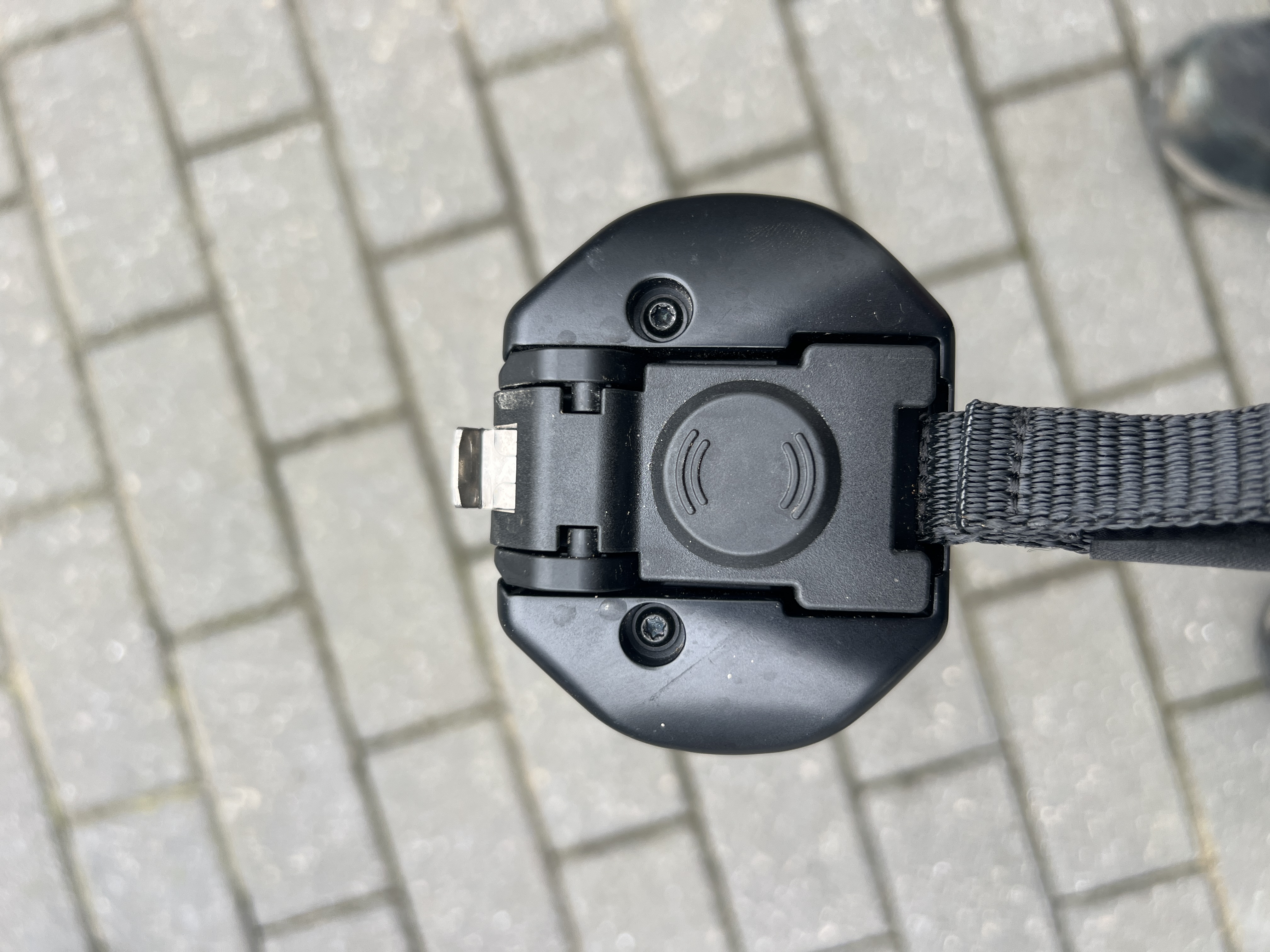

Mine Still looks good, So I just fitted thicker cable ties in. im off to bike park wales tomorrow, So Another serious test

i believe (and proven with my temp solution, for now at least ;)) that the issue is at the bottom of the battery, there are two issues according to me:
  • latch is not strong enough.
  • battery is not snug enough.
in my homble opinion, both would not be solved with rail from bosch.
The latch seems not strong enough. i guess the mistake Canyon made is to use the bosch latch. in this thread you can see Whyte keeps the battery in place with the battery cover.
the second (and biggest) mistake is that they accept the 'damage' because the issue is not (yet) on all bikes. probably a VP with an MBA, looking at numbers rather than an engineer wanting to solve the issue.
Anyway, Canyon sent me a new latch, i'll keep you posted if the design has changed.

Quick question for everyone - my bike is on the way 3-10 days... is it obvious where/how to attach the cable ties?
Would you ride it first and see how it goes or just put the in right away?
If right away: Perhaps a stupid question but do you need to remove the battery to make the "cable tie net" work?

cris cross, front two are obvious. rear are the motor mounts, the one side is fiddly, use decent ties, halfords not amazon...
Battery removal required??
Yes, Bike out the box, get the battery out, get it on charge. Build ur bike, you will need battery ouit to be able to loop your cable ties through the steel hanger at front, motor mounts at rear.
