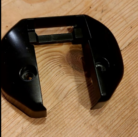

this is what i recieved, only the cover, not the latch itself:
My expirience with Canyon service Belgium has been exellent up to now. I assume that above shipping went wrong in Germany, where it was shipped from. Anyway quit annoying. luckely my temp solution still works.
Glad your service support works properly, I've sent a service request almost 2 weeks ago, still nothing back from canyon, I did get a feedback request survey email for such service ticket, of course I've valued as 0 stars....I'm never buying a canyon again
Jonas, the cover won't do anything.
Use all solutions you can, otherwise, bike will be stopped due to this latch design flop!
I'm sorry i was not clear. i'm aware that what I received is not what i need. this cover is the only part i did not need to replace . What i wanted to say is that i don't think the error of this wrong shipping is caused by Belgian service center but at Canyon shipping/warehouse at gemany.

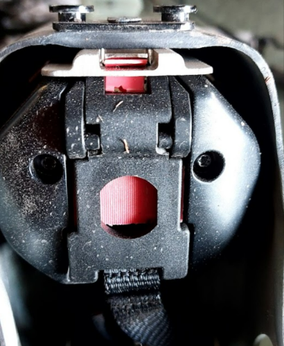

FYI, to fix it temporary, I did these updates:
  1. add plastic under the pastic latch (repair the issue if broken lips)
  2. add a thin plastic part under the metal hook (avoiding play, in general)

this is the reply (translated with google)
We are still working on a definitive solution, but because Bosch cannot offer a definitive solution in the short term, our own Canyon engineers have also started developing an adjustment. But this will also take some time.
That is why we will send you a new part with a temporary solution, which according to our initial tests is very reliable. This part will be shipped via UPS,

I fitted the 'fix' that Tobias over on the EMTB Facebook page has developed. Very easy fix and I can see what the additional 3D printed part offers. Fingers crossed it offers enough of a fix (as well as the Zip ties) until the official Canyon and Bosch remedy is released.
I have also installed the Tobias latch plate but I'm not using zip ties or any other method of securing the battery.
Hopefully it will last until the mysterious Canyon solution is revealed.
I’ve also gone the non zip tie route and hope it’s sufficient with Tobias’s fix.
Out of interest, do you have any pics and what does the "fix" appear to achieve? Does it just better spread the weight of the battery across the latch or something?

I also fitted Tobias’ latch fix. The latch still seems fairly easy to be opened, i.e. the slightest touch on the nylon cord opens the latch completely. Is this normal ?
Hi guys. I took delivery of my StriveOn this week and have been slowly preparing it ready for the trails.
Try it without the fix…
