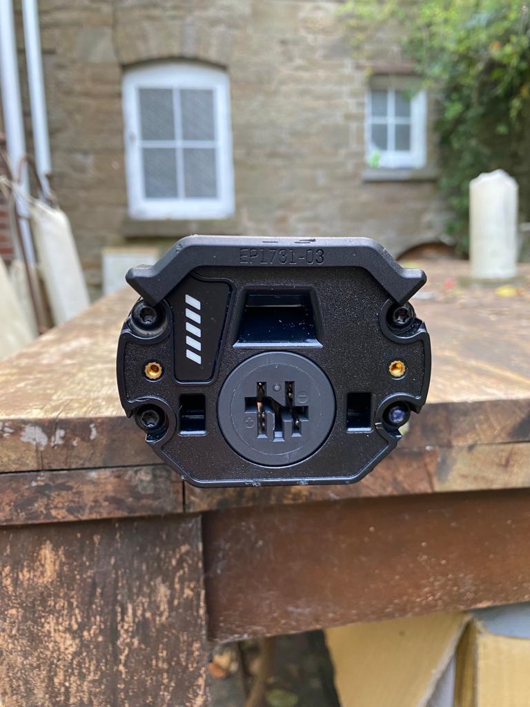

I think it is still possible that the issues is a the bottom.
if there is not enough force at the bottom to keep the battery in its place at the connector it will cause bad connection.
in your case , it seems like the battery was so low, the connectors pins were not inside the female side of the battery and made the damage to the plastic.
connector is probably suppose to be inserted 4-5mm, so this means the battery was too low for 4-5 mm.

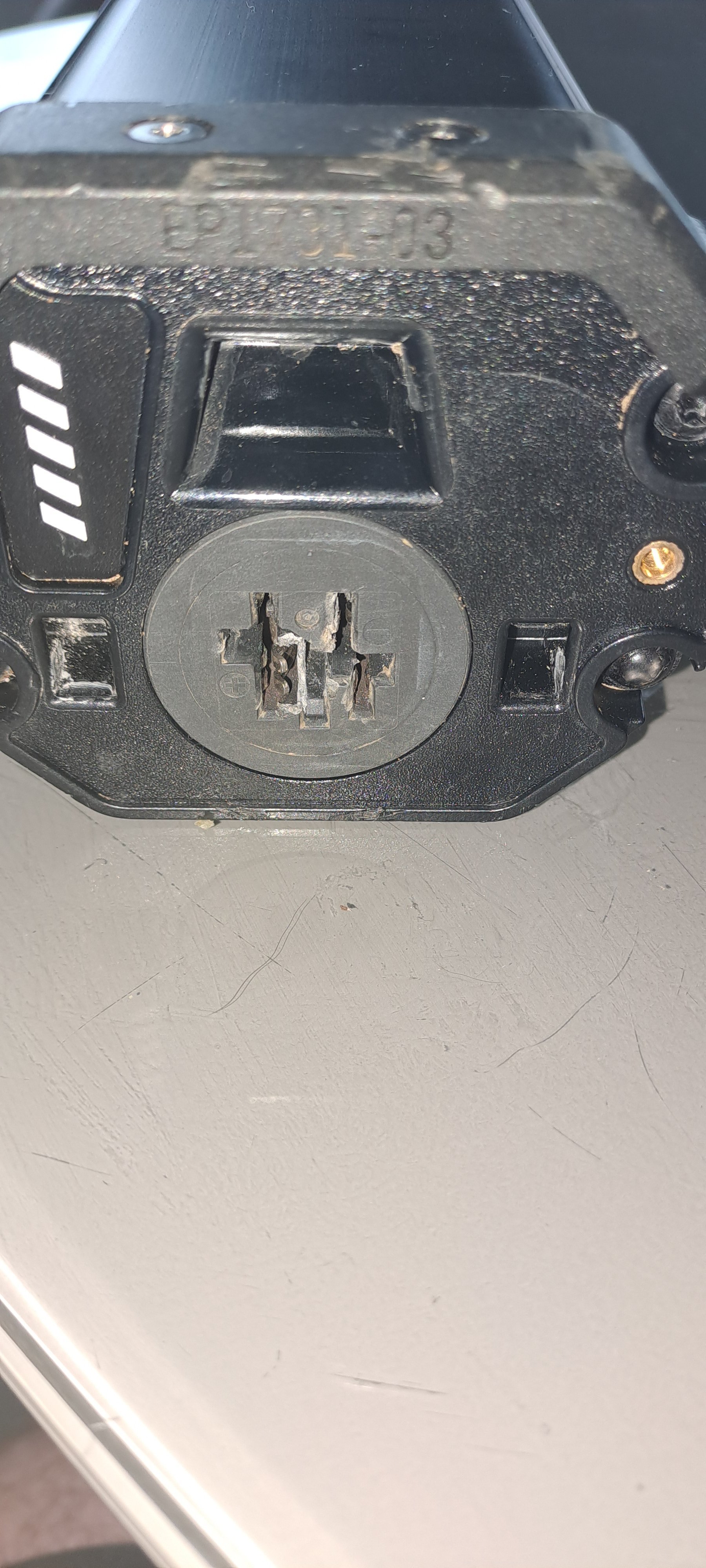

So this happened to my battery today after multiple shutdowns....
Errrr...this is mine just now after 84 miles...!!!

I'll add that I always charge my battery on the bike and being aware of the latch issues I've tried to be very careful on the 2 or 3 times I've removed it...Canyon have already admitted they are aware of the latch problems and have sent me a new latch...it wasn't until I took out the battery to investigate that I noticed the damage to the female receiver on the battery itself....I'm raging!!!

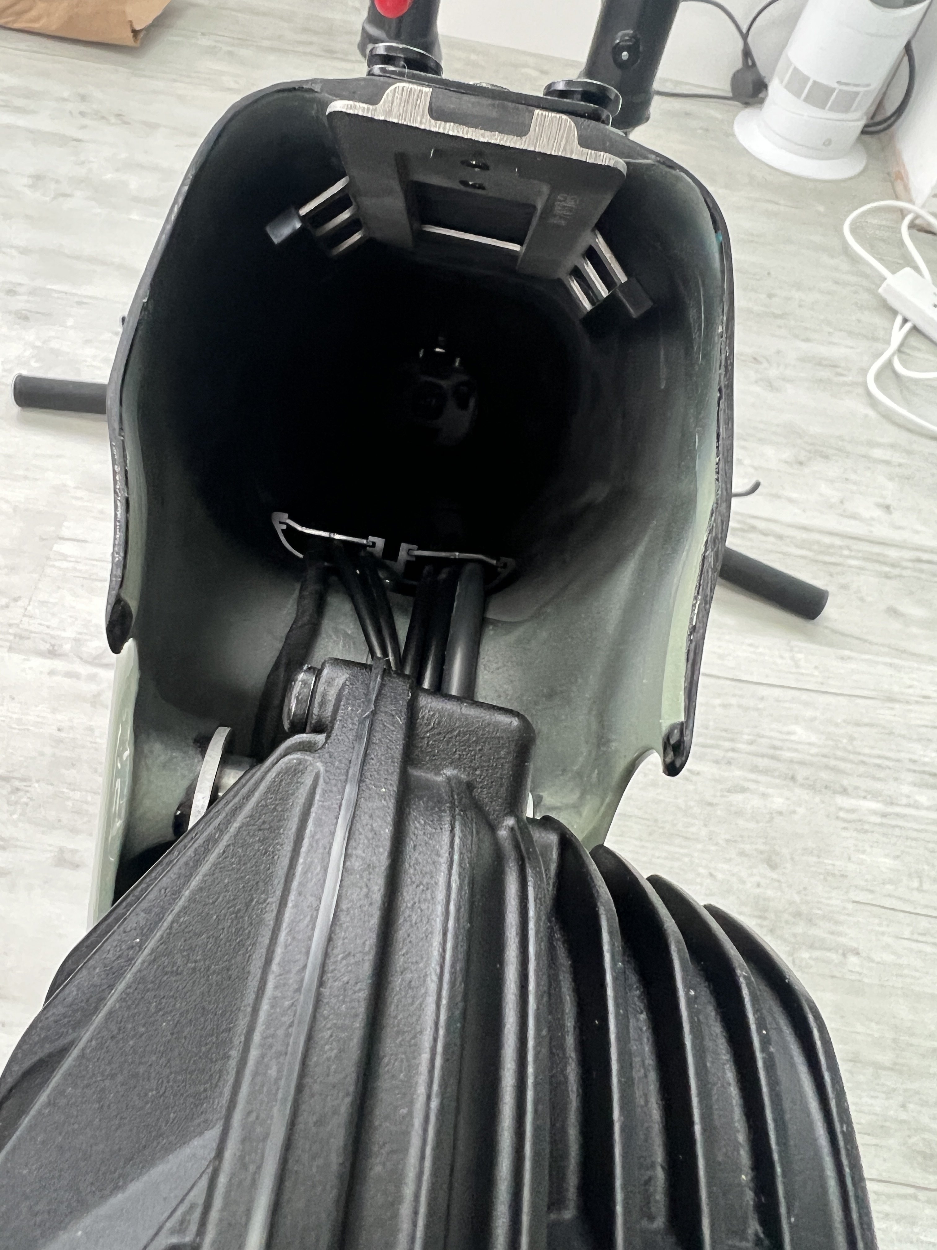

Well ill be looking at mine before i use it. ill post some pictures of it in hear, see if they've done anything different to it.
There are two bolts at the very top after you take the battery out. Mine were fine, but there's a photo in this thread where they looked half out.

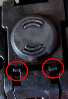

is the latch still ok, or also already broken again (small lips)?

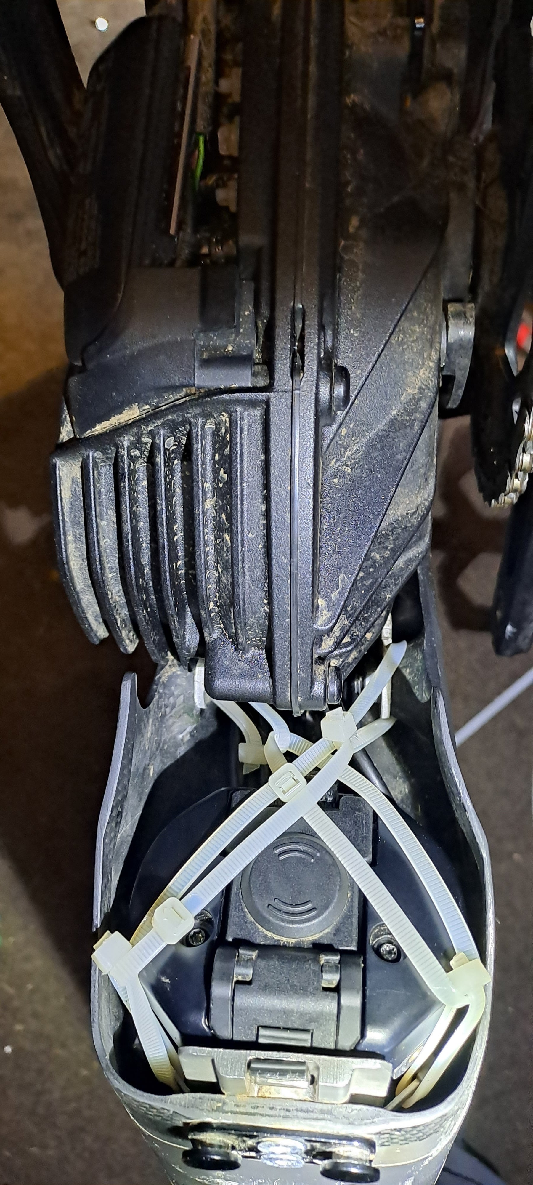

I shouldn't have to do this but I now have a non removable battery that is secure...for now. I know it looks crap but the battery shouldn't move around until I get a reply from Canyon...shocking that on a "high end" EMTB that I had to resort to this to be able to ride it...

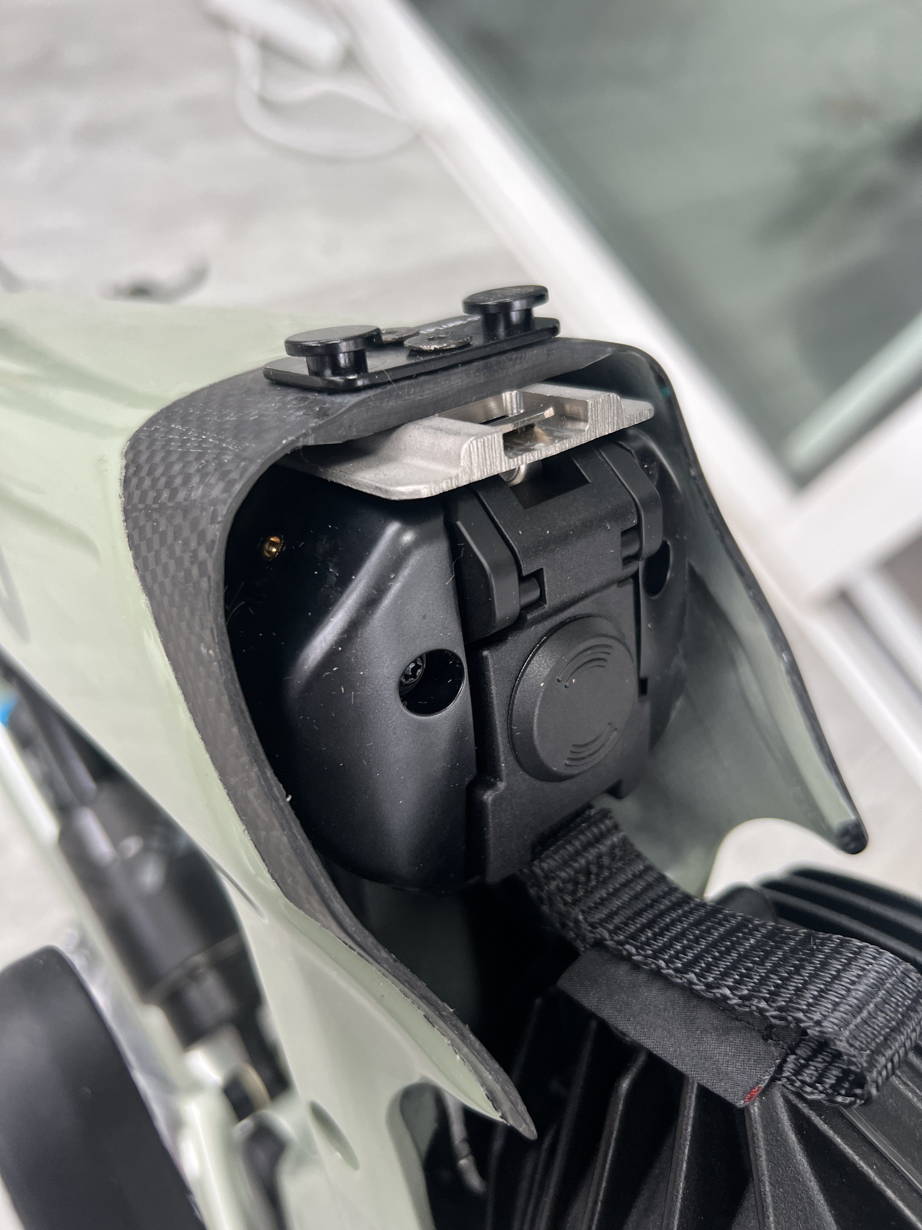

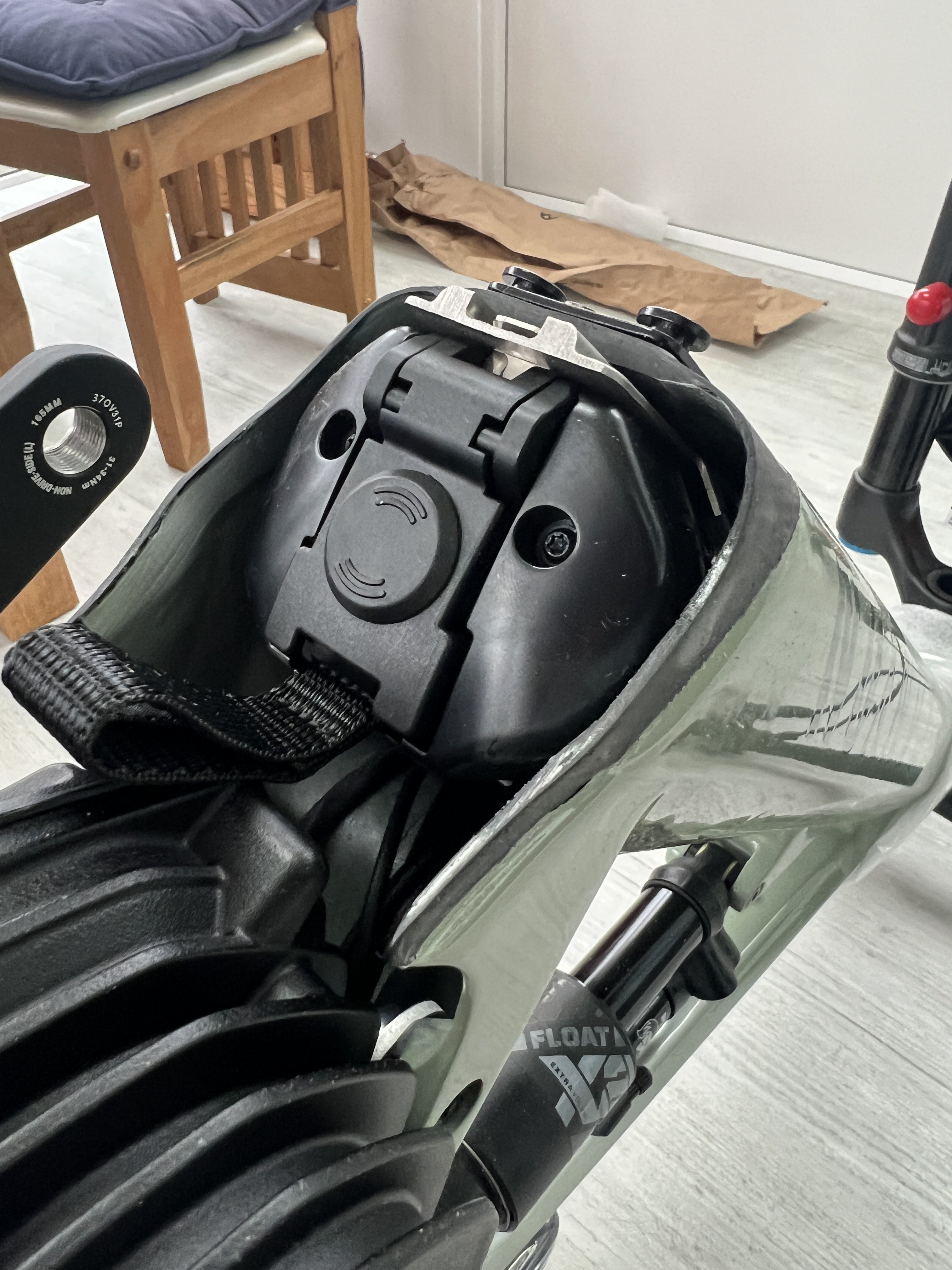

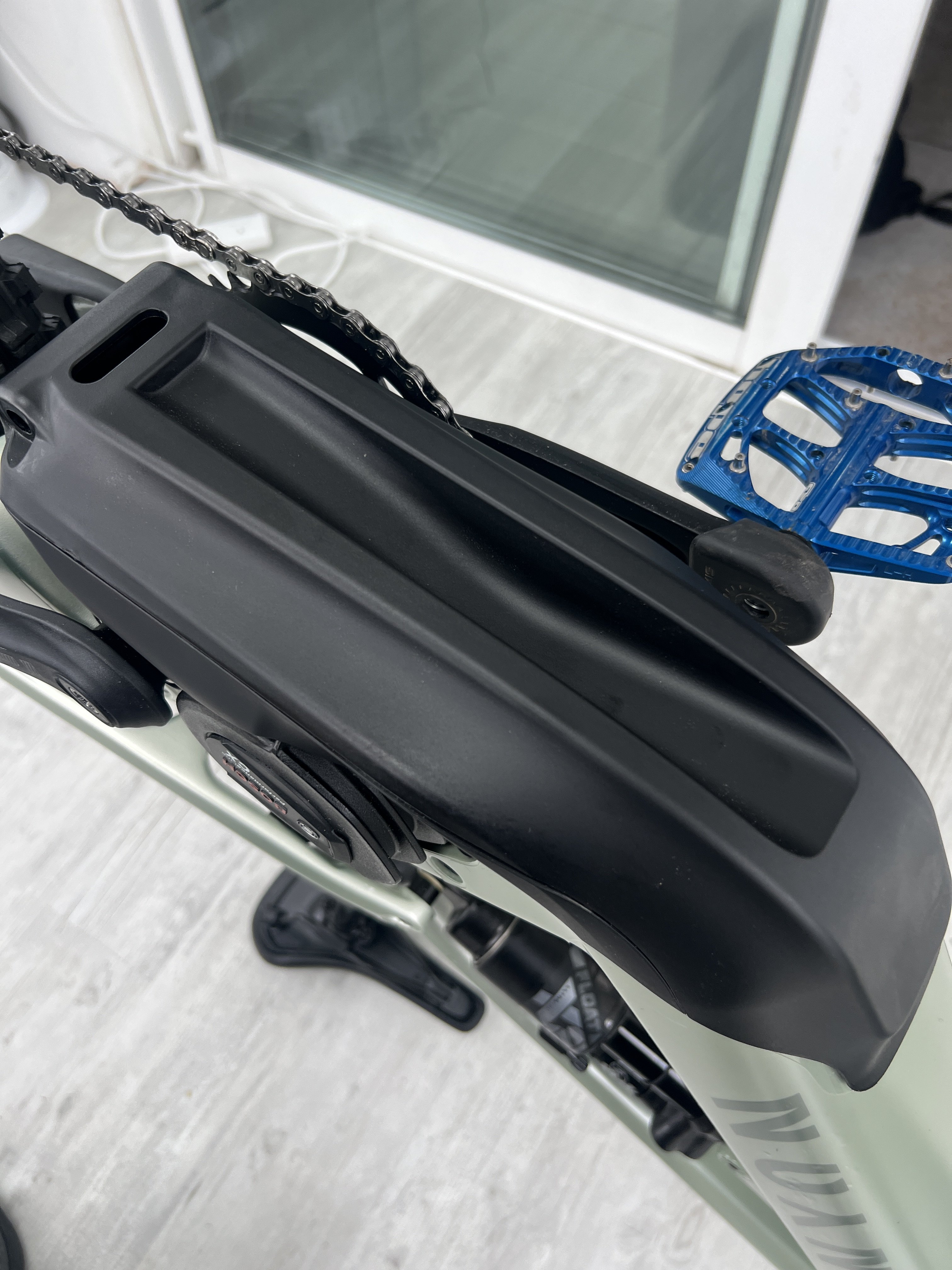

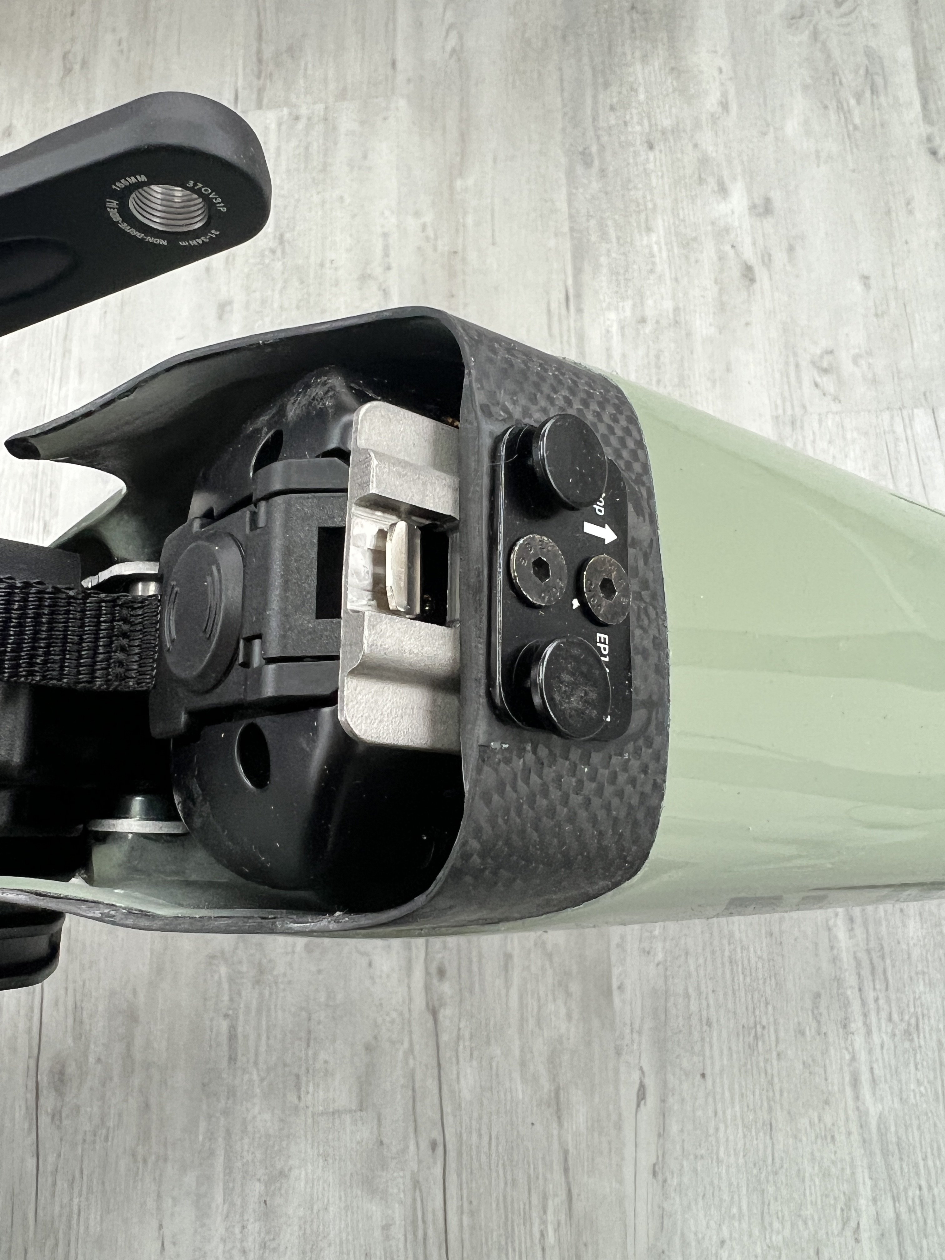

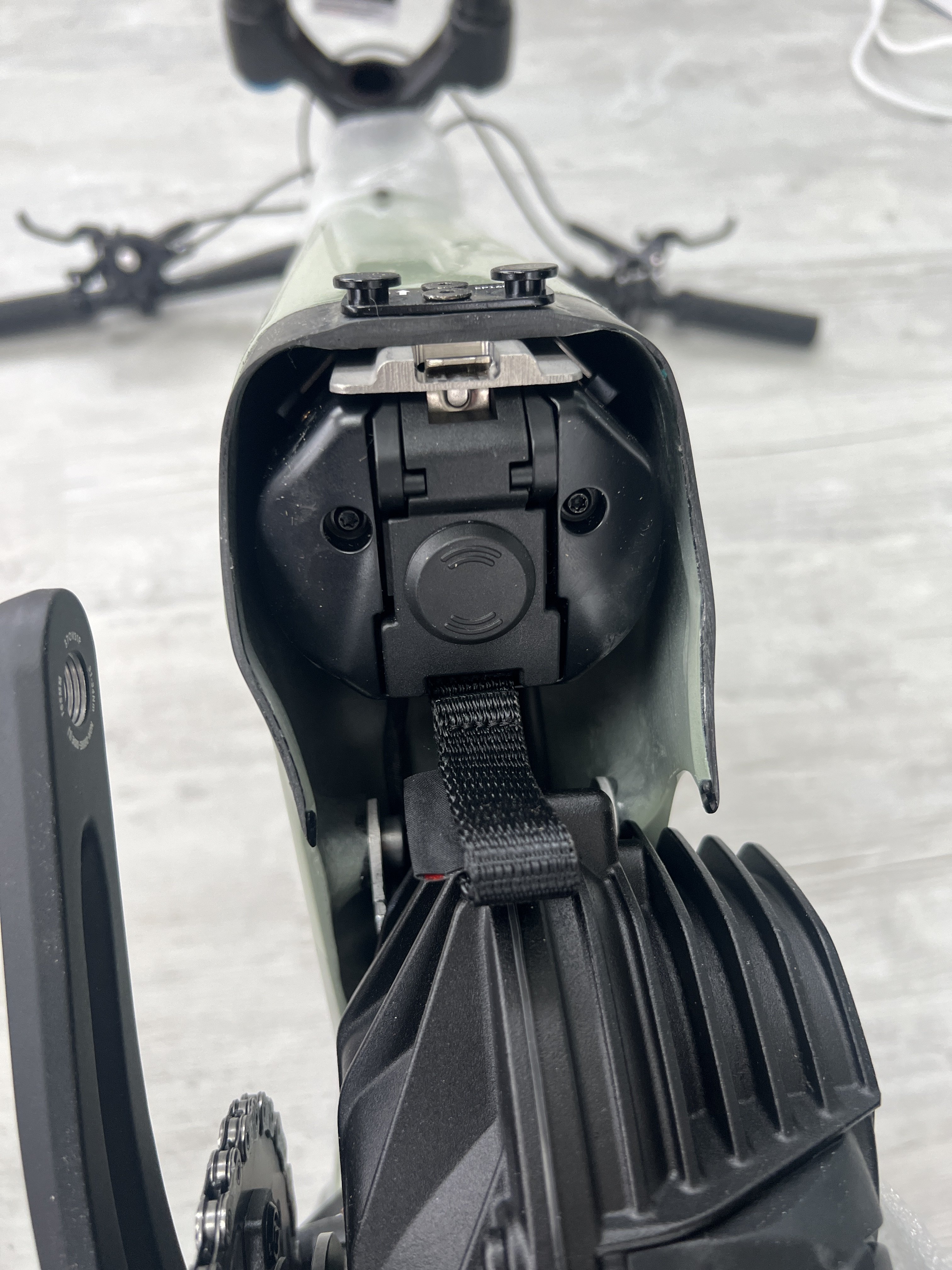

So bike has landed, This is how the battery was held. is this different to, or the same as the bikes that have been failing ?

Ideally a full metal clip system or some better way of securing the weight of the battery by replacing the Canyon bottom battery bracket part.
They could make this guard deeper, fixed at the front better too. that would hold it up
