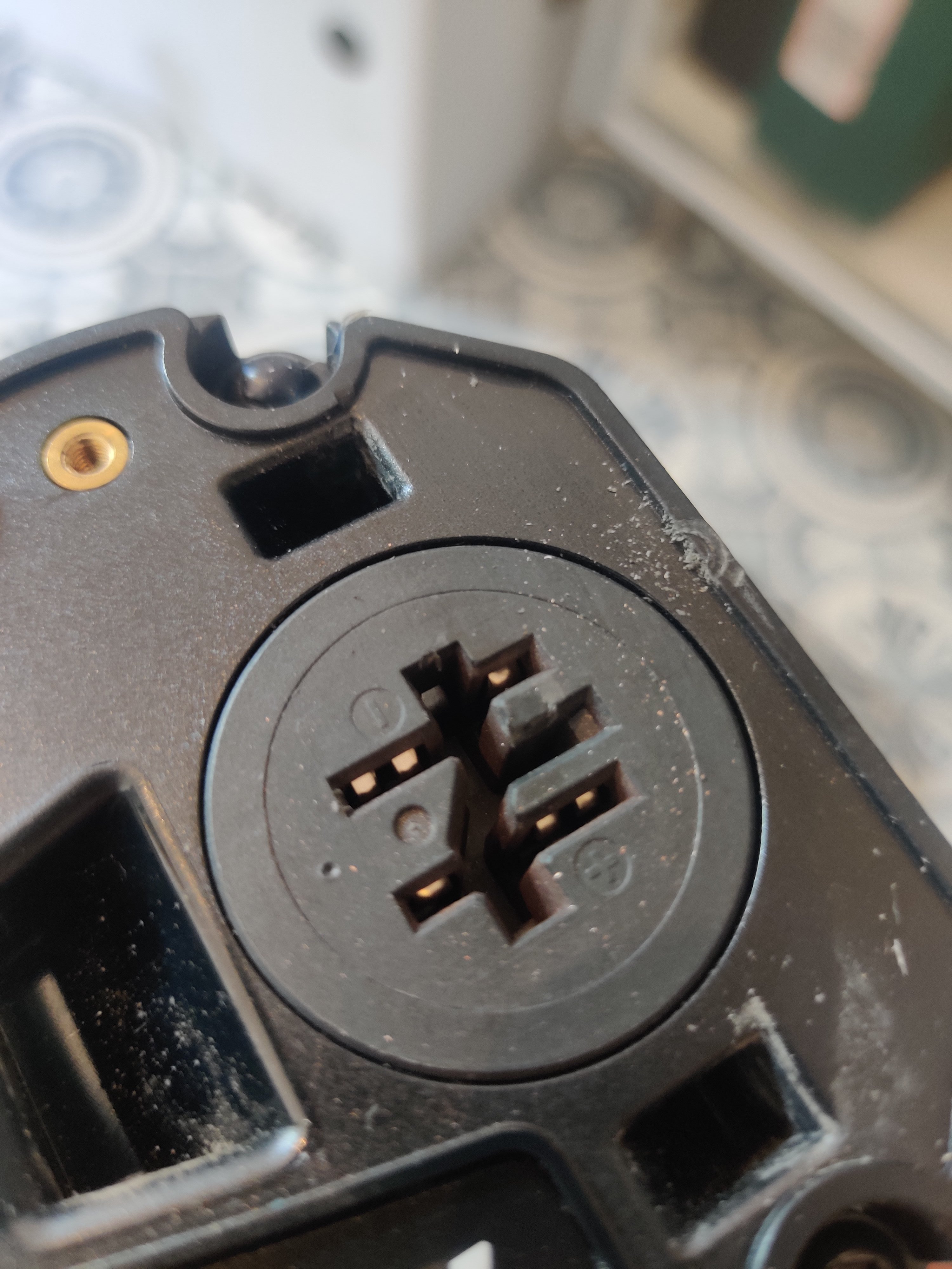

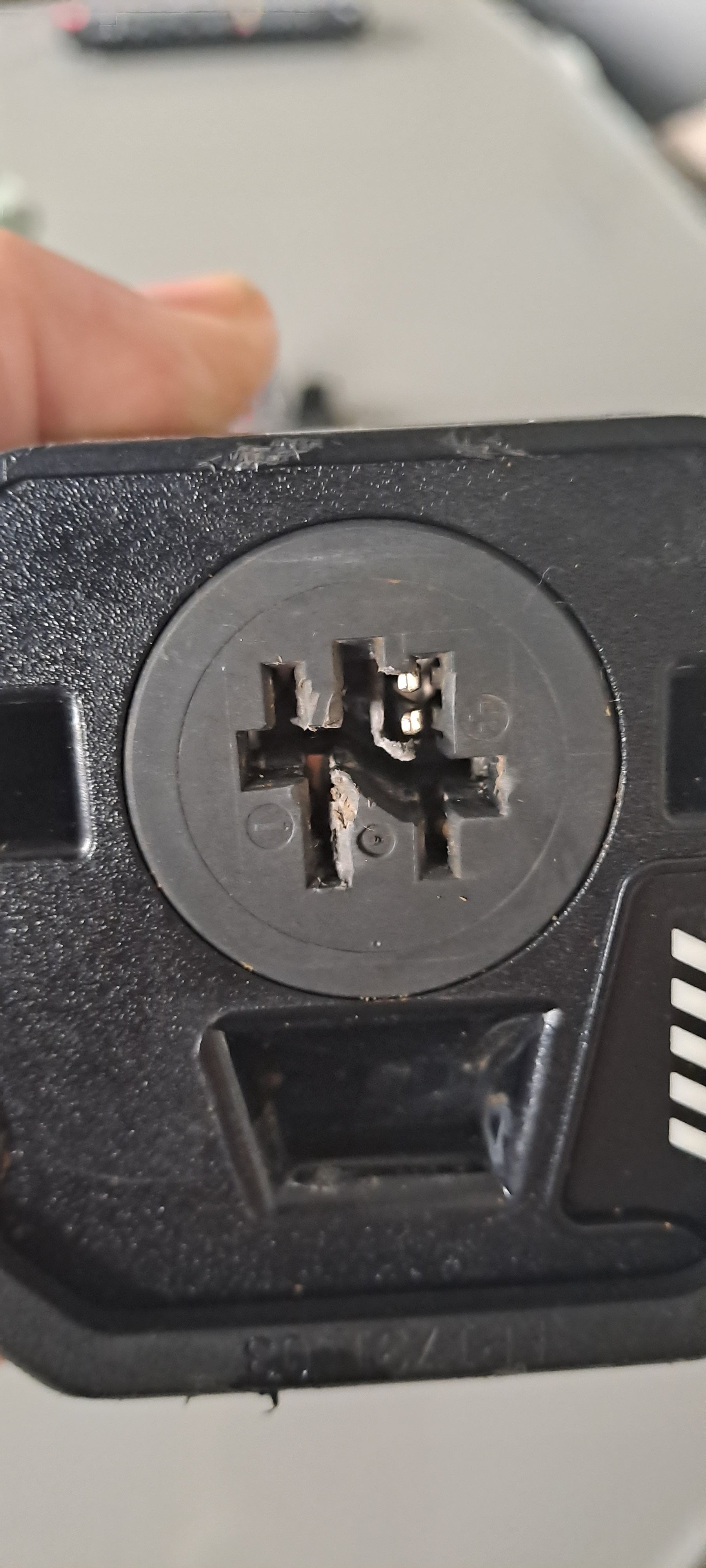

I've also noticed quite a bit of damage to the connector pins, I don't know what to do, I'm not sure to raise another warranty claim, as I don't trust anymore the canyon techs, or just order one with my own money, I think tomorrow I'll visit my friend, who is a Bosch certified tech and it's the only bike mechanic I trust, and see what he thinks
View attachment 125137 View attachment 125138 View attachment 125139 View attachment 125140 View attachment 125141
That's quite some scoring given the bike must still be relatively new!!
The bike has now 740km, latch was replaced by Canyon with 520km, more than scoring, I would say it's fretting, anyway, obviously it's damaged to an unacceptable condition

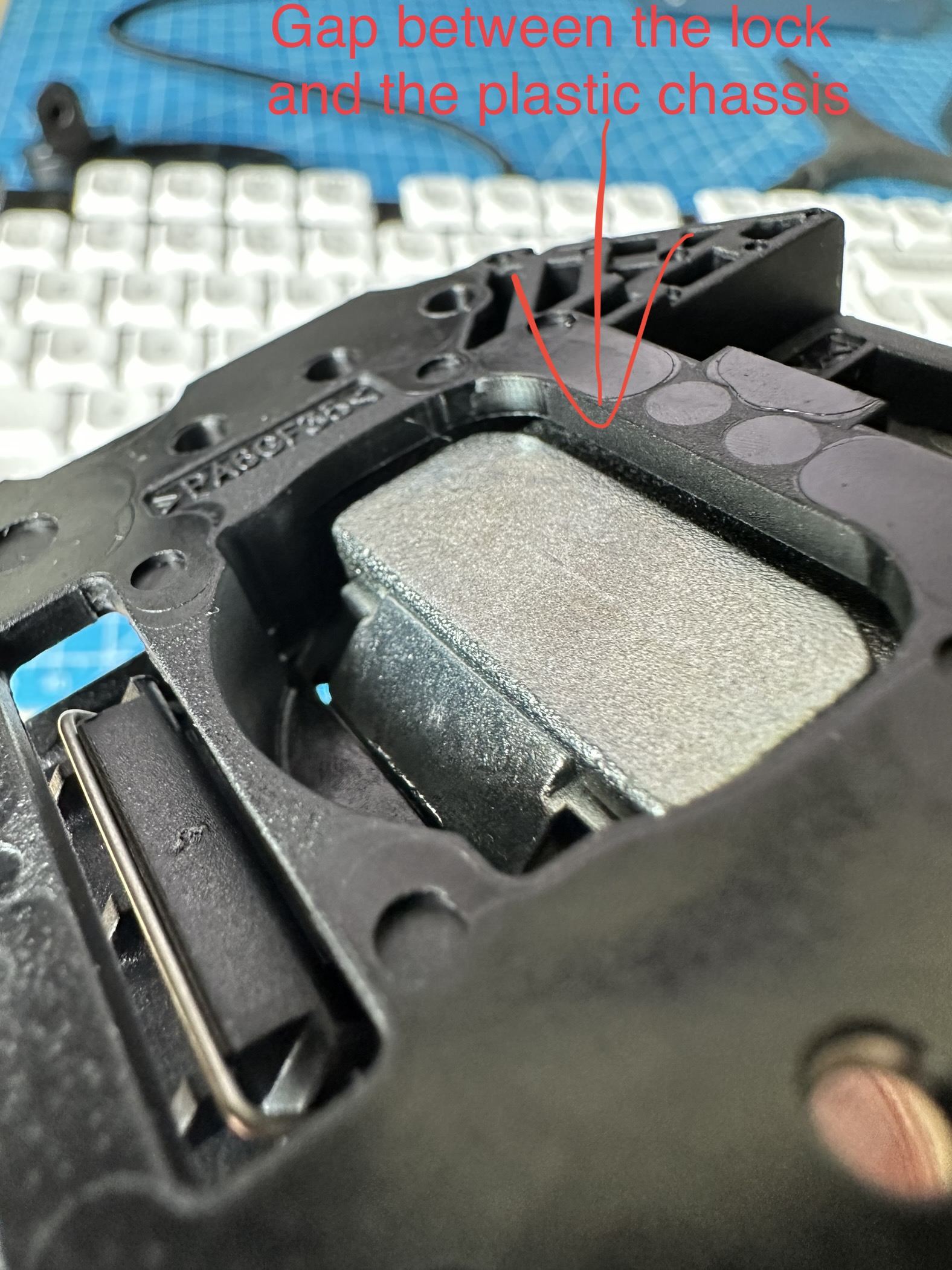

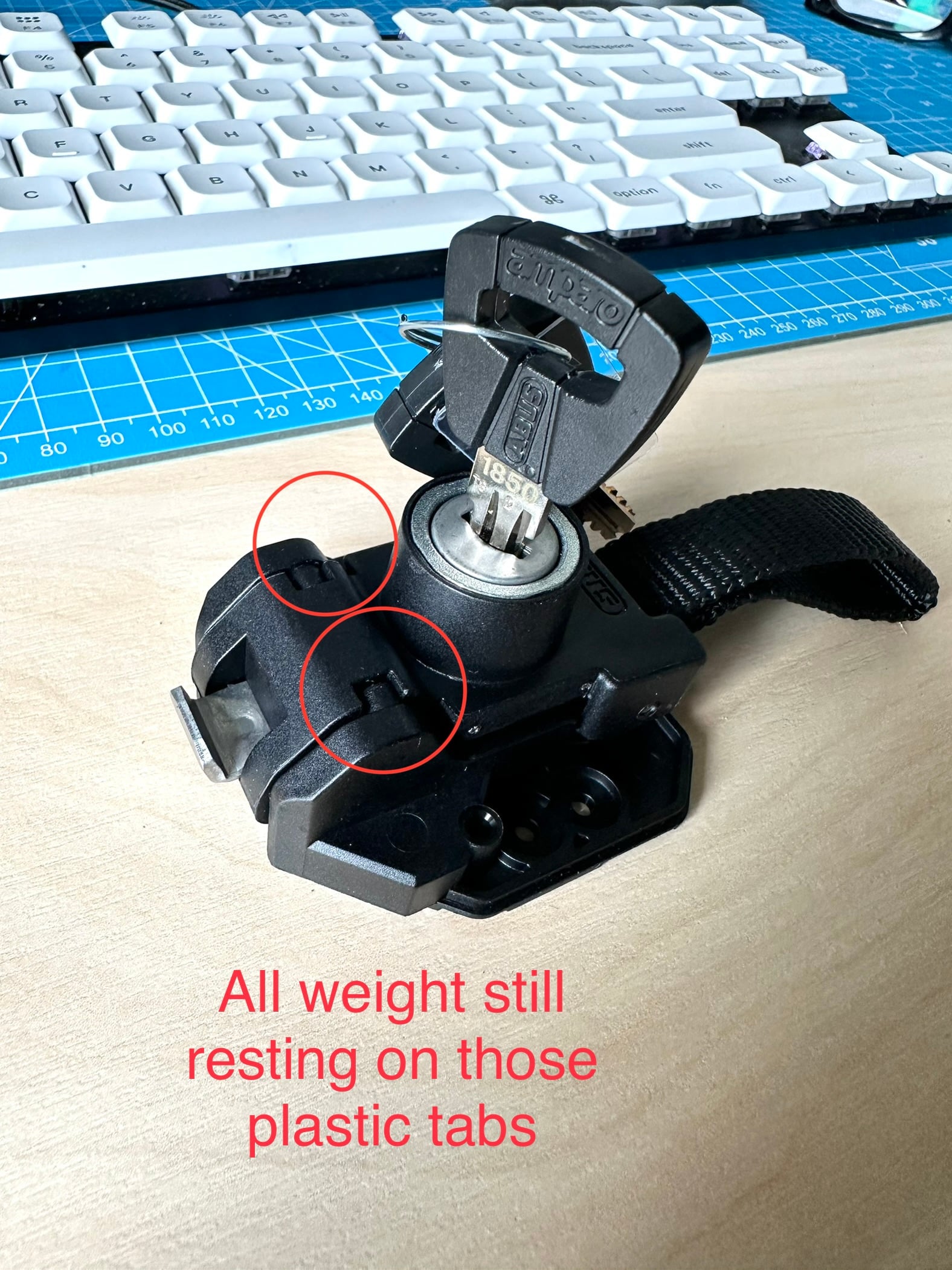

I just received the latch with the Abus lock, and it doesn't seem to be much stronger than the stock Bosch latch.
The lock does not add any additional support, in my opinion.
I was hoping some part of the weight would be resting on the lock itself, as it's placed centrally in the mechanism, but unfortunately, there is still a gap so that the whole weight of the battery is still resting on the little tabs that are getting broken.

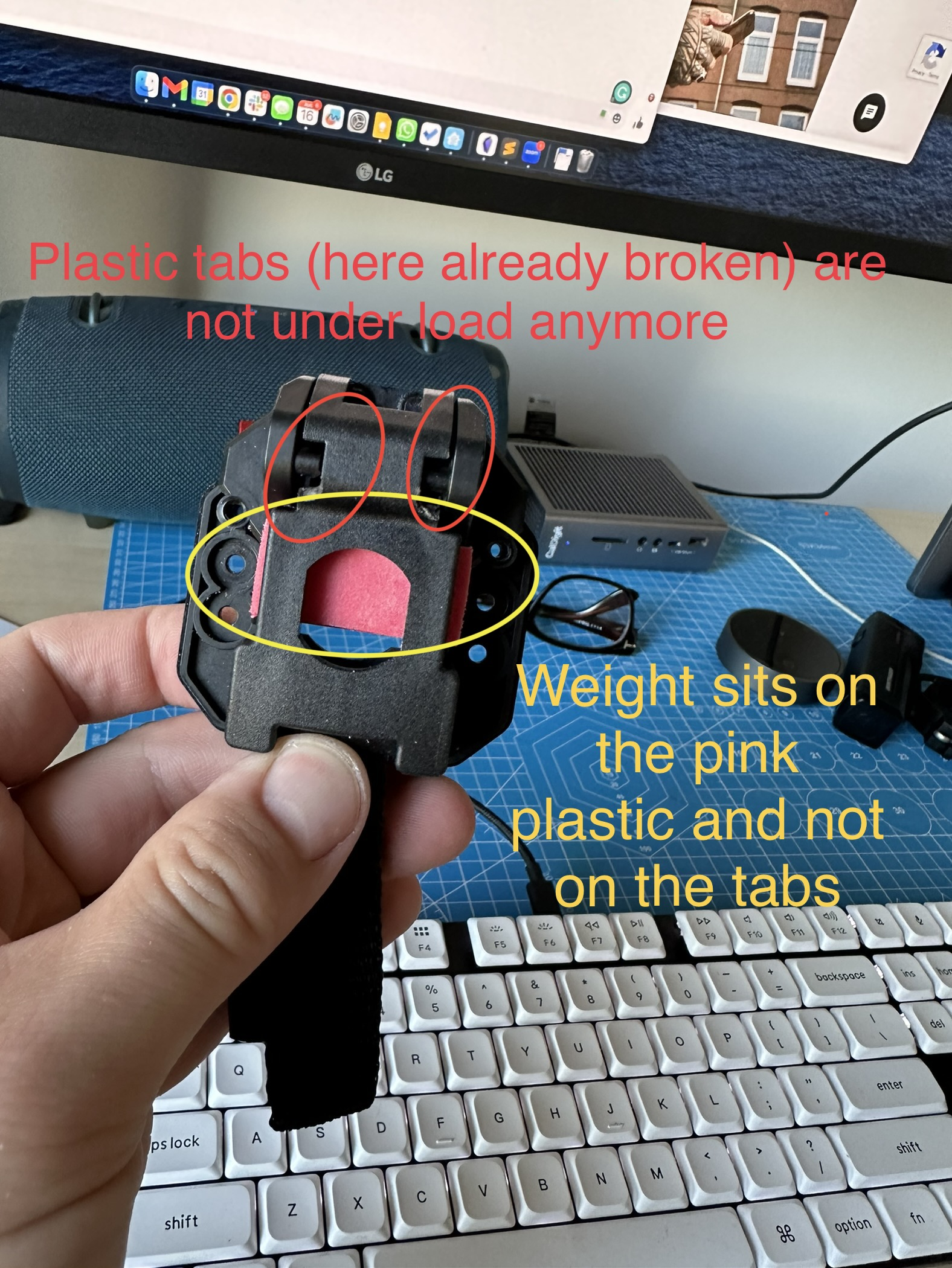

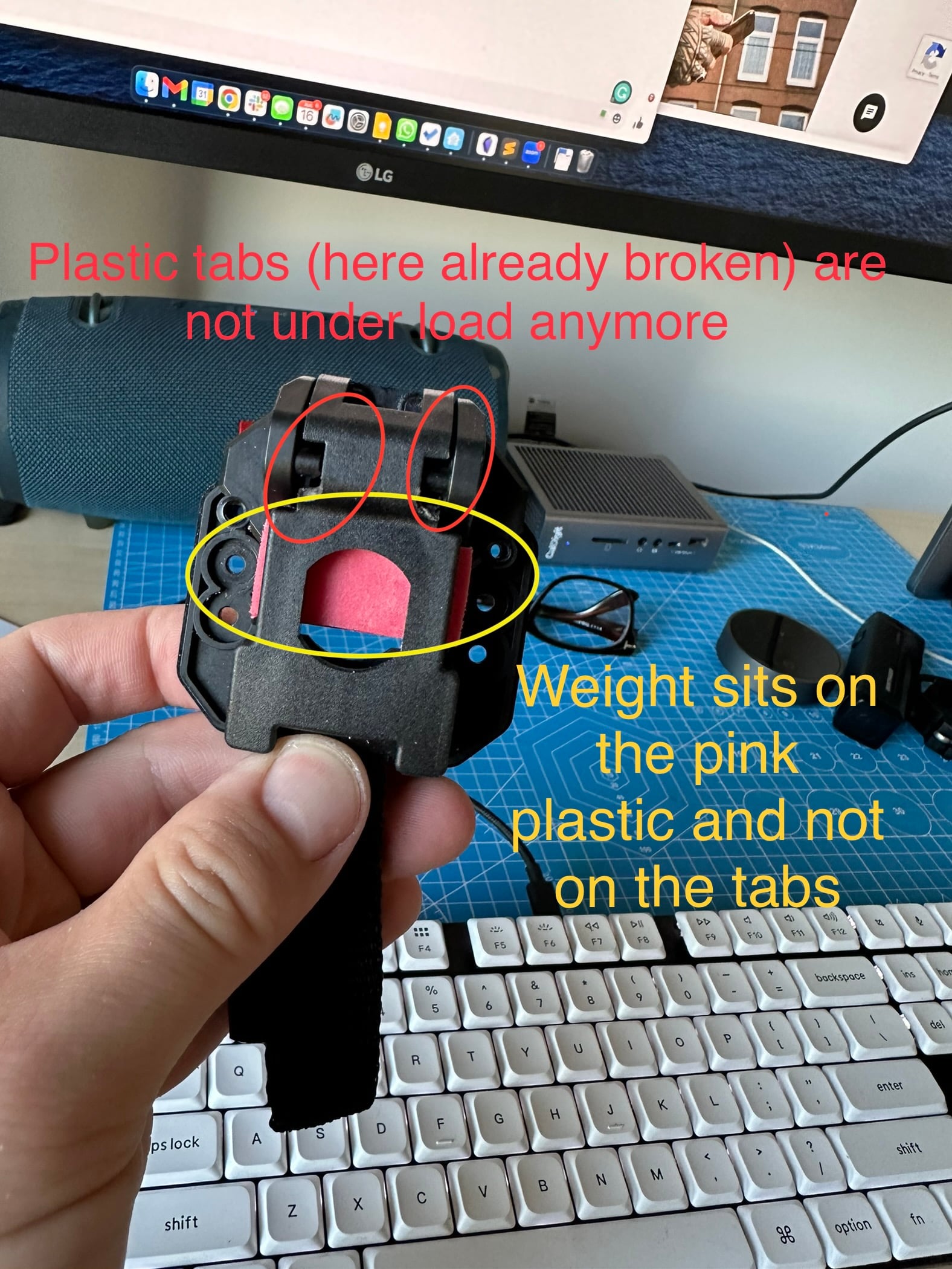

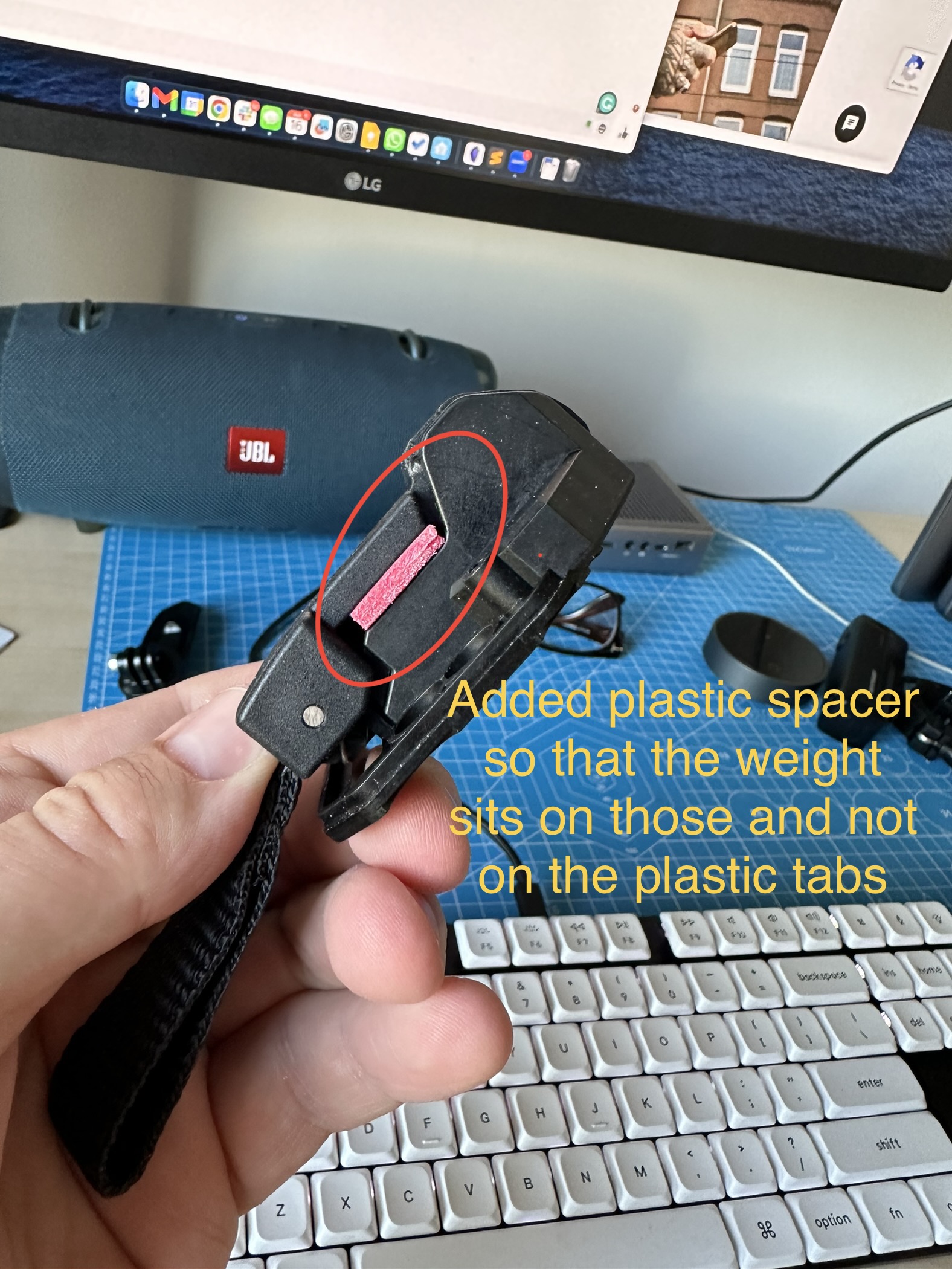

Now I'm testing a different solution
I've added a little plastic spacer that would take some weight off the little tabs and hopefully make the whole thing stronger.
Below are some photos of the spacer with an already broken latch that I used for a test fit.
The spacer is made out of plastic (the pink part), and it's around 2.9mm thick. It allows the latch to close easily, and it provides additional support for the mechanism so that the weight of the battery is not sitting anymore on the plastic tabs.
Basically, the idea is to take the weight off the weak part (fragile plastic tabs) and spread it over the stronger part of the mechanism.
I will be testing this for the next few weeks and will report back.
In the meantime, maybe that would be helpful for someone who's already experiencing the same issues.
Cheers!
does this spacer work? i also believe that should help/solve it. i will try as well

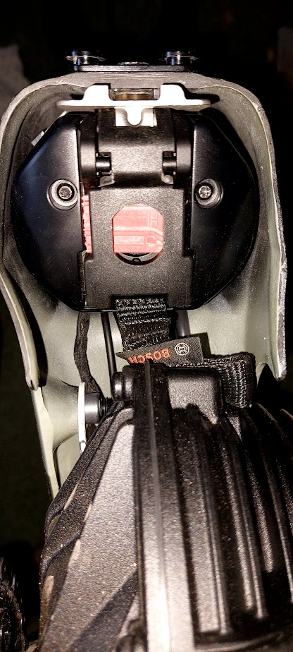

God that's rubbish, sorry to hear that! I took the battery out when mine arrived and the plastic piece that guides it into place - ie: grips the rails - was loose. But all else seems ok. I'm guessing you have a 750wh?
yes 750Wh
What's the red bit under the latch mechanism?
some plastic part i found in my garage that seems to have a correct thickness to fit under the latch. i hope is will keep the batttery better in place. i'm not the first with that idea, see earlier posts

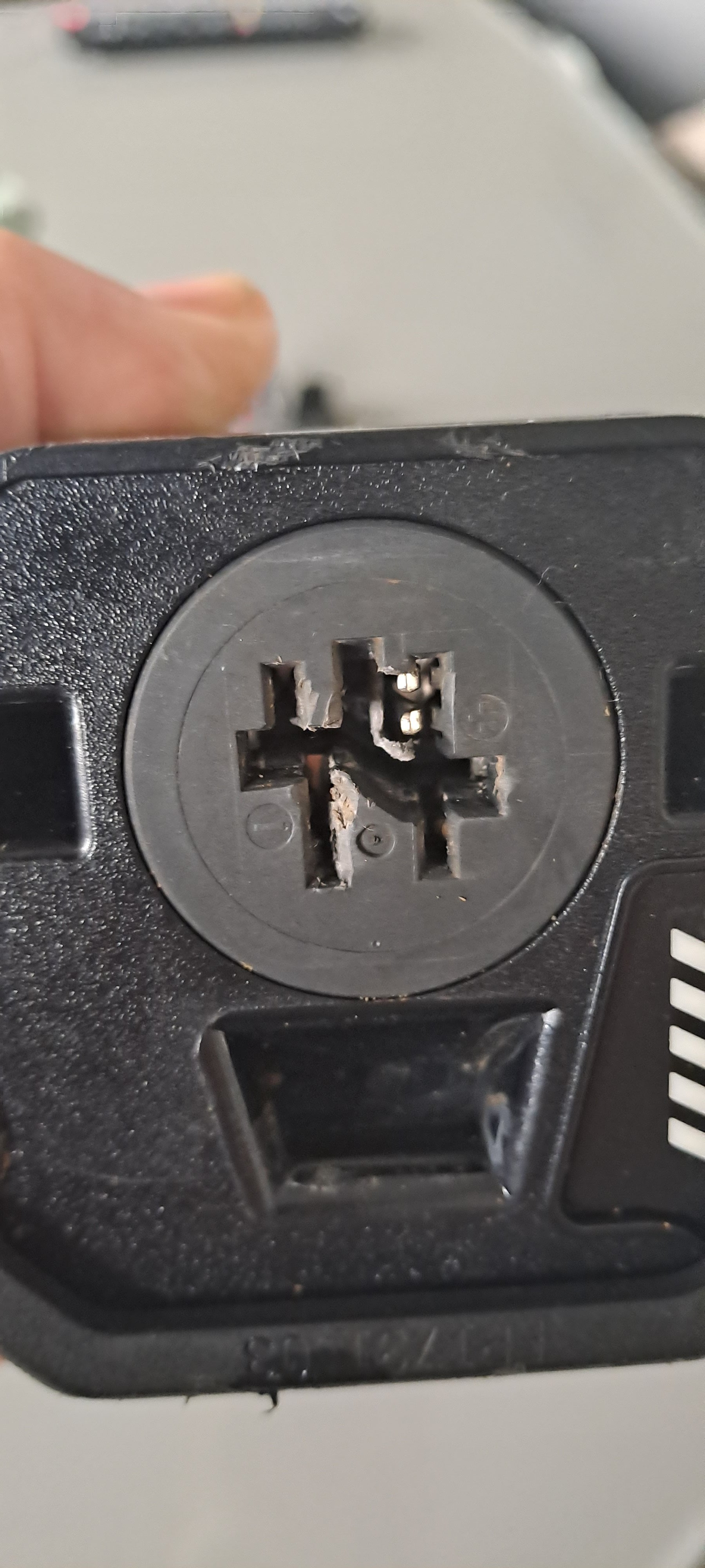

So this happened to my battery today after multiple shutdowns....
