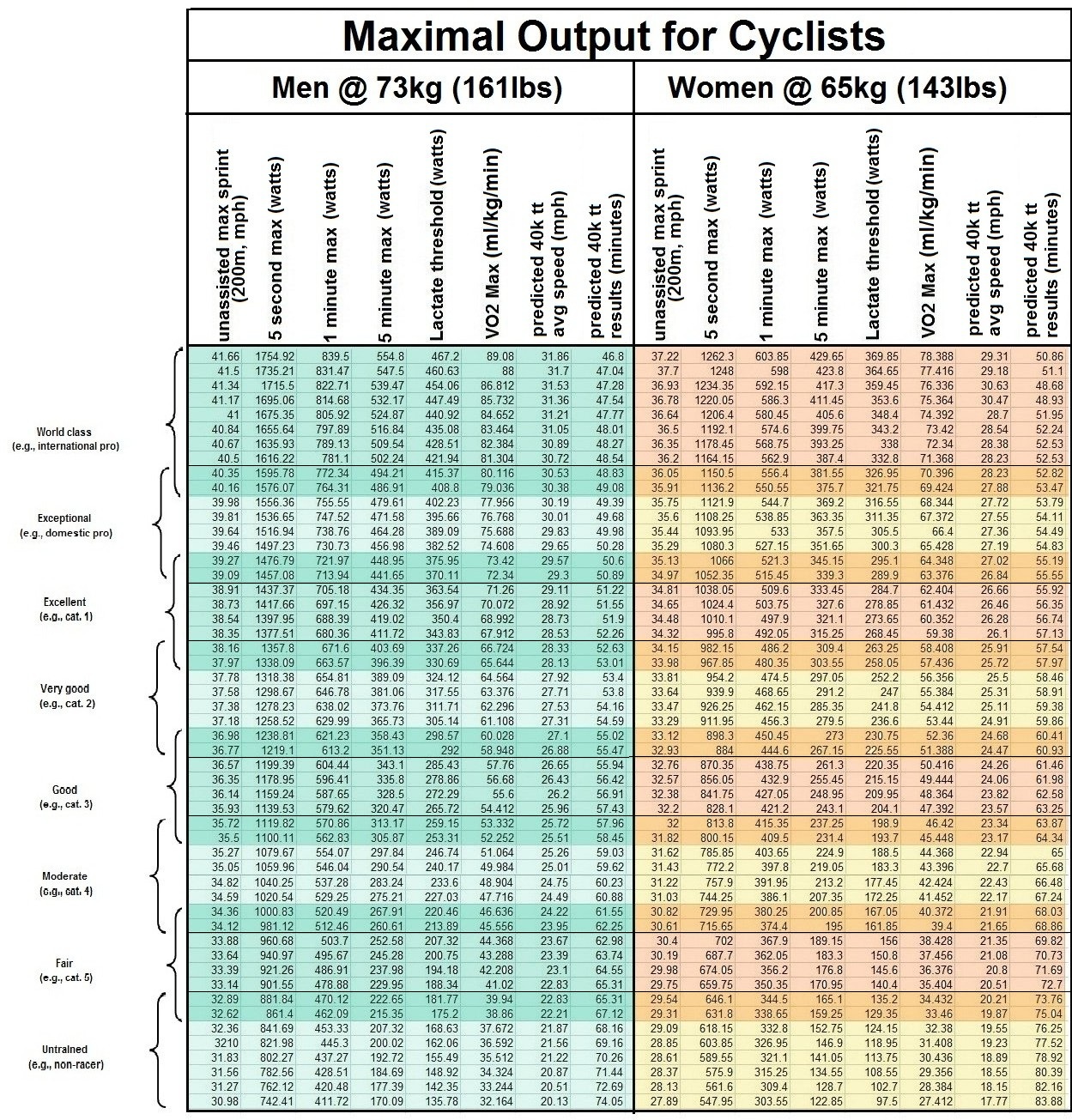

@Matt b this is how I think it works, but someone can correct me! This other post gives useful info Mission Control iOS App 1.2.0 featuring Infinite Tune - Now Available - EMTB Forums
At 100 assistance support the Levo provides 320% of the rider power, and at 100 peak power up to the maximum of the motor power (let's assume that is 500 watts as mentioned in the post I linked).
If at the bottom of the hill you are pedalling at say 300 watts, then the motor power will be maxed at 500 watts giving a total of 800 watts.
If at the top of the hill you are tired and pedalling at 200 watts, then the motor power will still be maxed at 500 watts giving a total of 700 watts.
But if you were even more tired at the top and pedalling at 100 watts, then the motor would only be giving 3.2 times that = 320 watts, reduced from the maximum possible, and giving a total of 420 watts.
So it does depend on what power the rider can provide relative to what the actual power output of the motor is. I don't know if Mission Control can display those actual values? But I've seen that the BLEVO app can display them. So it might be useful to do a test and see what actual values you experience yourself.
I found a chart here which shows comparative power of different cyclists My World From a Bicycle: Comparative Measurements of Maximal Outputs for Cyclists
Note that to sustain even 200 watts you will have to be fairly fit!
Thanks, it does seem that if your legs start going you're not going to get full power to help..which seems a shame.

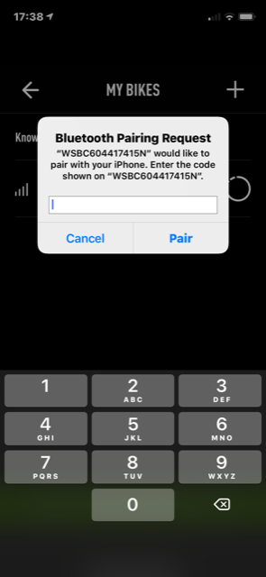

Just got my 2019 Turbo Levo. The old Mission Control cannot find my bike. The V2 Mission Control does find my bike, but I cannot connect. It seems to initiate a bluetooth pairing request and asks for a code (this is on an iPhone), but if I press the Home button to check the bluetooth settings, the pairing request is cancelled!
Am I doing something wrong?
Put in the code on the sticker on the side of the bike.
Thanks Rob, but no joy. I presume you mean the sticker underneath on the downtube. The number on there is the bike ID, plus STFZ218F0552, but the keyboard for typing in the code doesn't allow entry of letters, only numbers - WTF!!!
No, there should be a massive yellow sticker on the side of the bike. That has the pin code on it. Where is the bike from?
There was no yellow sticker. Bike is from Bike Scene, Guisborough - a Specialized dealer.
It really does seem to be asking for a bluetooth pairaing code - see pic
