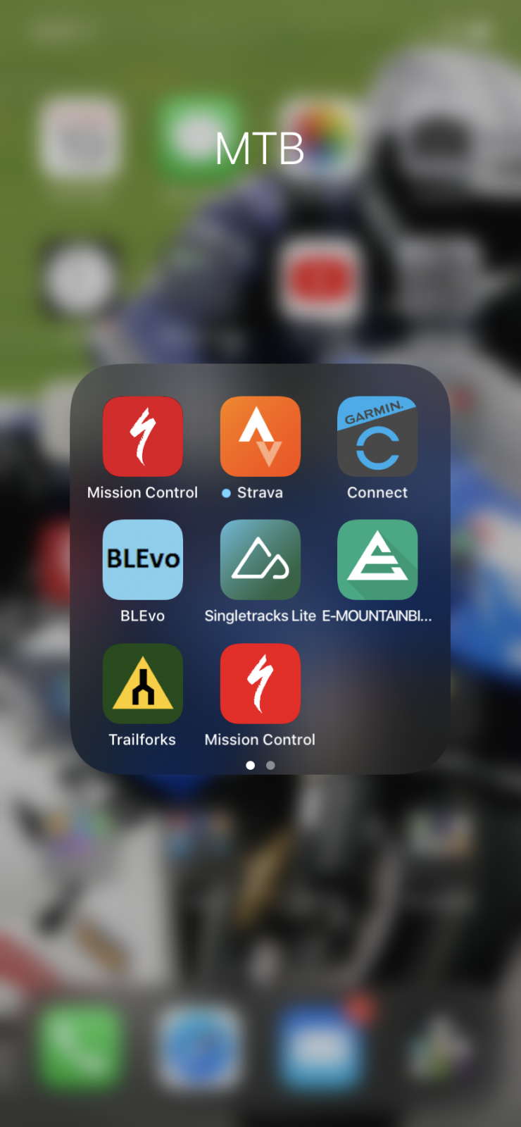

If you still have the original app you can keep it, I have both on my phone. if you back up your phone it will install it onto your new phone when the time comes to upgrade. I found the ability to see what the charge is at when charging was very useful so I didn’t charge more than I needed.
I obviously don’t have the old version anymore and I can’t install it from App Store on my iPhone.
I just need to be able to have the correct wheel circumference in my bike settings, corresponding to my ORIGINAL FACTORY wheels and tires, 27.5 x 3.0! @Specialized Rider Care please enlighten me, I paid a lot of money for this bike, this is absolutely ridiculous not to be able to use it correctly!

@Specialized Rider Care Thank you. I managed to download and install the older Mission Control app on my other Android phone, and I was able to set the correct circumference. It’s then read correctly by the new MC app too.

just use the old app for the wheel circ and the new app fir everything else.
