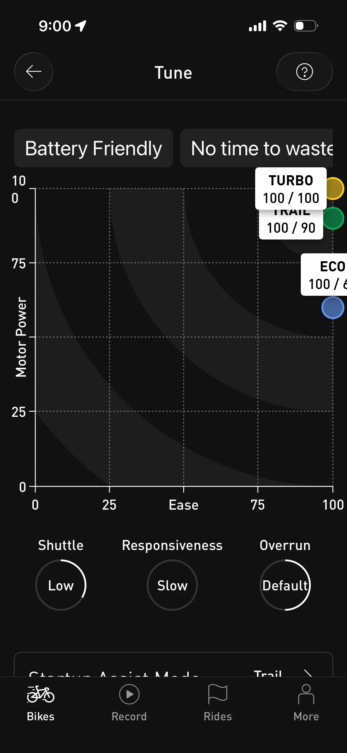

For aggressive riders there is a major flaw. I have looped out dangerously twice over the past 12 days narrowly avoiding serious injury. Understand, I have never looped out on these two 4-5' steep up sections for over 30 years. I was completely taken by surprise and didn't understand what was going on the first time, but after the exact same scenario the second time yesterday I knew it was not me but the new software.
Before the OTA update I could always count on Turbo 100/100 getting me up these sections easily. After update there is a night and day change. Here's what happened: When approaching steep ups, the technique is to accelerate rapidly, in Turbo 100/100, in gear 3 (third easiest gear), spinning up the lower half. Then, as RPMs slow w/ the grade, you can just make it all the way up in Turbo 100/100 as long as you keep the pedals turning, no matter how slowly. But just as robikinkela described a few posts up on this page, after updating you suddenly hit a "power wall" half way up. The pedals just freeze on you. You end up pushing with everything you've got, but instead of continuing up as before, you loop out w/o warning before you can figure out what's going on. It's like "WTF, what just happened? I've never had this before." Maybe Specialized is trying to keep the bike from shooting out from underneath us with the added power? That would be reasonable but it's too excessive a change I think.
Both of these crashes came on a lava flow ride with large lava chunks scattered everywhere around the trail. First crash on a 5' very steep up, I came down on my back hard on a large lava rock smashing my right sacroiliac joint. If I had landed on that rock a few inches more centrally I could have fractured my spine, possibly been paralyzed from waist down. Spent the next 12 days living/sleeping on ice pack, max doses of Ibuprofen/Tylenol.
Finally got up to ride again yesterday. Went around the first crash site but the same thing happened on the next one. I immediately recognized what was going on and w/ flat pedals I pushed back off the saddle as the loop out started, and managed a couple backpedaling steps before the weight of bike pushed me over backwards. Fortunately landed on a rare smooth lava plate and rolled backwards twice but with no injury. Thank God for strong durable skin suits or I would've been bleeding profusely with the lava taking skin off.
I have attached my assist settings to make sure I don't have them wrong. Please let me know if they should be changed. I do not use micro tune but basically the settings I have are close to the preset race settings (No time to waste). Eco is 100/60.

Your settings are extremely high!
Try setting them to something like
Turbo 100/100
Trail 35/80
Eco 30/30
If you can’t control the bike in Turbo then turn it down to Trail.

I’m going to agree with Eduardo, those settings seem high. My settings are as follows:
Turbo 65/75 - climbing embedded rock with 12”+ vertical “steps” on steeper grades.
Trail 45/50 - steeper grades without extreme rock crawling.
Eco 40/25 - better “workout” and longer range on flatter terrain.
You may have to adjust your body position as well with different settings.

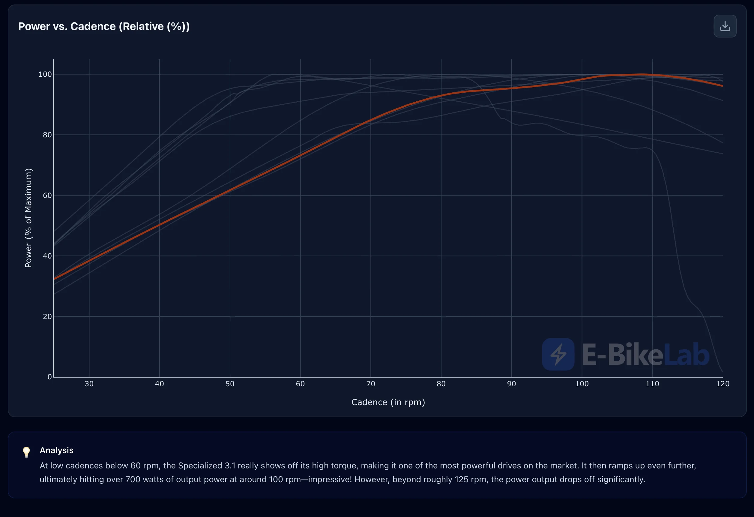

You can verify the existence of this power limit by pedaling in auto mode on a steep climb at a high cadence (120 rpm): the motor cuts power at a certain point instead of increasing it just enough to overcome the obstacle. It happened to me just yesterday and is easily repeatable in the conditions I described. It's not just a personal issue, as some online magazines in the sector have also noted it (see E-mountainbike magazine).
This is also highlighted by the graph published by ebikelab:

It's difficult to objectively assess what happened to you because there are too many variables at play, most of which are unknown. Honestly, at first glance, it seems like you're using too much assistance, making the bike difficult to control. I recommend adapting the assistance to the terrain you ride by testing it out, gradually using Dynamic Microtune. This allows for gradual power implementation and provides dynamic assistance, generally with smoother power and torque delivery, making for a more controlled ride. In my experience, using Dynamic Microtune is even better than Auto, which works very well with a steady, steady pedaling cadence but suffers from an on/off behavior as soon as the cadence slows and pedaling resumes.
