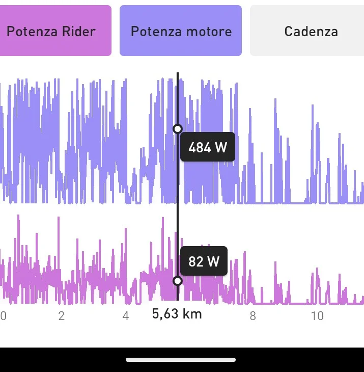

You can verify the existence of this power limit by pedaling in auto mode on a steep climb at a high cadence (120 rpm): the motor cuts power at a certain point instead of increasing it just enough to overcome the obstacle. It happened to me just yesterday and is easily repeatable in the conditions I described. It's not just a personal issue, as some online magazines in the sector have also noted it (see E-mountainbike magazine).
This is also highlighted by the graph published by ebikelab:
I have hit this power wall repeatedly in just the condition you speak of. It's very annoying!

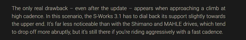

4) I've noticed that when climbing a hill at a high cadence, the motor reduces support towards the top end, and this happens when you pedal aggressively at a high cadence. Sometimes it even seems like the motor reaches a sort of power wall, only to immediately recover, irreparably jeopardizing its continuity of action.
I sincerely hope that Specialized will fix these flaws as soon as possible, but I also wonder how they could have released an update so hastily: didn't they test it before putting it on the market?
This is exactly what Im experiencing too.
#4 is the most annoying. I notice it a lot when I start to climb in high cadence up a steep or short hill. Sometimes it feels like the bike power almost shuts off for a second.
not 100% sure if we talk about the same issue but this or a similar issue has been mentioned by emtb magazine in a very diplomatic way in february (New Power Update! The S-Works 3.1 – In Our big e-Bike Motor Group Test). Although the issue occured after the update - the issue didn't exist before. As they mention this applies to aggressive riders with fast cadence. So probably it's something else......

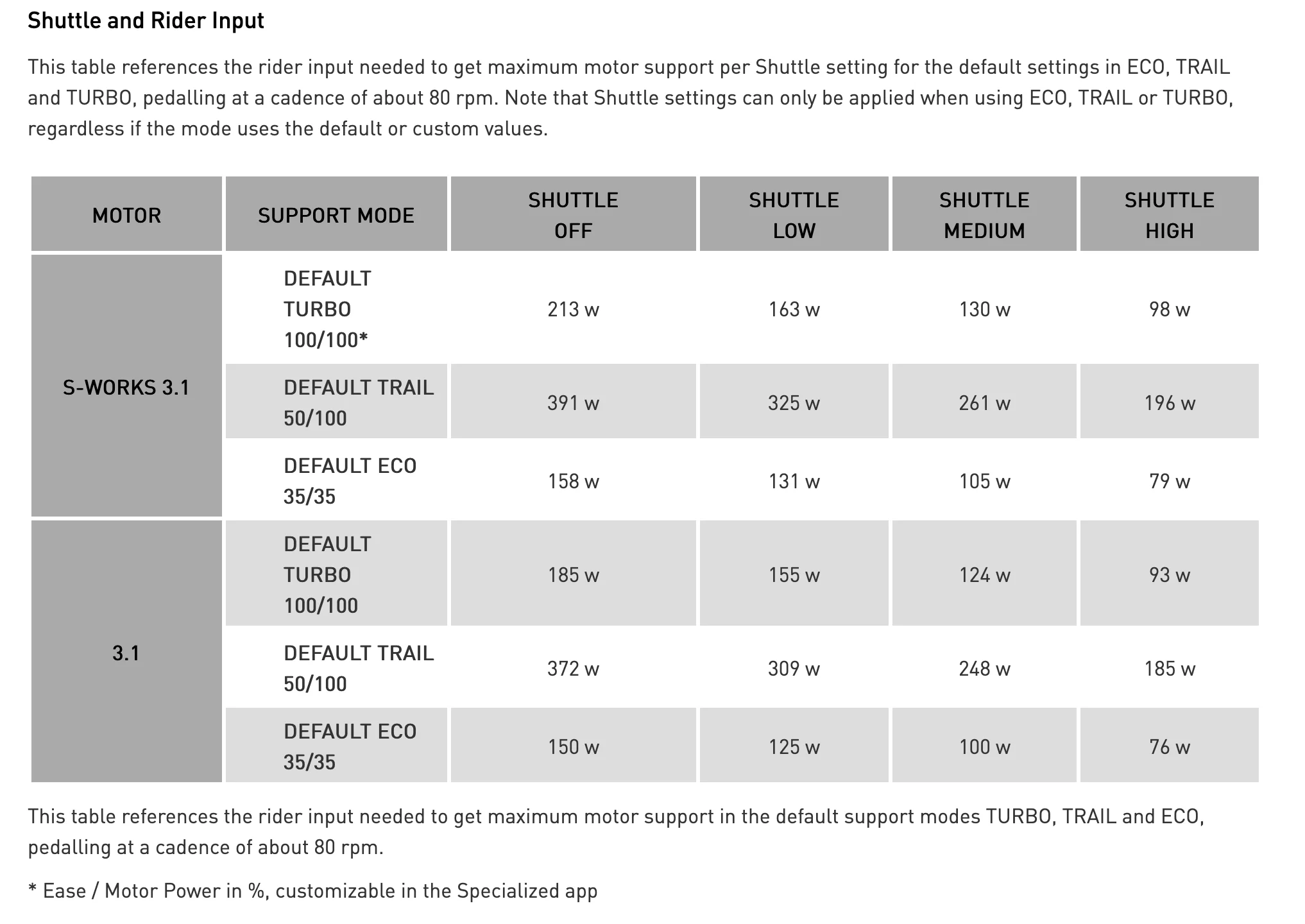

Do you have the shuttle setting adjusted? After my above post I read further into the Levo settings and the wording they use to me sounds like the shuttle setting alters the assistance past 400%.
in fact I use Medium as a shuttle setup
That could explain it.
Looking at the below table it seems to me shuttle can push assist factor beyond the 400%.
S-Works motor has 850w and you need just 98W of rider input in Turbo to get all of that.
I think Specialized are deliberate in not really shouting about shuttle mode in marketing.
I've been riding a Bosch gen5-powered bike the last week. It did not have the latest 600% performance upgrade. You really notice the lower multiplier. The Levo just zooms so effortlessly up a hill.
thus, according to above tables, the supporting factor should be:
shuttle OFF: 400% approx
shuttle LOW: 500% approx
shuttle MEDIUM: 600% approx
shuttle HIGH: 850% approx
and in both versions of the engine (s-works or not)
