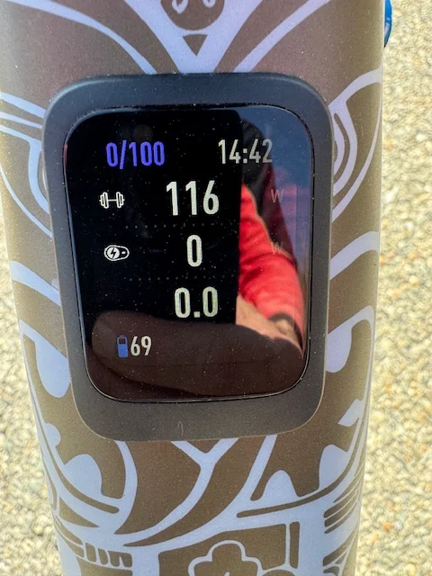

I'm very happy with the new update. I now only use Dynamic Microtune, mostly in 0/100 mode, and increase the assist when I need it: phenomenal! To achieve perfection, I'd ask Specialized to fix two more things: the initial noise when you activate the walk mode (the noise is also present when you start pedaling, so pay attention) and that annoying sensation you get when you shift gears or press on the pedals after a short stop and the bike jerks slightly forward due to the abrupt engagement of the motor. Then it would really be perfect!
I haven't even messed with Dynamic Microtune, will check it out.
How do you get into the 0/100 micro tune mode?

Dynamic micro tune 0/100: engine power and assistance ratio do not appear, is it that difficult?
