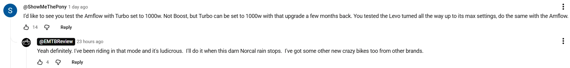

Cue the Amflow fanboy rebuttals because the updated S-Works just took the KOM in this comparison.
lol
It’s only a matter of time. They really do love their Amflowz. They’ll be all ….
“Nuh uh, see he said, there’s a turbo button 🤣” such a whiney, look at me fan group.
Chill down you don't want a cardiac arrest and that's definitely not #fakenews
Try harder. From MTBR directly:
