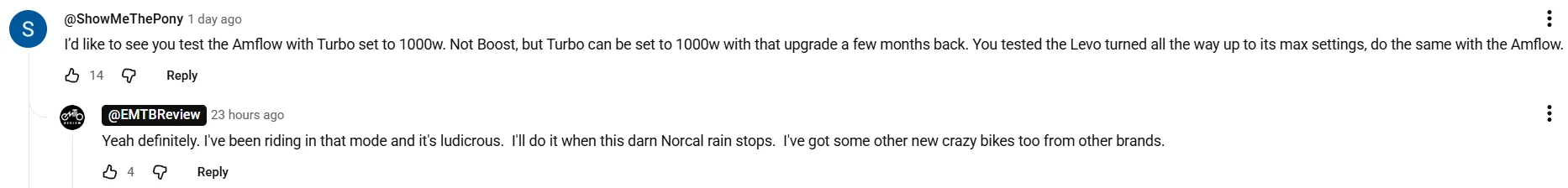

Again, did you watch the video as he literally said that the Amflow had the 1000watt option but was tested at the previous lower power setting of Amflow (850 watts). So what did you miss?
Seems like 850w compared to 850w is an acceptable comparison.

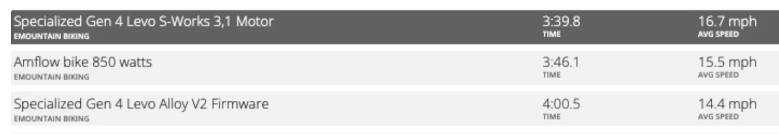

Not only did it seem fair but the numbers are what should stand out, 1.2 mph (average faster) at same the 850watts . What do you think that 150watts remaining from the Amflow will net it on the climb? Diminishing returns the faster you go....
Yes, he tested the Avinox at the 850W setting, true.

Rider power and skill makes at least as much difference. And beyond power, bike balance and geometry, tires, power delivery and controllability all play a role. But Francis’s test was all about climbing speed with equal rider input.

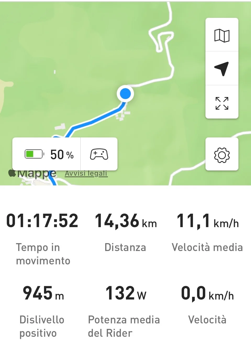

Today I did another test ride with the new firmware update, all done with Dynamic Microtune 0/100 (which I really like) to see if there was any improvement in fuel consumption. I started with 80% and reached the top of the climb with 30% less. But it's the feeling of this assistance that I like most of all, I really think I'll use only this from now on; sure, you have to put in some effort, but the motor's response is excellent, even on steep climbs where you obviously need to choose agile gears and adopt a more muscular riding style. Personally, I'm very happy with this update. Well done, Specialized! You've given me the bike I wanted.
That a great numbers, round about 40km with 3000hm in this Mode possible
