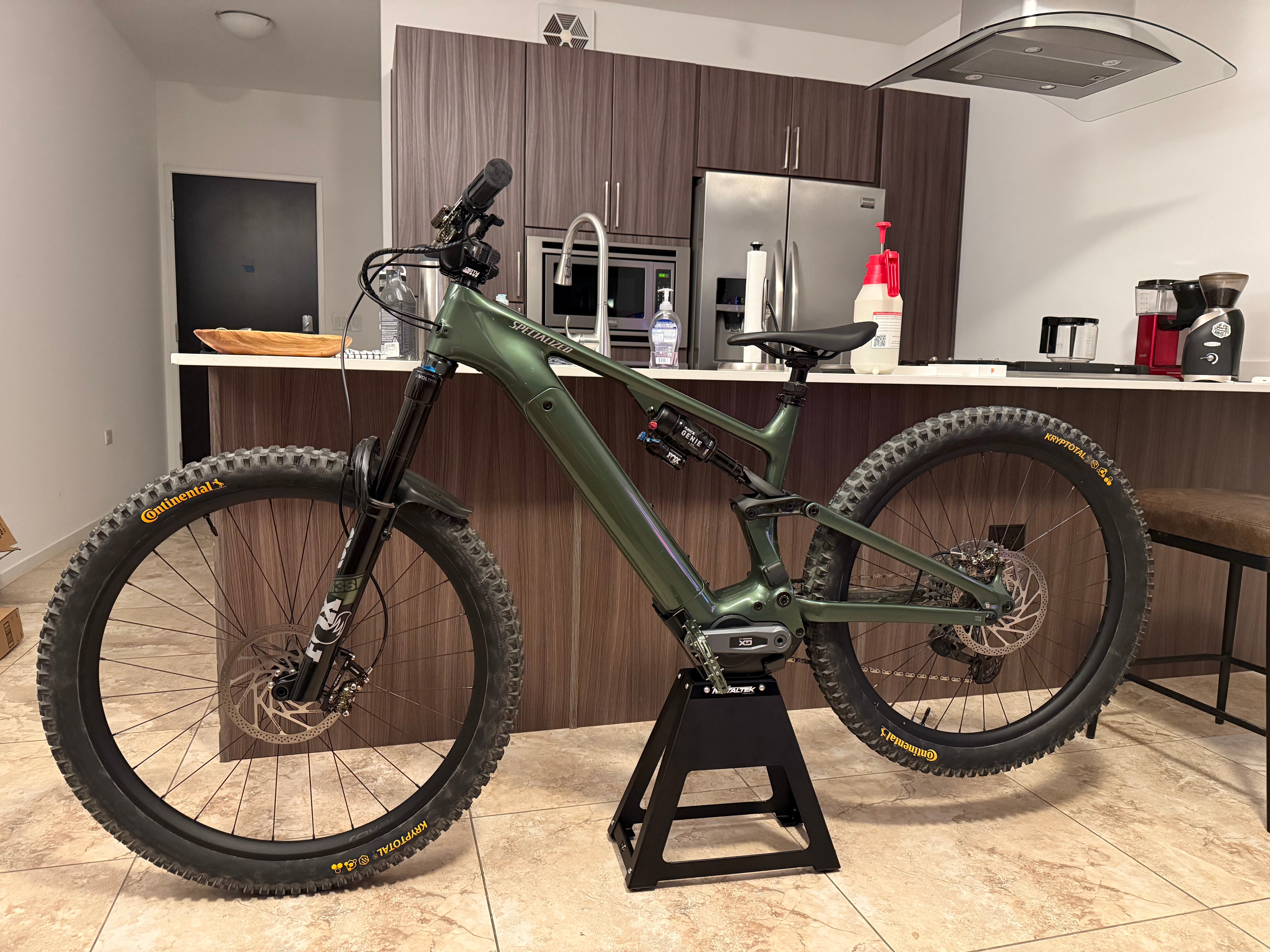

40 miles on it
10 HARD
I love this thing. It’s my lift replacement device
170mm F/R
CC long travel link EXT-E Storia , and yes the Podium. Predictable in the air. Effortless in rough.

How are you liking the 170 front and rear vs the standard 160/150? Noticeable difference? Any disadvantages?
I mean there’s probably more weight. But it’s almost indescribable. I’m really glad I did it. Floats, but with control. The HBO is so awesome a wheessh instead of clunk.
Curious if you chose to adjust the head angle or flip chip; or did you keep those at the stock setting?
Stock for now. Geometry will be played with later, don’t want another set factors to deal while I dial my suspension.
I like the fat tire look, must be magic carpet ride? It also makes downtime look smaller
Thanks they're 2.6" Kryptotal, with enduro casing and soft (not super soft) compound. I'm a lifelong northeast rider that's brand new to the Arizona desert so these were a local's recommendation. While they are super resistant to rim strikes/pinch flats; honestly everything feels super slippery unless you really commit; plus i'n not crazy about how they much they deflect off rocks. For this reason i just picked up a pair of 2.5" Assagai MaxGrip DH tires to help me find a baseline. Might go to the DoubleDown casing if the DH feels too heavy duty. We'll see!
