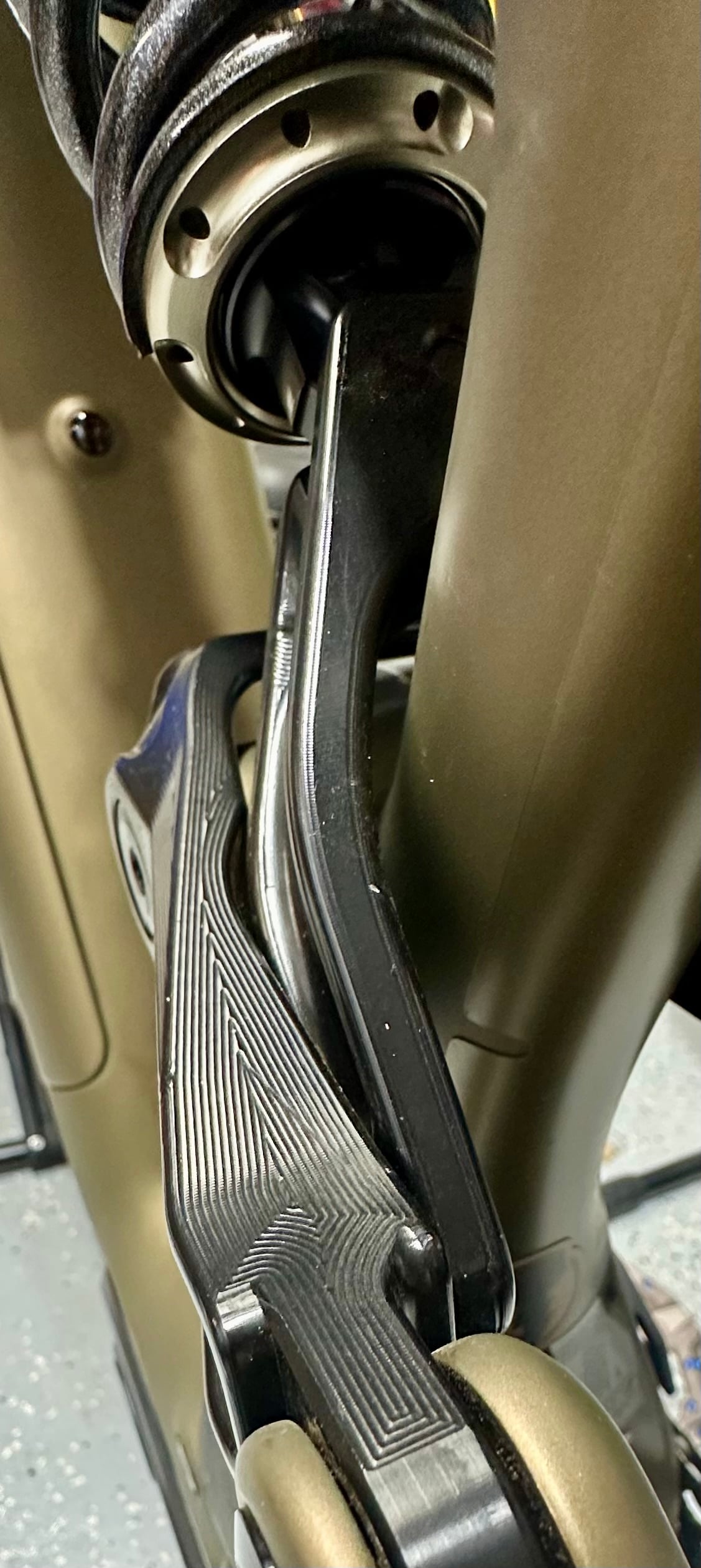

The machining on these Cascade Links is amazing. I’m sooo happy with my Levo.

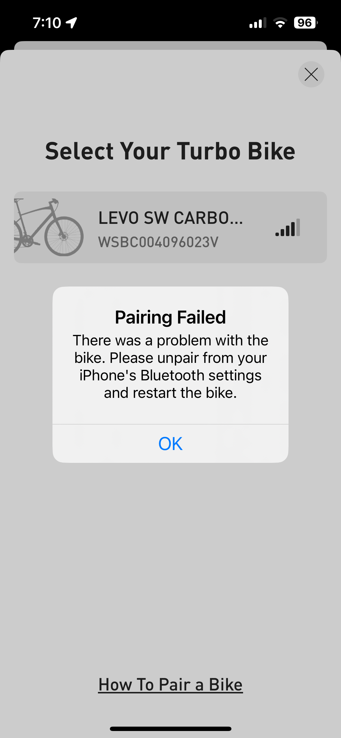

Please Help. I can no longer pair my G4 to the Specialized App (on my iPhone 13). It was working fine since April 2025. Bike shop cannot fix it, so they started a case with Spesh Mexico. This is how far we get when we do the pairing process.
Yes. Also did a reset to factory settings -
Try removing the battery for an hour or maybe overnight. Then, when you put it back in, try pairing it with your phone again. I had trouble connecting to my bike, and a hard reset helped (I held the power button for 50 seconds, and that helped). Fingers crossed 🤞
I’ve seen certain phones have issues connecting to things. Try a newer or at least different phone.
Make sure yours can update to the most recent IoS
Some older phones are no longer supported by Apple updates.
I’m tossing out ideas, not any type of expert.
I was going to recommend the exact same thing, "try a different Phone". I recently had a similar iPhone 13 issue and used a different phone and the issue resolved (different SW but same type of issue). Sorry I know not everyone has a second phone. Also, the remove battery part is a good idea, don't believe you need to remove for 24hrs, just pull the battery and hold the "power on" button for 10-20 sec and that should draw out any residuals.
News on troubleshooting - I paired my Gen 3 on my iPhone 13 - but still not able to do the same with my G4. Dealer says waiting for guidance from Global
Try removing the bike from your bluetooth devices in your phone settings. The Gen4 shows up as the last 4 digits of the serial number not the whole serial number as other Gen Levo’s did. Once you forget the bike from there it should pair again in the app.
This seems to be common when the factory reset on the bike has been done.
yeah tried that plus all other suggestions - thanks for your help.
Mine did this , the dealer told me to hold the mode switch up and press the power on for 30 seconds, and it came back to life within 15 seconds . Been good since
They did that at shop and I just tried again still not pairing - thanks
