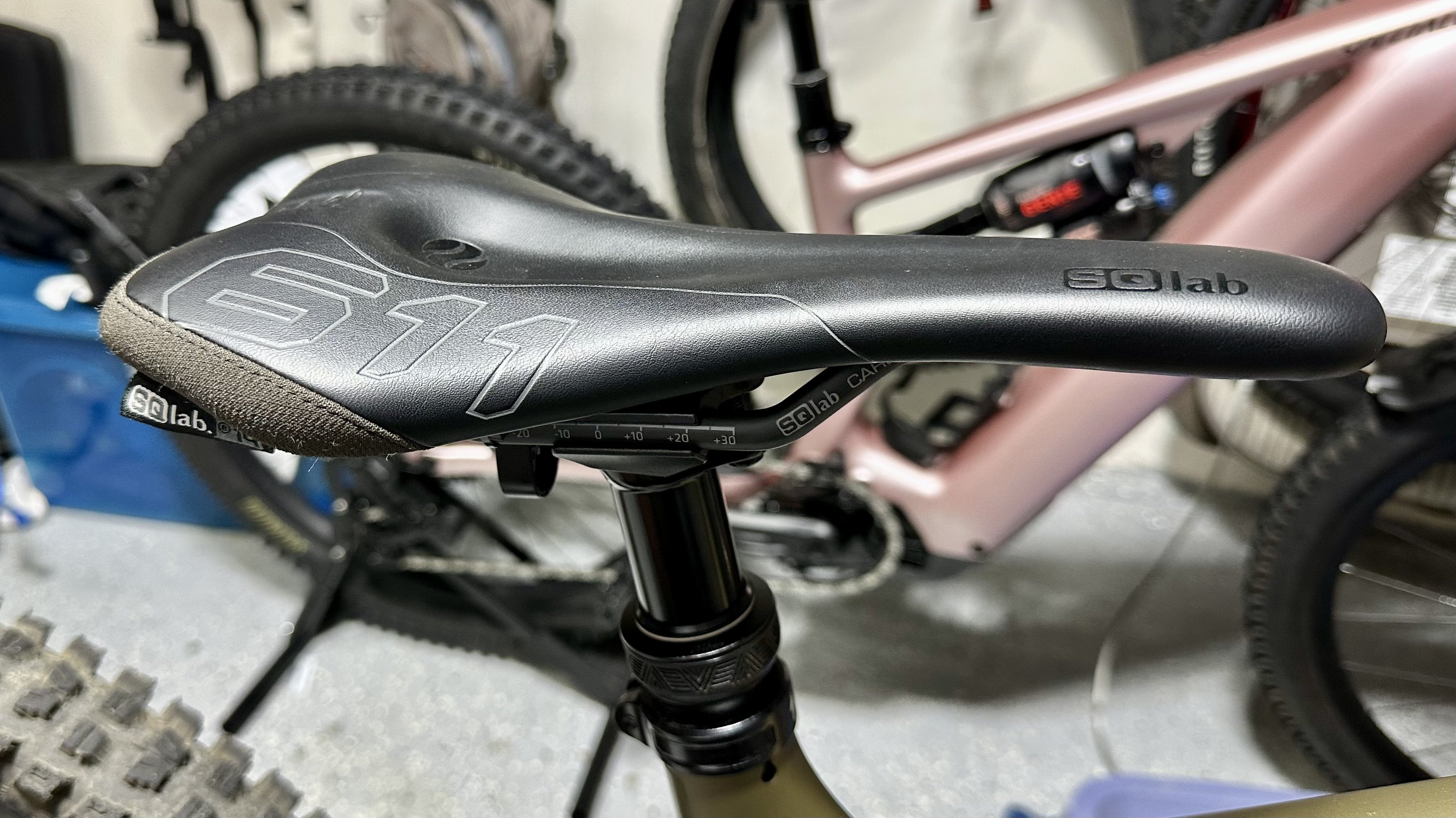

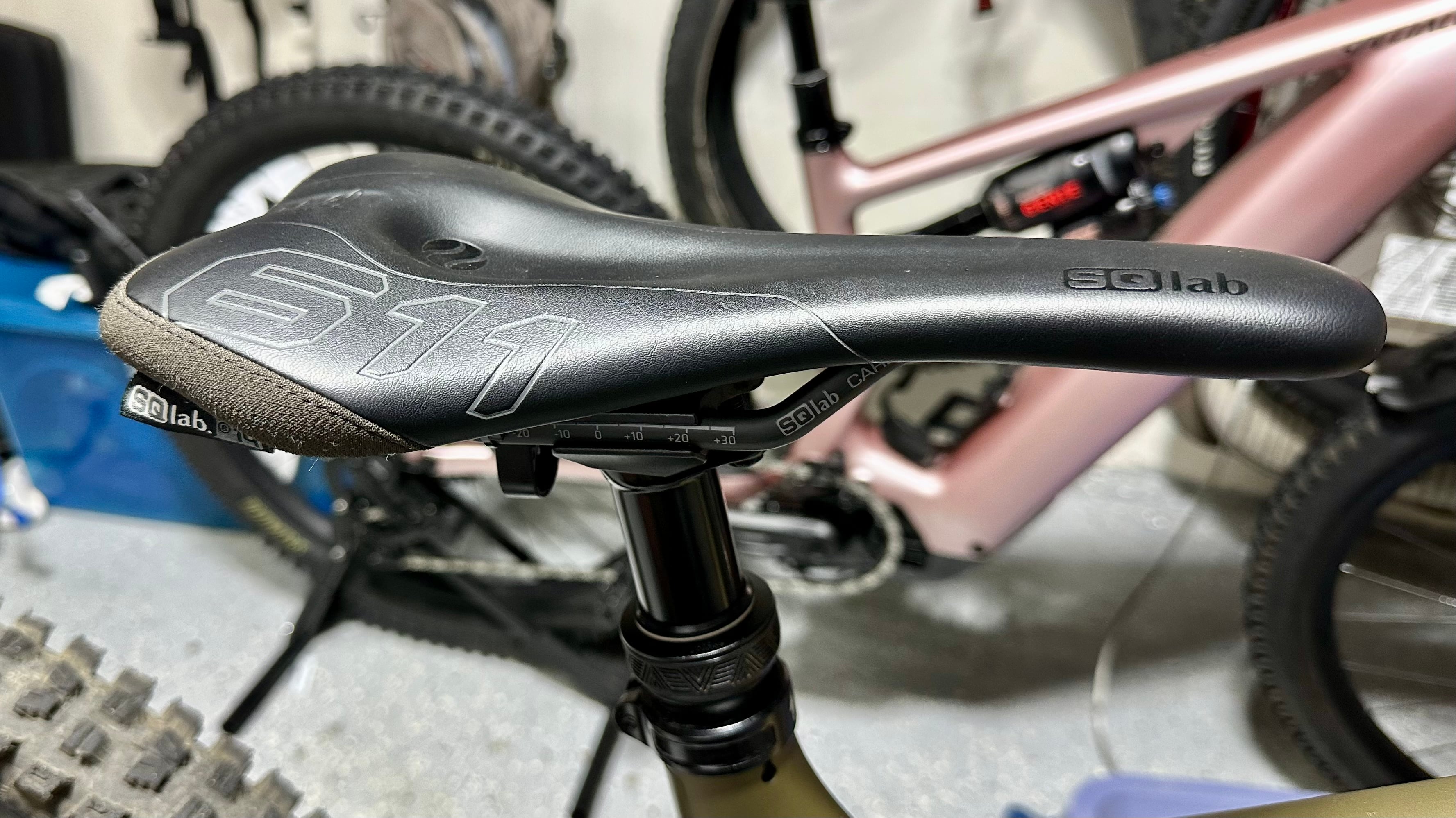

I switched to SQ-Labs
611 carbon . My wife got the 611 reg, it moves with her on switchable durometer bushings. Soft,med,firm. She likes soft.
Mine Is still a mtb saddle but it’s like 200 grams lighter. My dropper is a rocket now!
Comfy enough for the sitting I do🤣its more comfortable than the Mimic, but it’s not softer.
The cool thing is they’ll send you a sit bone measurement packet. In our experience it worked great.
Don’t forget to torque. Seats get a pretty good clamp down.
Oh and no creaks on either saddle
Even the one that moves
