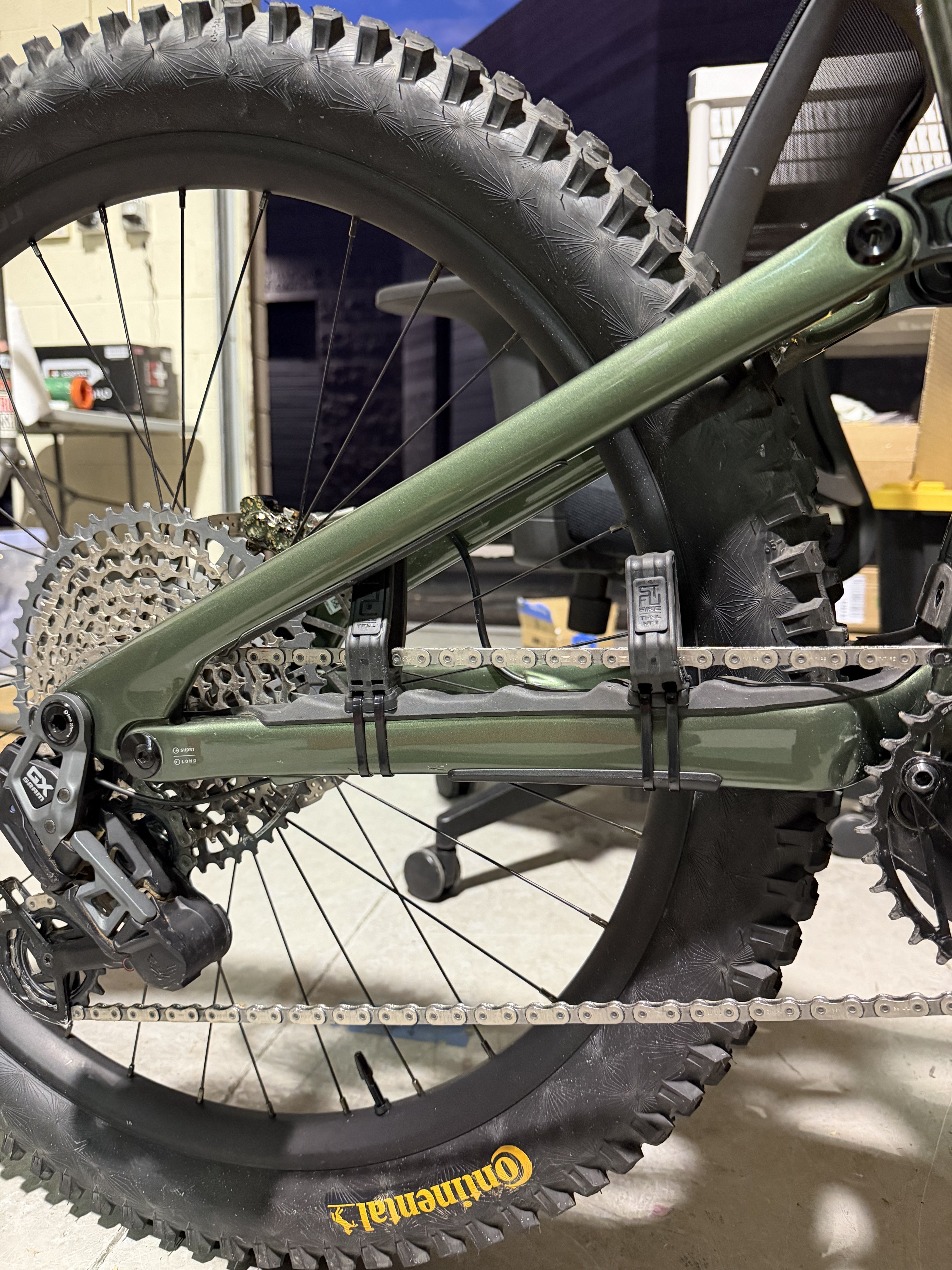

Serviced the chain today and added a STFU chain guide while I had the chain apart. My friend swears by it so I figured I’d try it out.

The STFU guides are awesome. Honestly I wasn’t really complaining about chain slap, but now that I put the guides on I realize how much noise was there. There’s effectively zero chain noise now. Considering how inexpensive they are; I have no reservations about giving them my full endorsement.

I tried one and couldn't get it to stop rubbing the chain. User error I know. Im usually pretty good at installing things, but I just couldn't find the right position. Does yours rub at all?
Right size chain, efficient mech clutch and don't descend with cassette on smallest cog and you should not need one.
Some frames don’t have enough room. I had one installed on my stumpjumper without issue but I was only able to run one of the two parts on my decoy the second bit was or rubbing the chain or rubbing the seatstays

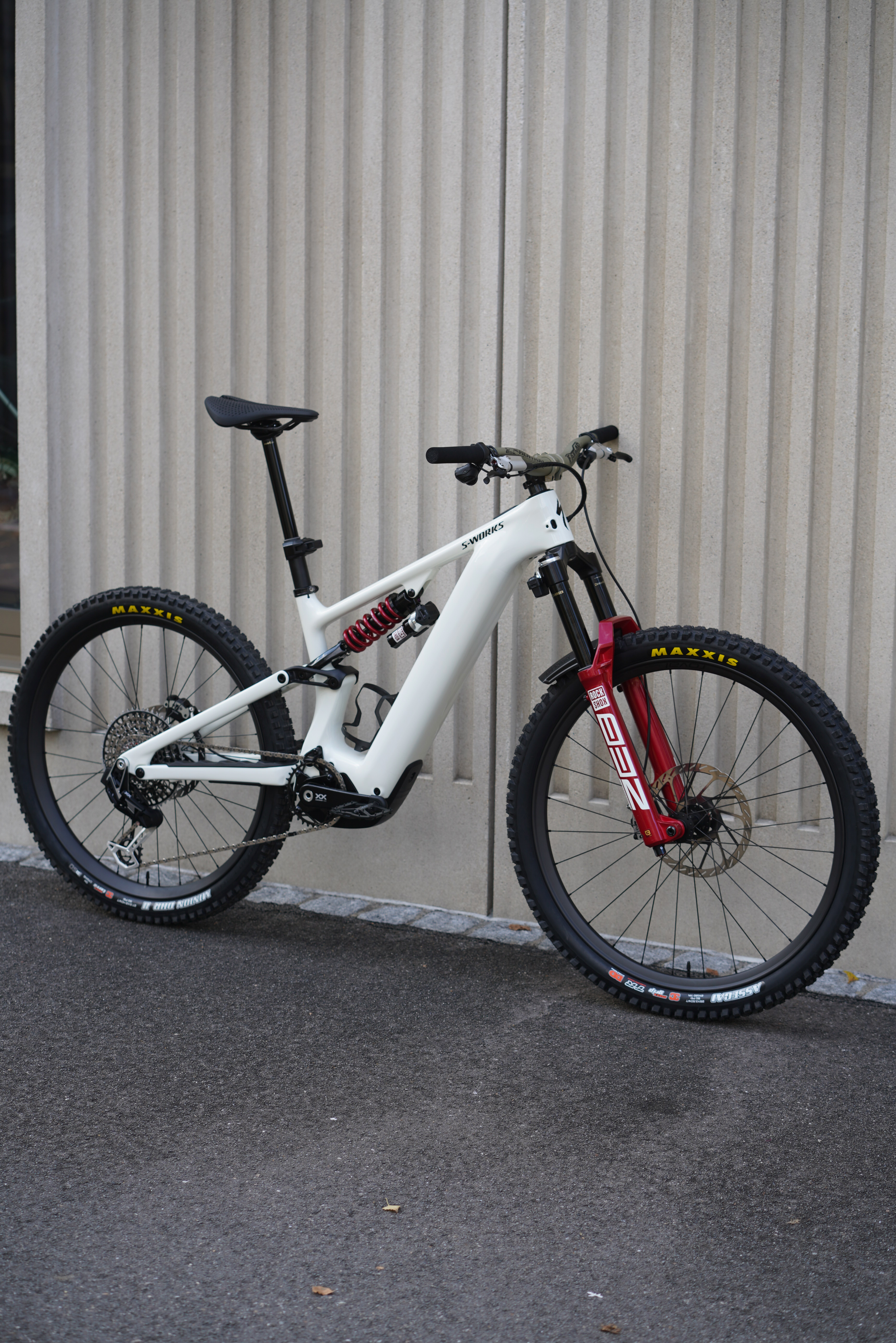

I have finally completed my Sworks Levo, and it turned out exceptionally well. I appreciate the assistance with sizing; the S3 is perfect for my height of 180 cm.

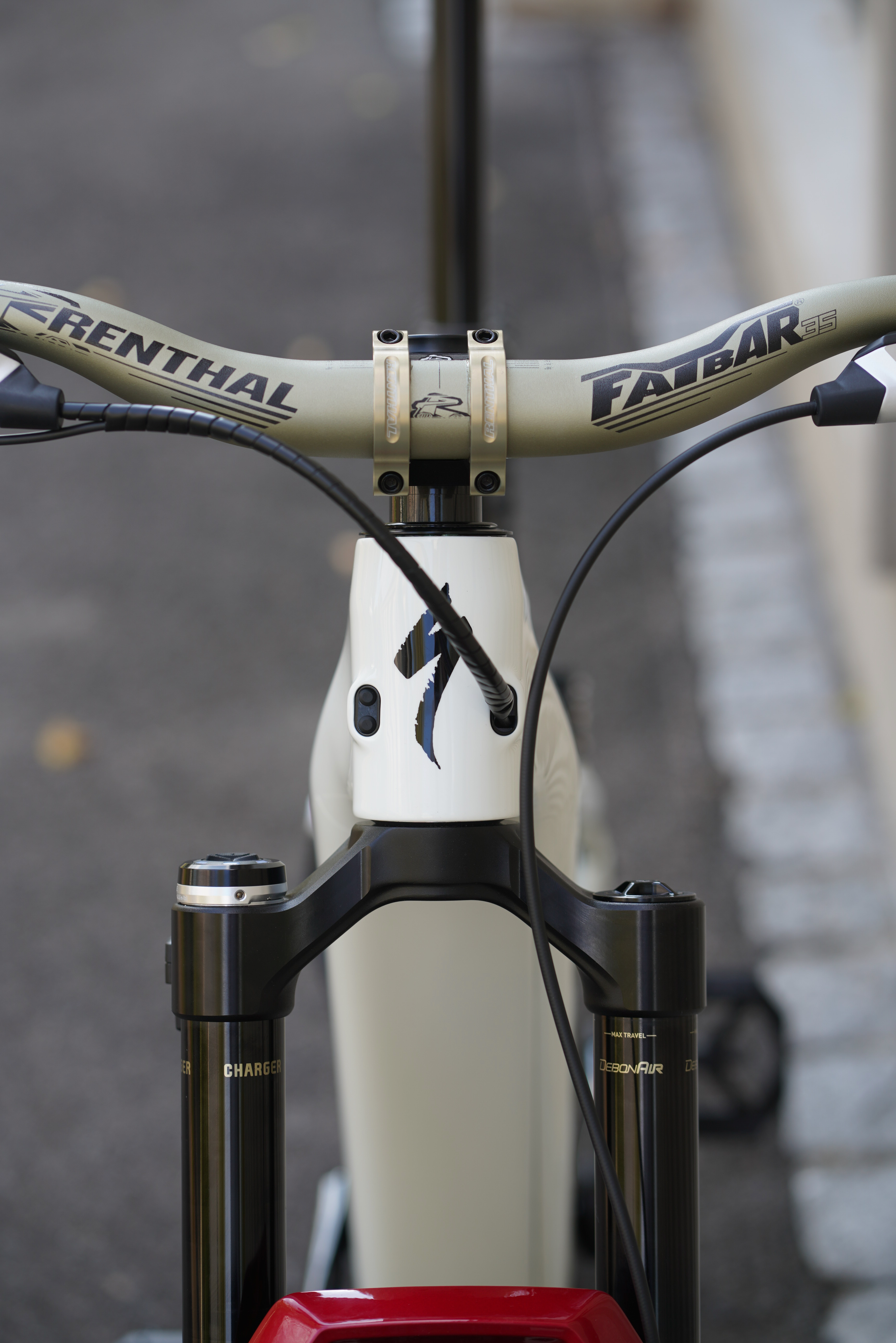

I have also positioned the remote on the right side and "discreetly" secured it along the brake cable.

Why the S3 ? Same height as you and looking at a S4
They should have did the frame only in white instead of Turd Brown Bowling Ball! That white looks so good!

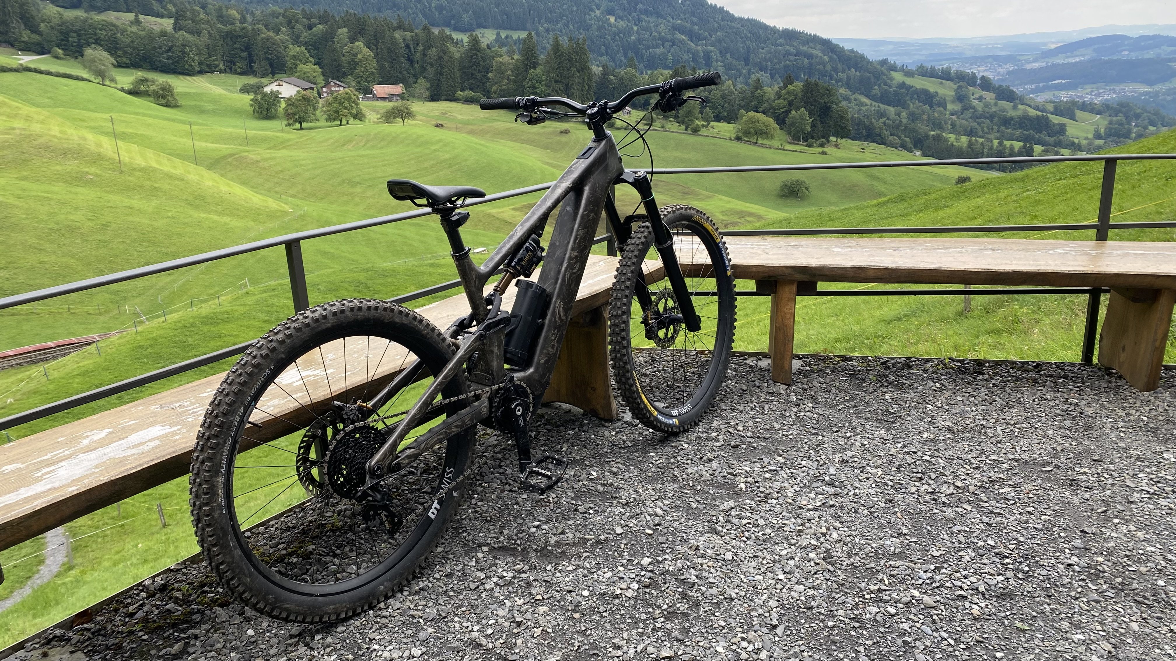

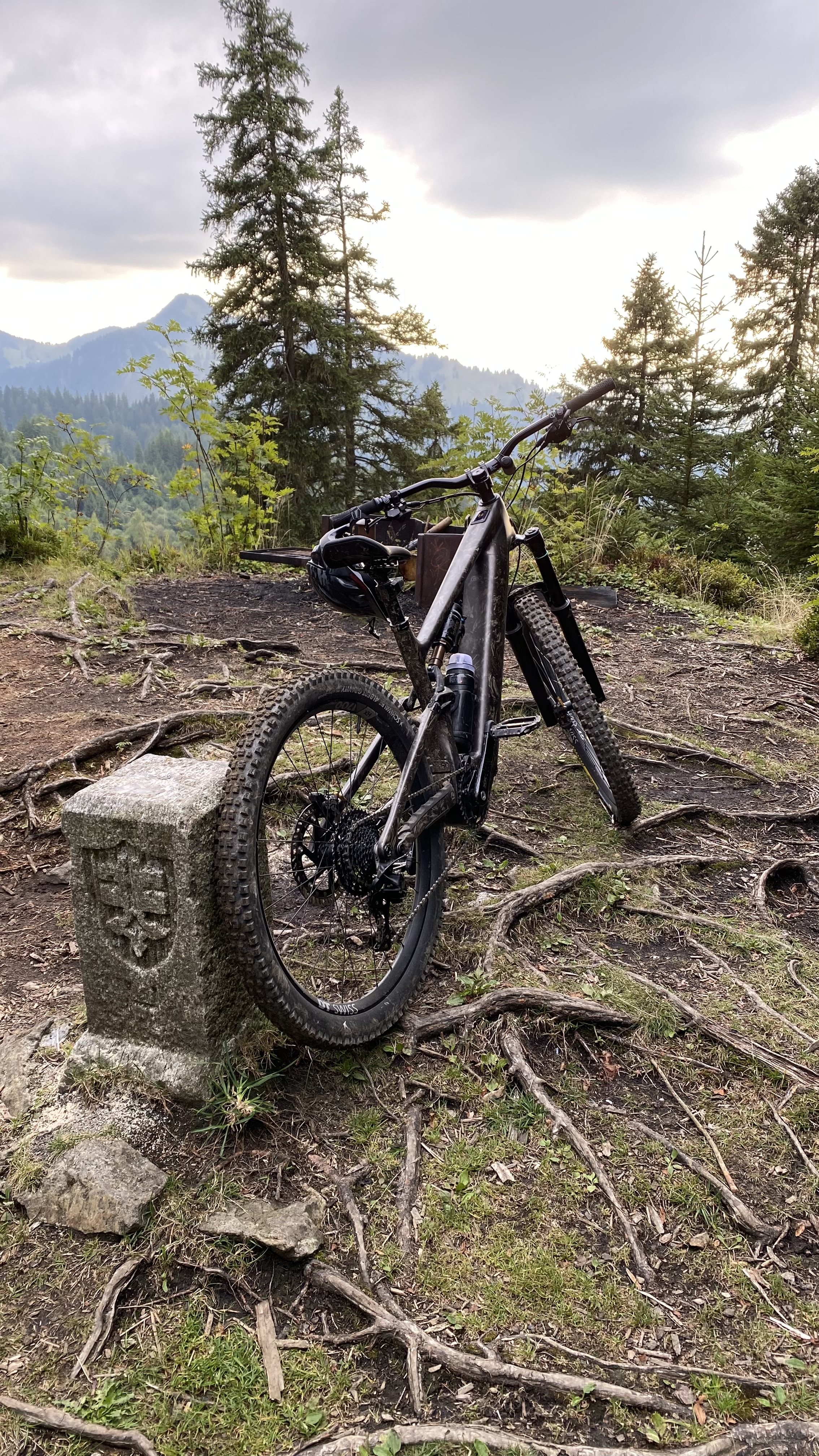

Built mine up from the Frameset, coming from a Large Full Fat Kenevo on 29ers to this one. Choosing between s3-s4 was pretty hard for me at 177cm. But in the end s4 is almost exactly the size as my 2021 rocky mountain slayer..
170mm EXT Era V2 Fork
175mm reverb axs
11s wired sram shifting
Clocks in at 24.0kg with pedals but without any SWATage.
I currently run it in Long and High @0.0deg headset but consider making it slacker. Will try the link chip first, let's see.
Bike rides pretty good, very silent motor, chain, cables etc.
Starting to appreciate the big down tube now that the wet season starts again - integrated mud guard 😜
