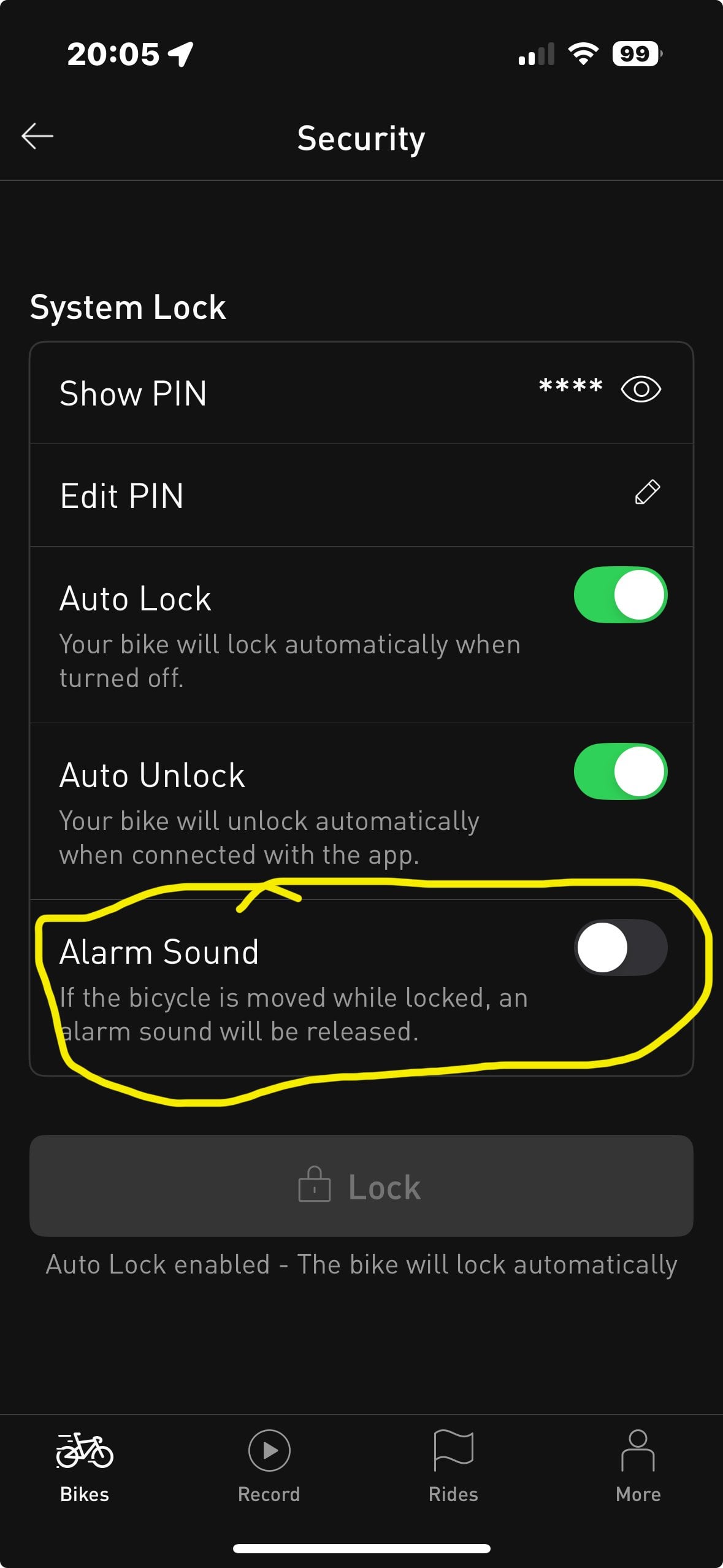

I don't really understand why one would use the app to turn ON the bike ... seems to be so much steps involved (taking phone out from the pocket, unlocking it, open the app, find and press the ON button ...) vs pushing one physical button on the remote ...
so bluetooth is constantly on and ready to paring even when you turn off the bike?
When I move the bike out of the garage and display is dark/off firs the alarm is triggered (I would like it to be more sensitive to movement and much louder) then the display lights up then it unlocks and is ready to go.
I reckon Bluetooth is off all the time but turns on after the alarm is triggered since it recognizes the owner is close to the bike.
Just keep the phone in your pocket that's the whole point wait a couple of seconds until display light up and then until it's unlocked then ride on.
Oh I see, just like a Tesla.
So I guess you can do this only when you have alarm activated. So when you move the bike, it detects your phone and unlock itself and you are ready to ride. If no phone is detected, it sounds alarm and stays locked.
But if alarm is deactivated I guess you still need to power it ON with a remote (or using app by pressing a button?)?
ok, didnt know that, updated my post, thanks
But if alarm is deactivated I guess you still needs to power it ON with a remote (or using app by pressing a button?)?
I haven't tried with the alarm off but I guess the the same will happen but without the alarm triggered first (no reason not)

The bike will only turn on without the remote if you have the below option turned on.
Otherwise you have yourself a normal pedal bike.
If you break the remote and the bike goes off then you are screwed.

I have not tried with the alarm off since it always is on and I don't see any reason for not but I definitely will give it a try.
Actually I think the alarm function could be much better sometimes the bike can be moved far away while shaking the bike other times it trigger much easier so the sensor is not the best.
Some people don’t care about it or don’t even notice and then we get mixed reports, but I’m very sensitive to this kind of thing and could never ride a Shimano motor. The only rattle I can tolerate is the chain.
That must be the case because the gen4 I've tested was new and your above post described pretty well my own experience with the new motor. First I couldn't believe, I've fiddled with different settings, etc, but Brose I knew was gone. So either you'll live with it or you don't.
