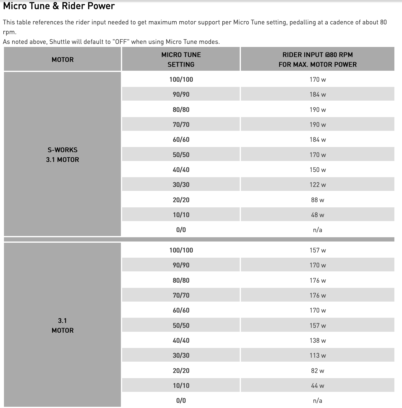

Ok, might need to correct myself here a little. Specialized has a table that shows rider input required to get the max assistance at each increment. It applies to microtune but I assume it the same for the regular Eco/Trail/Turbo modes also.
Looks like 44w/48w of rider input will get you max assistance at 10/10 which would be an additional 66w/72w from the motor.

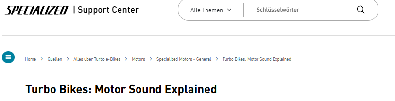

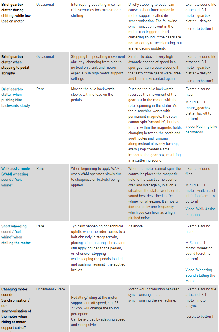

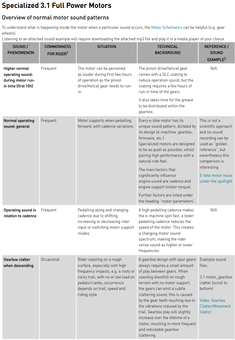

I just found the following information and thought it might be of interest to some of you:
https://support.specialized.com/kb/...00000006201/Turbo-Bikes-Motor-Sound-Explained
At least Specialized explains here that a certain amount of clattering during descending is normal and increases over the lifetime. But it remains quite subjective; some people notice it more, some don't mind it at all, or some are insensitive to it.
The rattling when reversing (I've posted something to this topic already) is also mentioned and explained, even with example videos 😅
I personally think that Specialized's open and transparent way of explaining and disclosing such effects is a good thing, in contrast to some other manufacturers who vehemently deny certain things, do not want to accept them, or do not even take a position if they are asked.
Ok, so they admit the motor will have clattering/clunking noises under different scenarios. So it's normal. Now what ?
Worry less, ride more :-) Enjoy feeling SuperNatural.

From the official document/link posted above :
Gearbox clatter when descending : A gearbox design with SPUR gears always require a small amount of play.....
Fact: Specialized/Brose 3.1/doesn't have spur gears in the internal transmission, just helical.
Fact: Helical gears also require a small amount of play.
The rest of it describes what is happening in different scenarios with plenty of details. Especially when turning the bike backwards, slowly. But this noise is dependent of gearbox/reduction design.Belt /planetary gear combo would have better noise characteristics here because of lower overall backlash and no metal to metal gear contact.

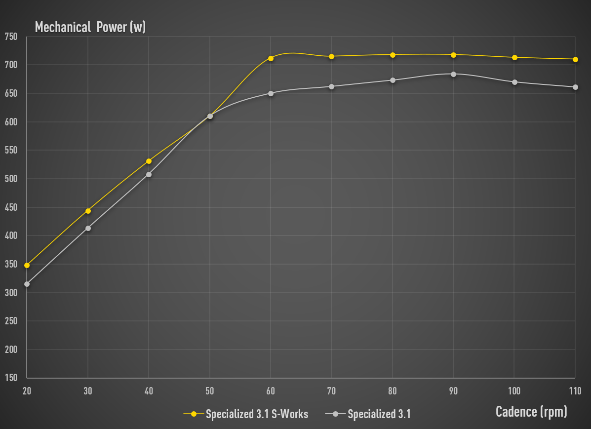

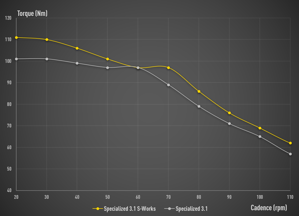

After enjoying the Gen3 Expert and now switching to the Gen4 S-Works... I'm amazed by your comment regarding the new engine's performance. The 3.1 is much smoother, smoother, has better traction than ever, and is virtually frictionless. I honestly see it as a huge step forward compared to the Brose Mag.
Regarding the new screen, I can only say the same... amount of information, size, resolution, and visibility... radical improvement.
I guess it's all about convincing yourself that you don't need to change bikes just yet; it's human!
I'll try the Levo 4 for the first time in early May.
Have you played with the engine settings?
There is a Huge difference between "acceleration" set in low and in high.
I am a racer guy and i love power stage 😜, and i didn't feel any weackness of the engine 🤷‍♂️
I went from a boch race gen 4 and i mostly ride with friend with gen 5 100nm and my SW is far better in grip at low cadence in technical climb section.
Sor far it is the best motor i have owned
