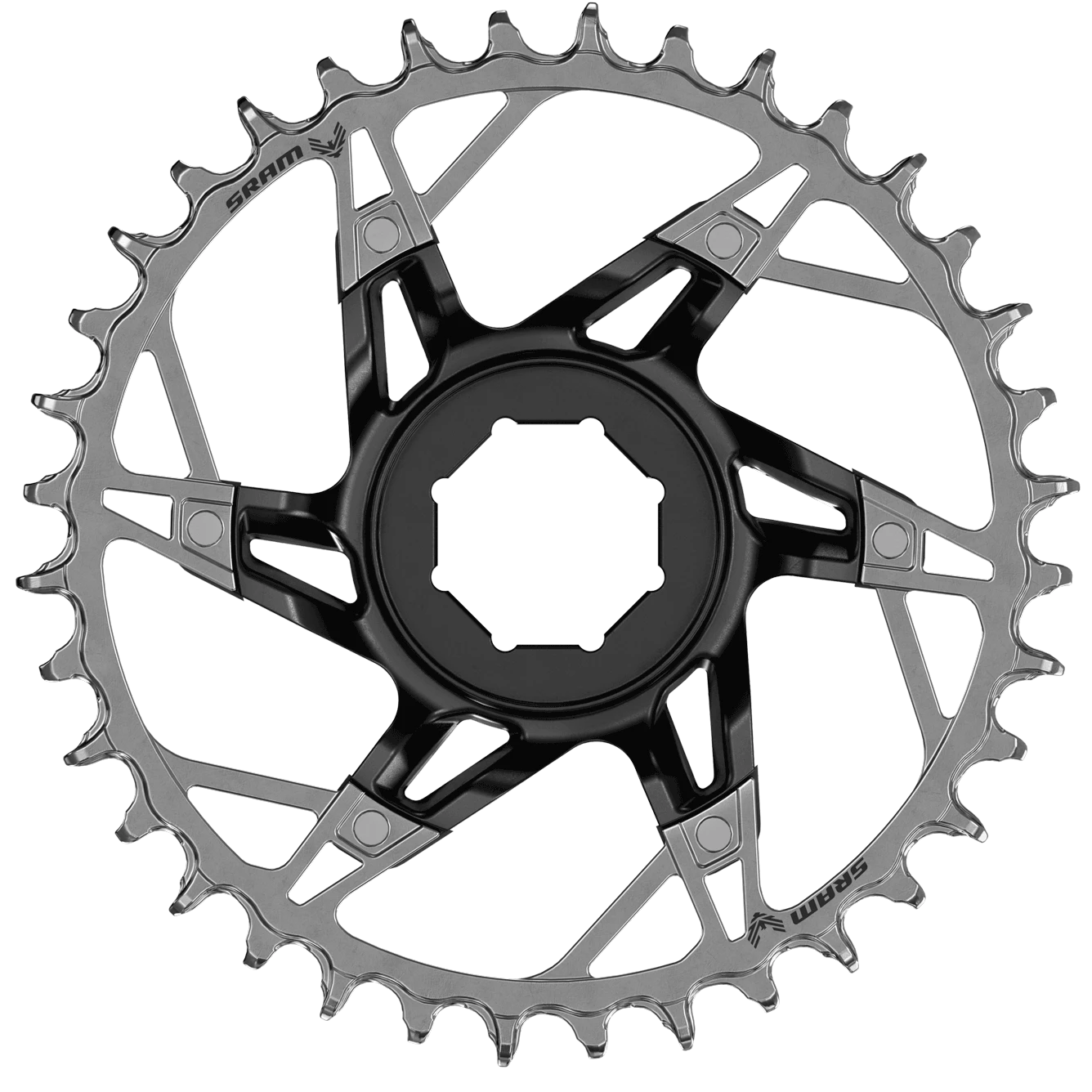

One thing I noticed when I was removing the crank is that the spider has changed from the Levo 3, and now it has a new mount different from the previous Brose motor. The chainring is only black steal and not the SRAM silver. Bummer, I really liked that silver with the integrated spider. View attachment 165810I found one from HOPE that is silver to match the rest of the kit, 104 BCD. View attachment 165811

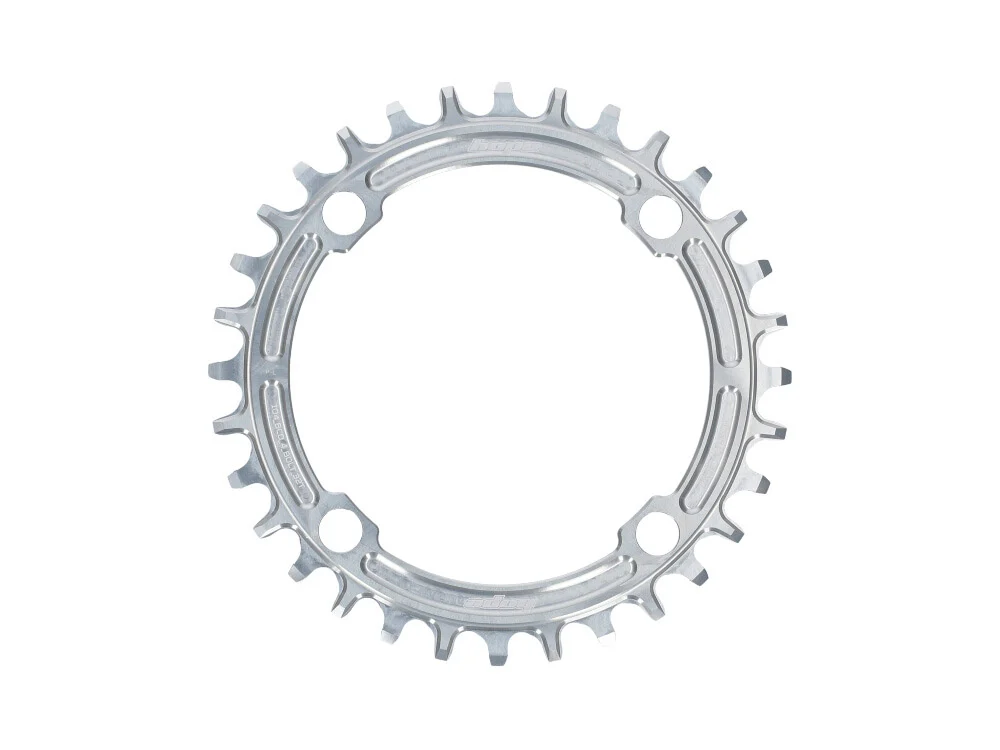

Take care, I bought a Praxis Chainring BCD which doesn't really fit: the holes align but the rear of the spider's extrusions don't align with the one from the Praxis chain ring for some reason plu I'd need different screws as the Praxis one seems to be thinner. So I couldn't make it fit snug.. I opted to keep to stock one and not bother :D

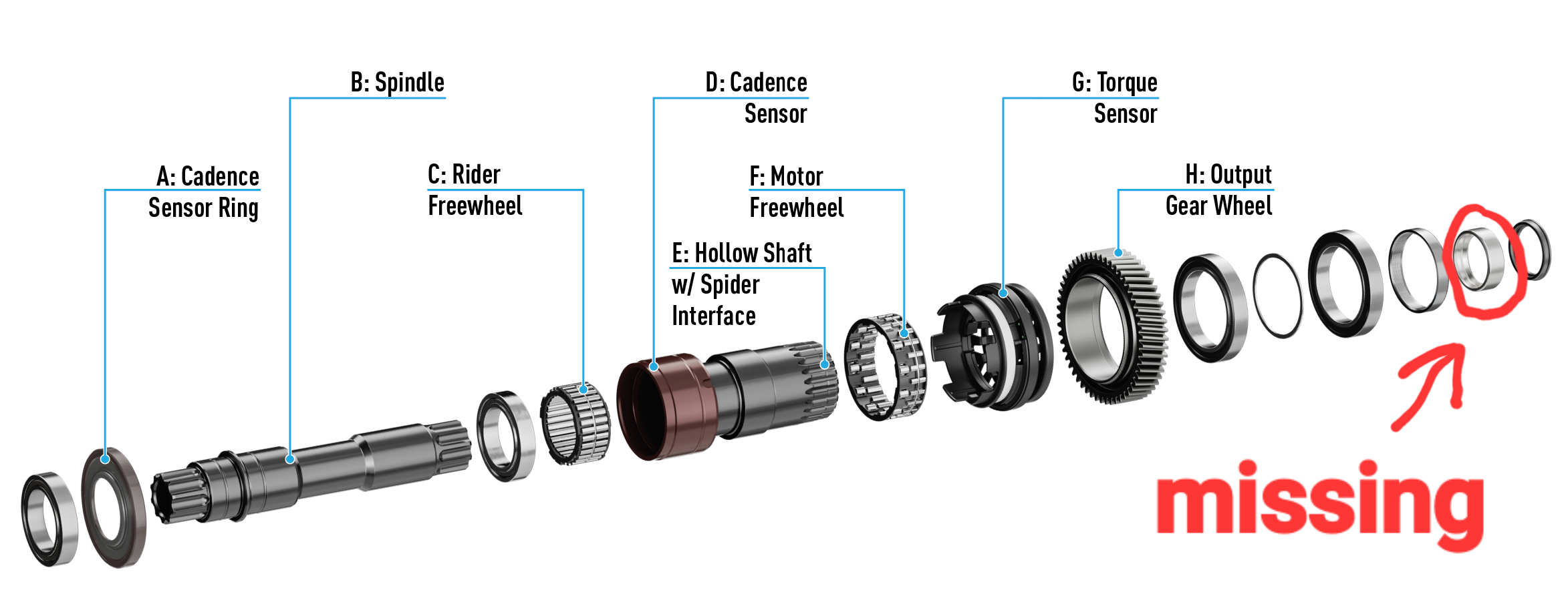

I figured out why it makes this sound. They left out this bushing on the spindle sprocket side. That bushing is simply missing there. Because of this, the end of the spindle will first start to hang, which is why it makes a clicking sound. Then this hanging will break the rider freewheel and that will also make a rattling sound. It's simple, it's not brain surgery, but that could be the cause of the sound.
Or maybe the bushing (circled in red) is worn out, because I don't see a seal on the right end of the shaft in this picture. a That last ring at the end is steel, not a seal. Where is the seal then? Didn't they draw it there?
Here are all the schematic drawings:
