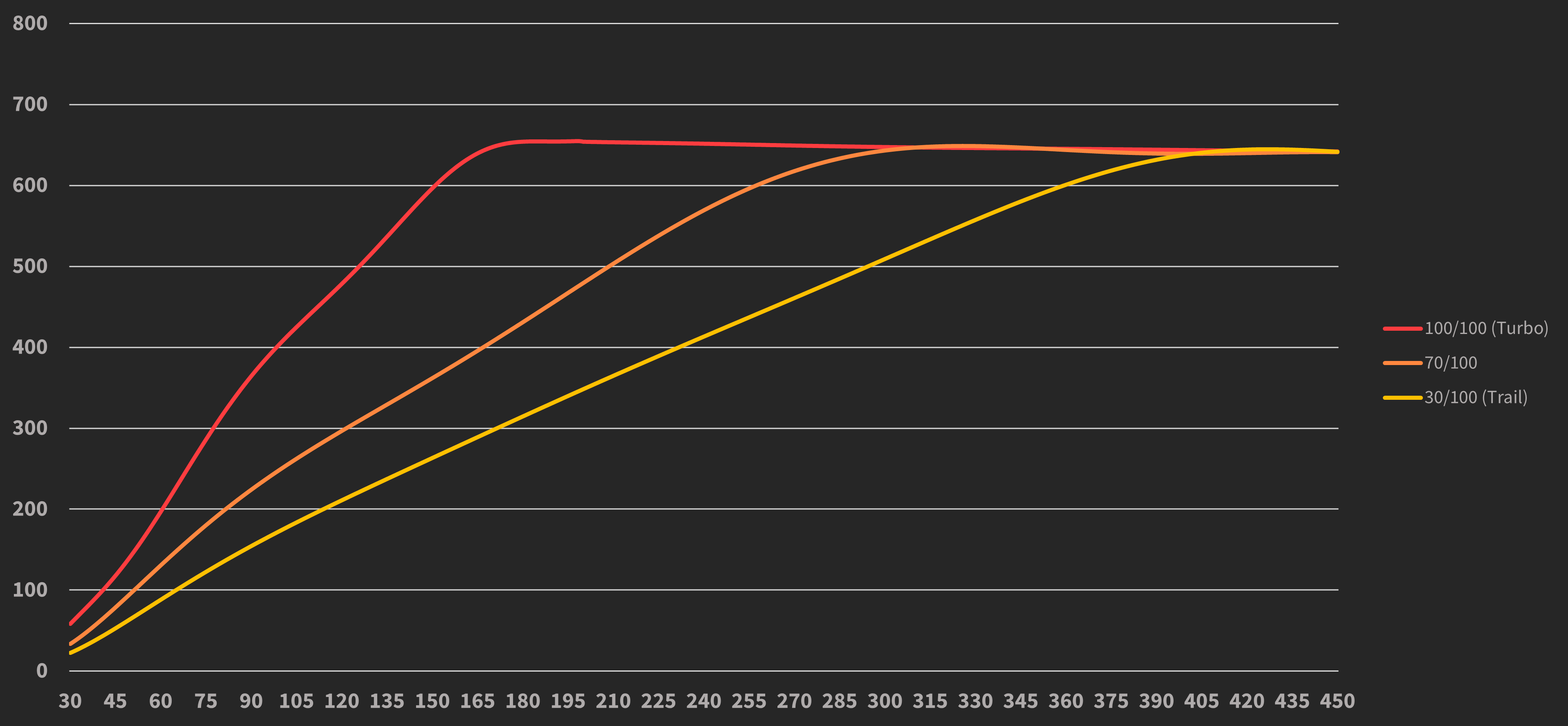

In this image (you can easily find it online), you can see a graph that shows how the motor power output (Y-axis) changes depending on the rider’s leg power (X-axis).This graph was created by testing the bike on a bench.
In the Specialized system, there are two values that influence this curve:
  • The first one (e.g. 10) defines how easily the motor reaches its maximum power output. The higher the value, the quicker the motor kicks in. Changing this number adjusts the slope of the curve.
  • The second value (e.g. 45) is the maximum power that the motor will deliver.
Am I reading that you need 390w of leg power to get max motor power in trail? That doesn't seem right.
Honestly, it does sound a bit strange to me too, but looking at the video, it seems like everything was done in a fairly scientific way...
If someone understands German well, they could probably help us better than the automatic translator.
That video makes me think I need to try 70/100 dynamic microtune. Seems like at 30/100 I'm probably never getting full motor power no matter how hard I work. I doubt I'm putting out 400 watts ever.
Make sure rider & motor power output is displayed on one of your screens so that it's easy to see whats going on. This is configurable in the app. Dynamic microtune ramps up motor power (it's not linear), you're probably able to max the motor with 30/100.
There is a typo on the graph, the correct should be 30/100 (eco), 70/100 (trail) and 100/100 (turbo). In fact you need about 290W to get the maximum assistance on TRAIL

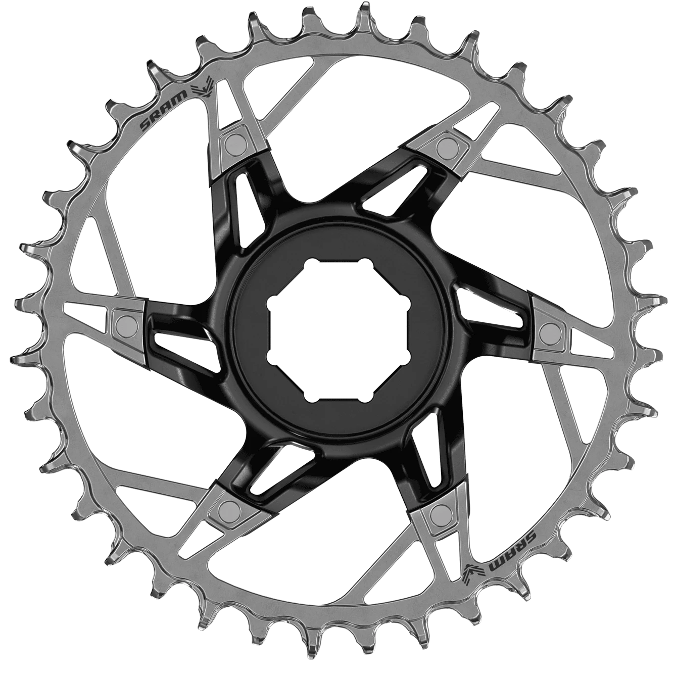

I simply don't like the stock colors, so I decided to give the S-Works Levo 4 a paint job and build it up from scratch.
One thing I noticed when I was removing the crank is that the spider has changed from the Levo 3, and now it has a new mount different from the previous Brose motor. The chainring is only black steal and not the SRAM silver. Bummer, I really liked that silver with the integrated spider.

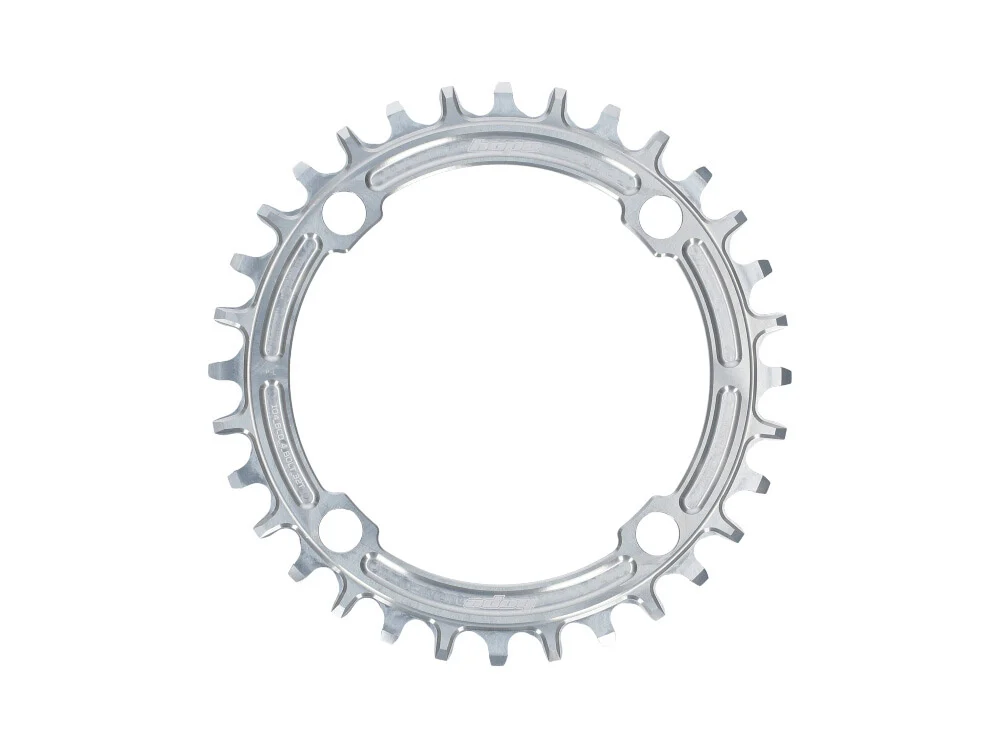

I found one from HOPE that is silver to match the rest of the kit, 104 BCD.

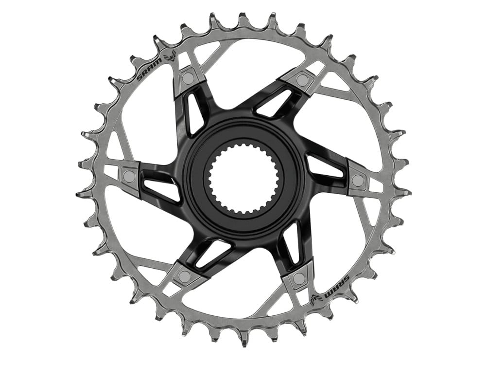

Looking at the manual the new chainring/spider interface looks splined like the Bosch? If it turns out the same perhaps you can use the Bosch T Type direct mount chainrings. Even if it's a Brose specific spline pattern I am sure SRAM and others will come along with a Specific direct mount chain ring soon enough.
Bosch direct mount ring for ref.
I thought the same; however, it's 28 "cogs" vs the new Brose. If I remember correctly, it was only 22 or 24. Definitely not doable.
