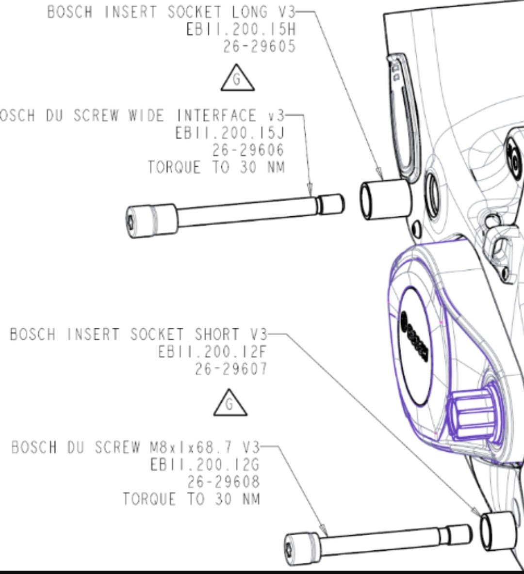

Hello ! Quelqu'un a t'il déjà monté les nouveaux bushing Bosch sur son Vala ?
Report back - Vala went to LBS and he replaced the bushings and bolts under warranty. Also greased the seal behind the right crank. No more knock or squeal.

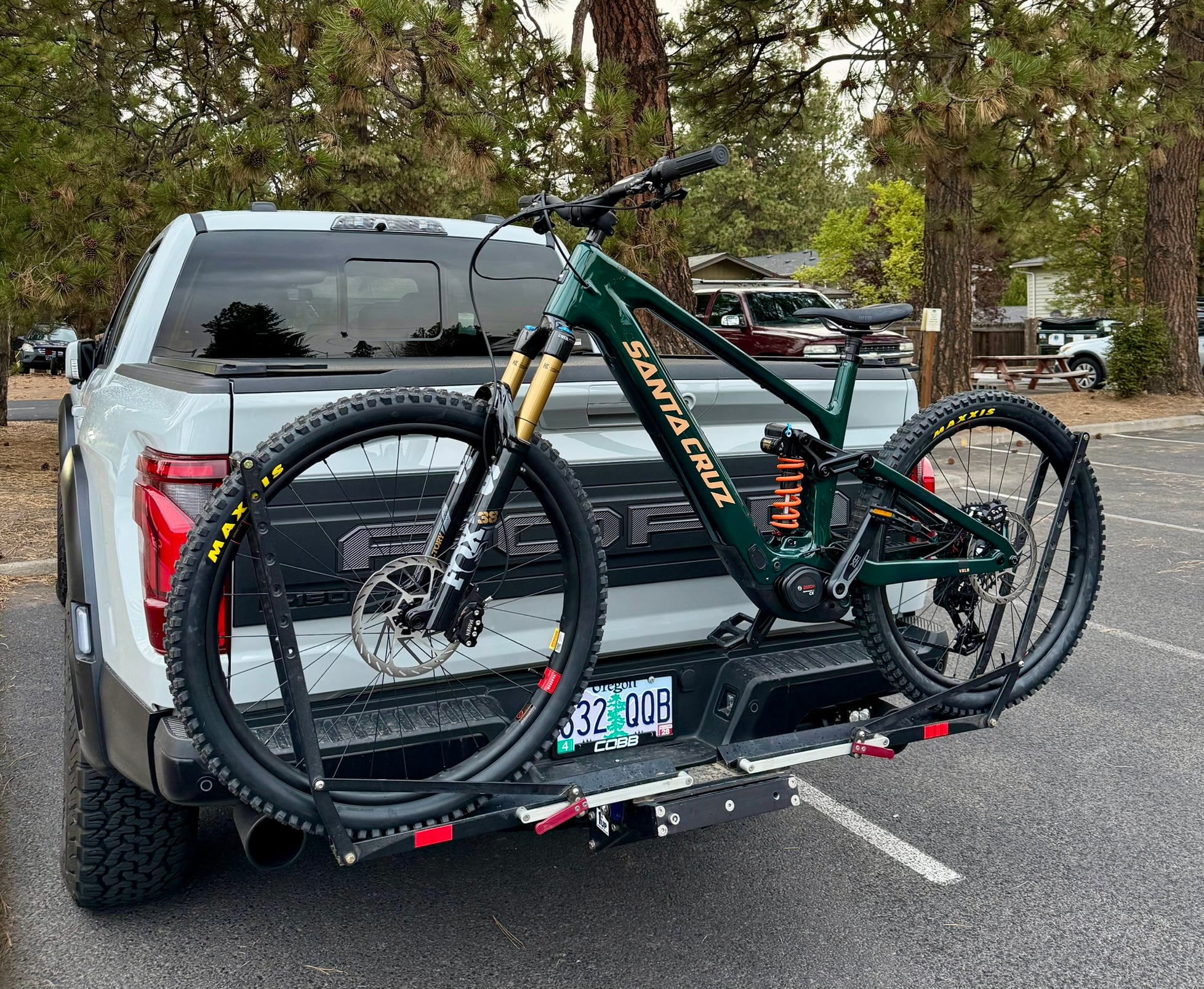

Did you upgrade the shock yourself? DHX2? 205x60? Reason and review if you can.
Thanks
Yeah 205x60. I enjoy coil on all my rigs. Pairs well for what I ride in the Pacific NW. Lots of steep rooty tech where traction is preferred.

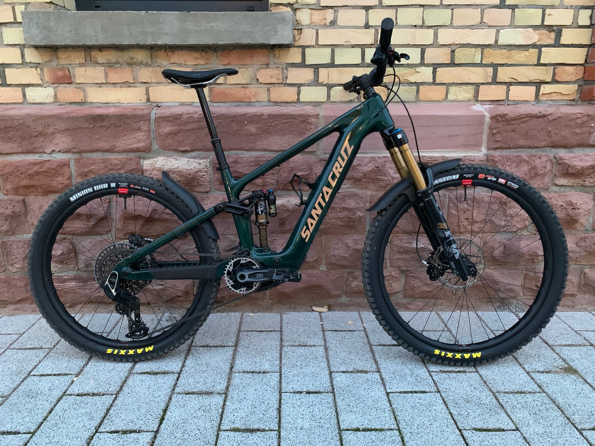

Ordered a Vala X0 AXS RSV on Thursday two weeks ago. My LBS received the box from SC yesterday, completed the build with all my personal setup wishes on the same day and I picked it up and payed for it yesterday afternoon.
Attached my RRP fenders, did a first ride and must say - amazing
Attached my RRP fenders, did a first ride and must say - amazingView attachment 170381.
