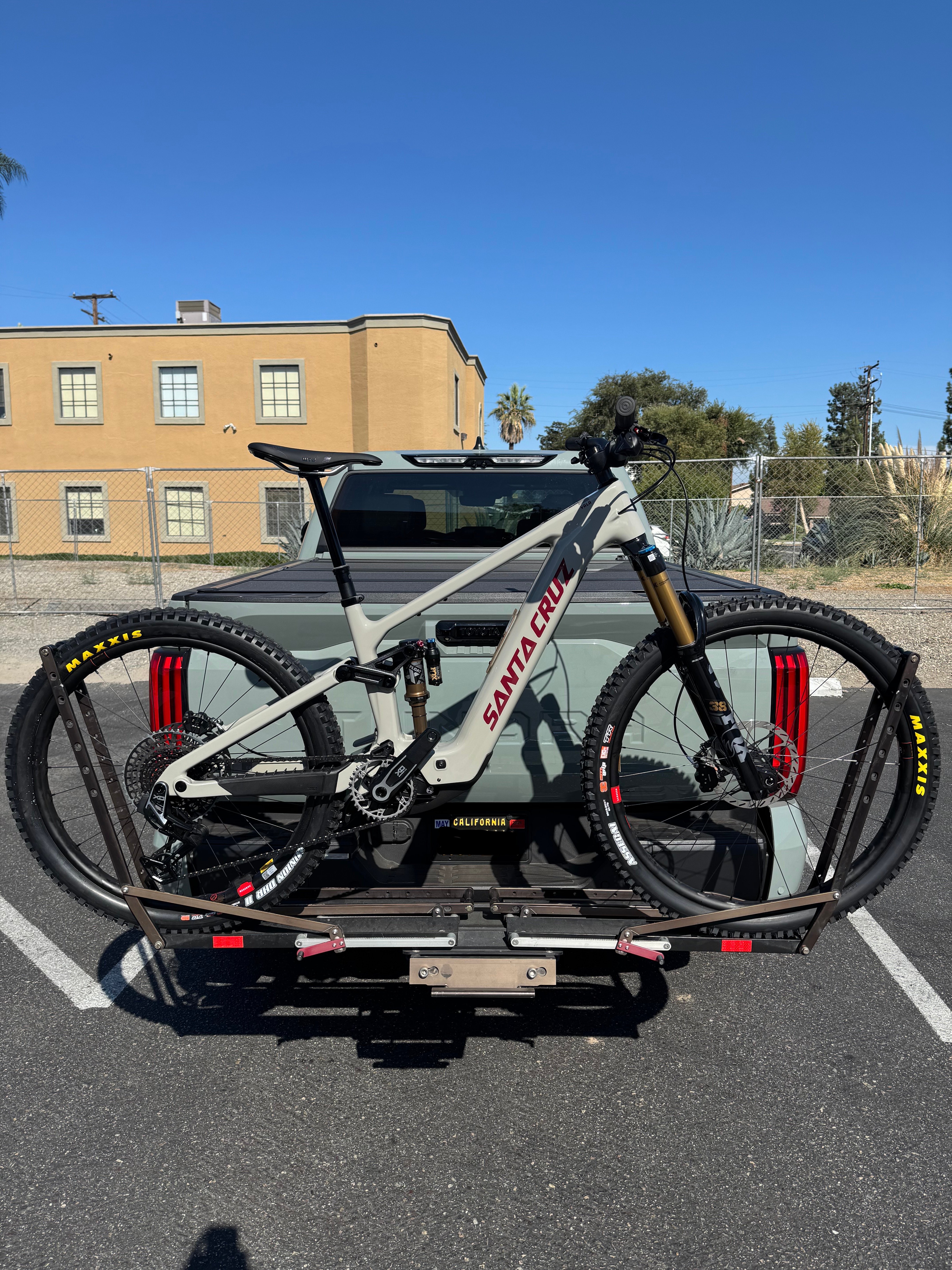

Picked up the new ride last week. Only a few short rides in, but I did make some adjustments to the cockpit. Reach on this medium felt pretty short so I added some OneUp bars with less sweep. See if that makes the fit a bit roomier. Also I expected Schwalbe tires but looks like all the Vala's will be maxxis, which I'm fine with.
Siiiiiiick!!!!!

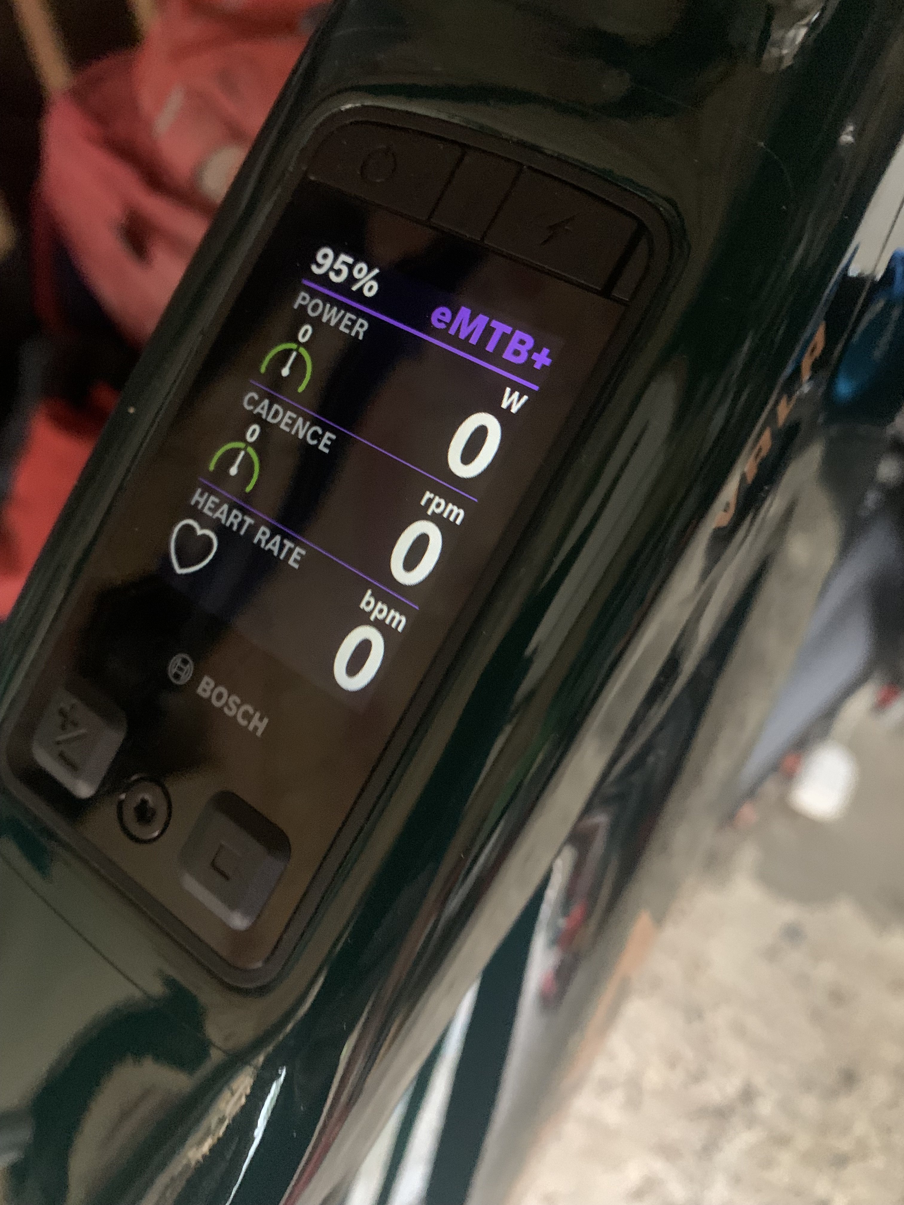

Hello, How to display heart rate on the Kiox 400 screen? I can't do it on flow application.
I have an Apple Watch, and the Flow app asked for permission to read heart rate. Once you allow that, it will display. It's a bit clunky to get it to show up though, you've got to start the Flow app on your phone, start the ride, then the Flow watch app needs to auto-start. After it does that, then it shows up on the screen. I haven't tried pairing Flow with my Polar HRM strap.
I must have been riding too much in dusty/gritty conditions because the old blockout scuffed the black "CC" strip above the cutout.
Thanks for your answer, I have a polar HRM strap, and I didn't successfully.
