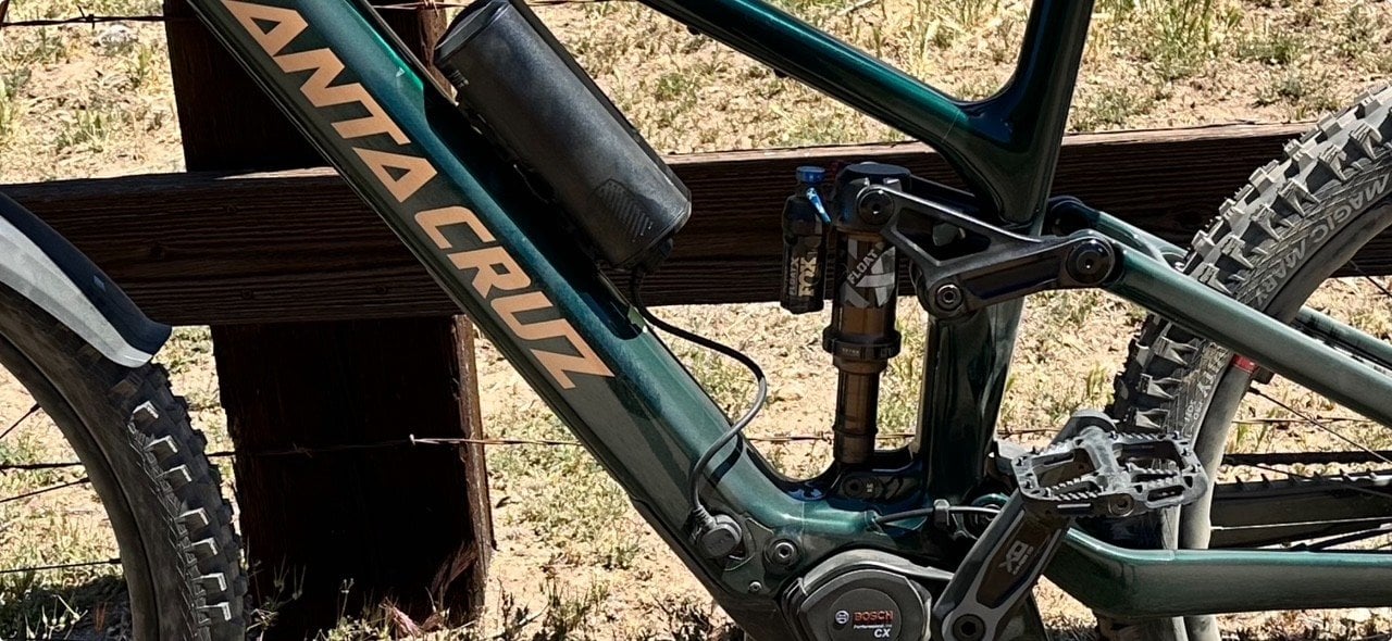

I posted this photo on the Bullitt forum. The 250mm cable works great with the battery end facing down. Not sure what they call that since the Bosch description is confusing. I have an XXL frame
Do you just pop off the rubber charge port cover, then reattach it when you finish using the PowerMore? That's what the Pivot manual suggests doing, SC doesn't say anything to that affect.
Yes, I cut the little tab off of it and just remove the cover. I would think If I didn't it would end up missing at some point. To replace it is like $4. I haven't lost it yet
I posted this on the Bullit forum. 250mm cable on an XXL frame is perfect. No frame contact. Cable exits down at battery and does not use the wrangler. Cut the tab off the battery cover and just remove it when not using the PowerMore. No dangling and if I had to replace it, it is $4. Repost to edit photo for improved quality

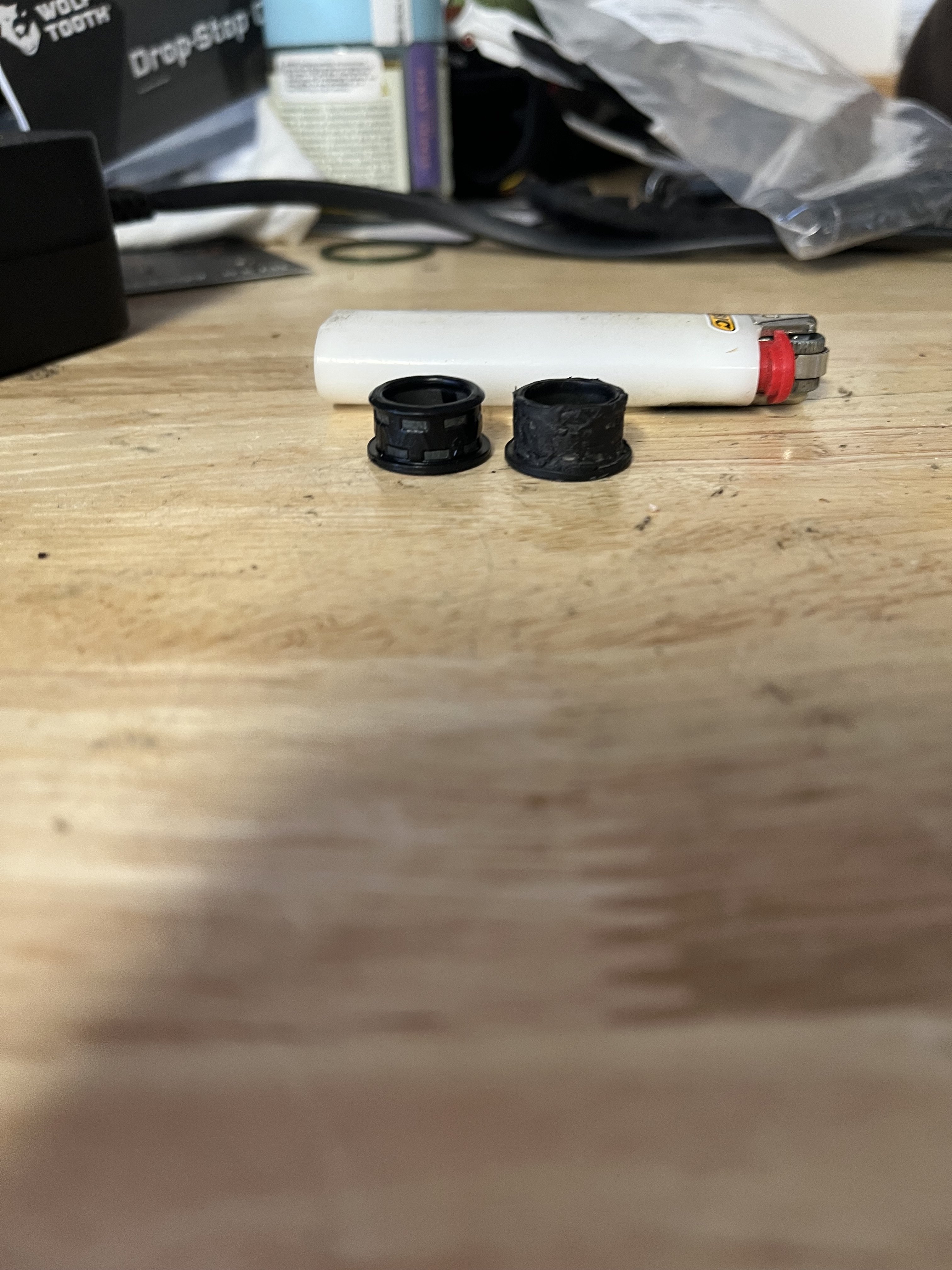

Following up on my previous. Ordered some new bushings from Euroland ( thanks for the tip Shark58! ) that arrived today. Same day as Sc Bikes has one available due to the holiday break. New vs old. View attachment 152797
Hard to say why it happened. The inner lip locks into the frame and maybe it was damaged from the factory? Took no chances and ordered 6 of them!

OK, after contacting Santa Cruz recently about the movement and creaking noise from the bolts against the bushing sleeves, tech support told me that a new design on bolts and sleeves (from Bosch) were on the way to SC. And that a set was going to be shipped to me in the next few weeks. After waiting actually less than two weeks, they arrived on the mail. I was so excited to install them, that I did not take pictures, sorry. Bolts look almost the same, with a small difference on size, (bigger around the head of the bolt, compared to the original ones) Sleeves are completely different. However, when I was testing the new bolts without even replacing the sleeves, I noticed a big difference in how tight they fit now. No movement on the motor anymore. So, at the end, I ended up replacing just the bolts and it feels super solid. And saved the new sleeves for the next time I service it. This worked for me. I hope it works for you guys as well. So, basically, in my case, the original bolt heads were smaller than ideal. My bushings were still good and in place.

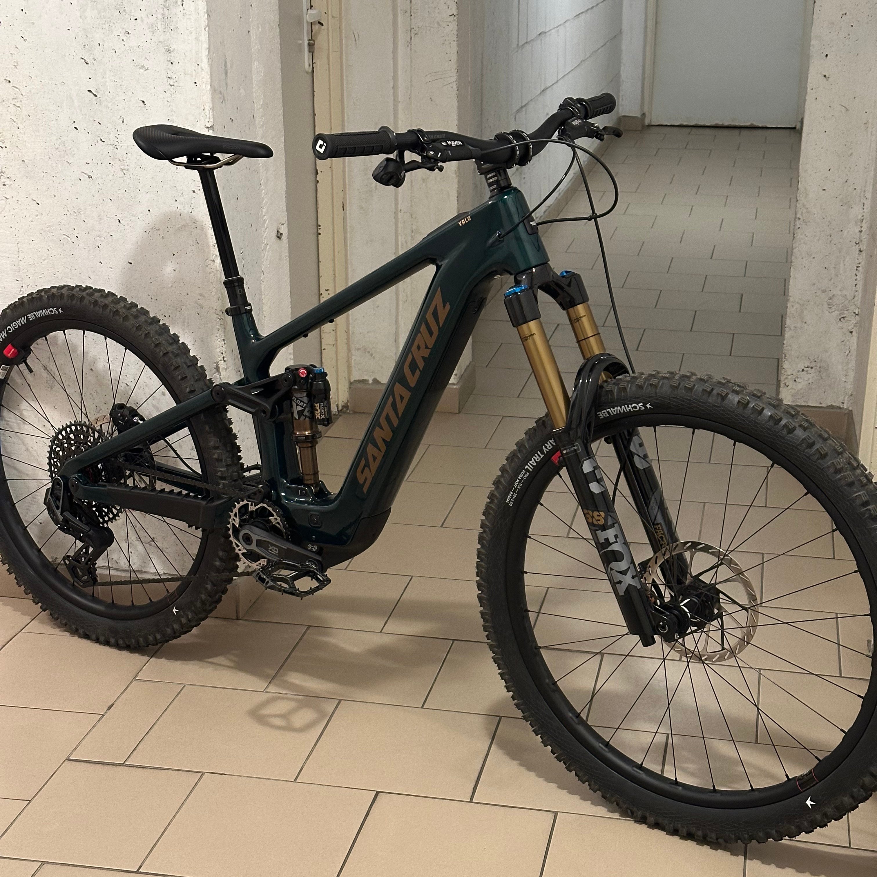

Saw my first vala in the wild yesterday . Look really nice. The linkage to the rear triangle looked low and sick. Didn’t look too chunky either like a lot of new e-bikes. Nicest looking Ebike about I reckon

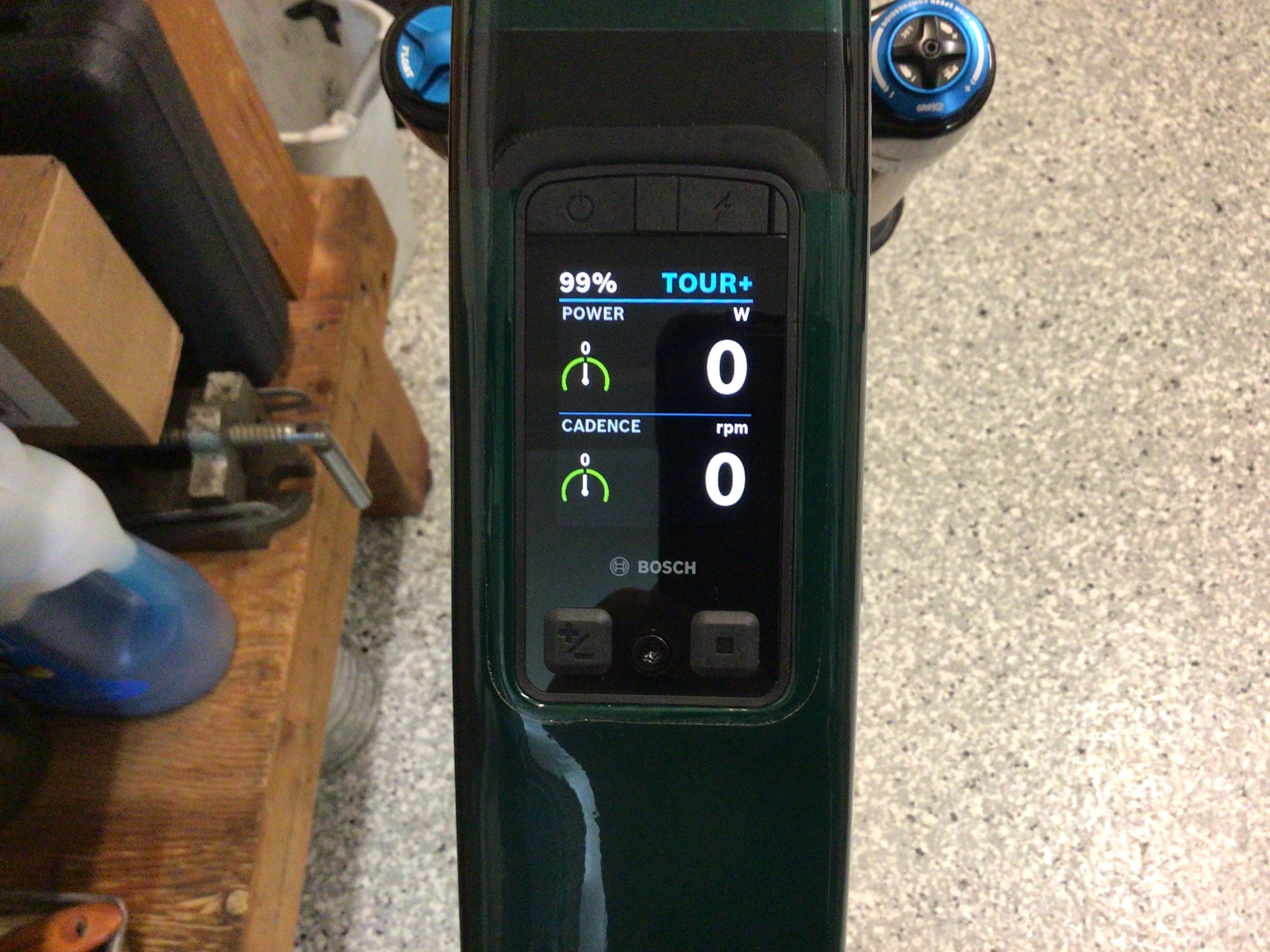

I was able to score a Kiox400c off of eBay this week. Came from Italy via FedEx. Took 4 days to arrive and no tariffs. Came in OEM packaging. Easy install. There are a couple of YT videos for installing and pairing. The remote took a few tries to get paired. The display besides looking cool adds a lot of functionality that bike computers do not offer. Haven’t ridden the bike yet. Price was $247 USD. I had seen some in the US that were $349
Thanks, I just placed an order with them. We'll see if they ship it to the USA - a lot of the European webshops won't ship Bosch stuff to the US. But I didn't see any restrictions when I checked out so fingers crossed it goes through. Price even with $34 shipping was cheaper than the place I've got one backordered on in the US.
It might take a little longer if you order from Europe.
Shipping was with DHL which is usually OK. If it was Deutsche Post I could see it taking ages. The shop I've got it backordered from in the US doesn't even have a specific availability date, just "September".

Also got mine yesterday from Bosch Kiox 400C Display Smart System
They are available at the moment.
It makes this bike complete finally :)

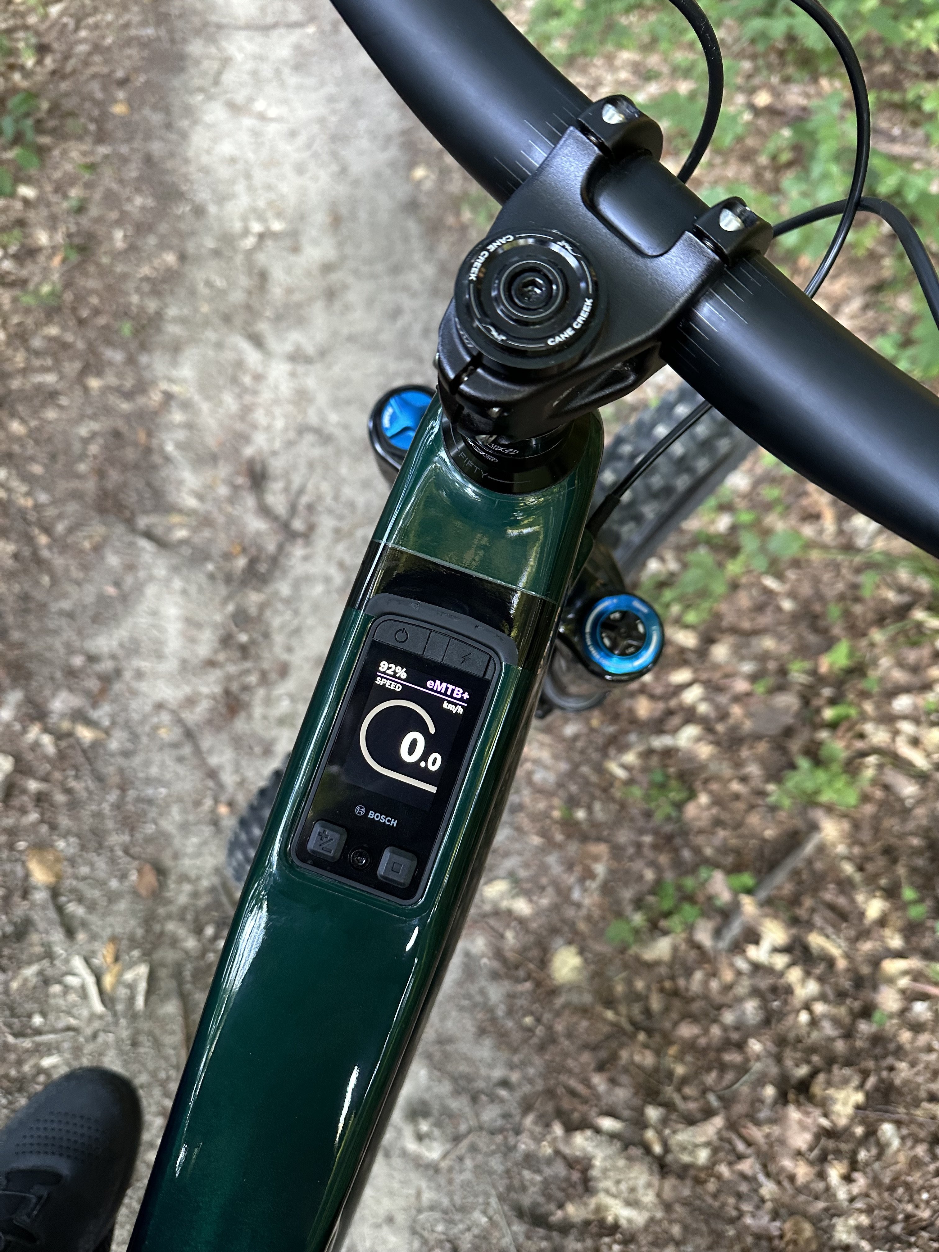

I've have also installed kashima decals to match the rest of the bike a little bit better i guess. What do you think?
View attachment 166585 View attachment 166587
Like the decals. Looks like you have a Ride Wrap also. I contacted them today to let them know they need to change their pattern around the top tube cutout with the Kiox
Decals are custom made with great local rider who cuts it to size with machine. He is truly amazing at his job.
The other kashima decals are Slick Graphics.
Sweet ride! I see you have an xx chainring.
I just ordered one too for my vala. Is yours 34 or 36 t?
I wasn’t able to find 34t anywhere so I ordered a 36t
