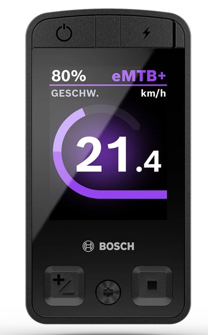

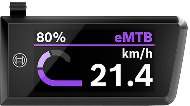

There is no Kiox 400. Do you mean a Purion 400?
Those are completely different components.
The Purion 400 is a small display that mounts behind the handlebar, has no intelligence and can only show the typical Bosch ride info. It needs another device that acts as the controller for the Bosch motor.
The Kiox 400C is a controller with integrated display that mounts in the top tube. It acts as controller and display in one unit. Can only be mounted on bikes with the correct size cutout in the top tube.

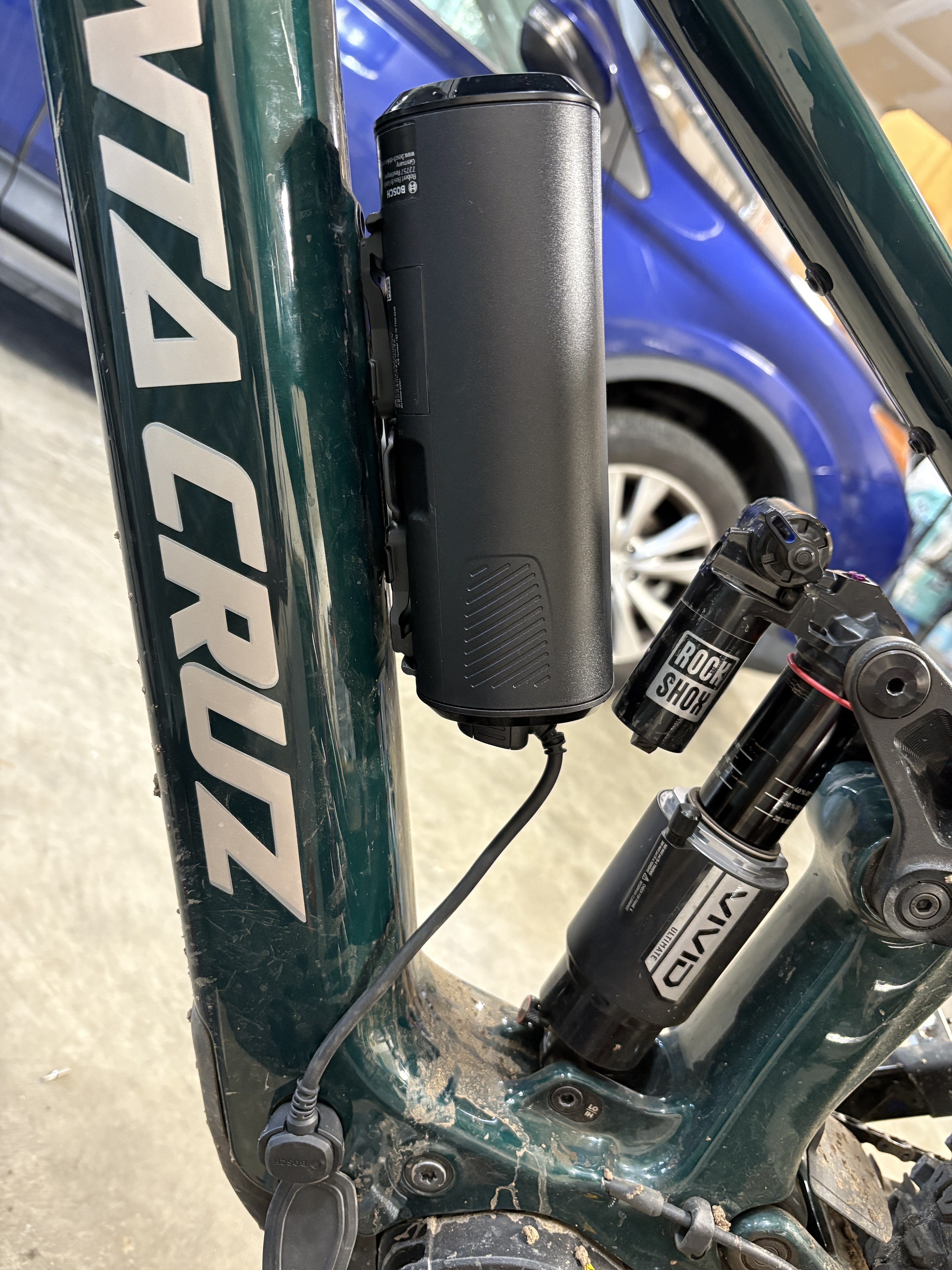

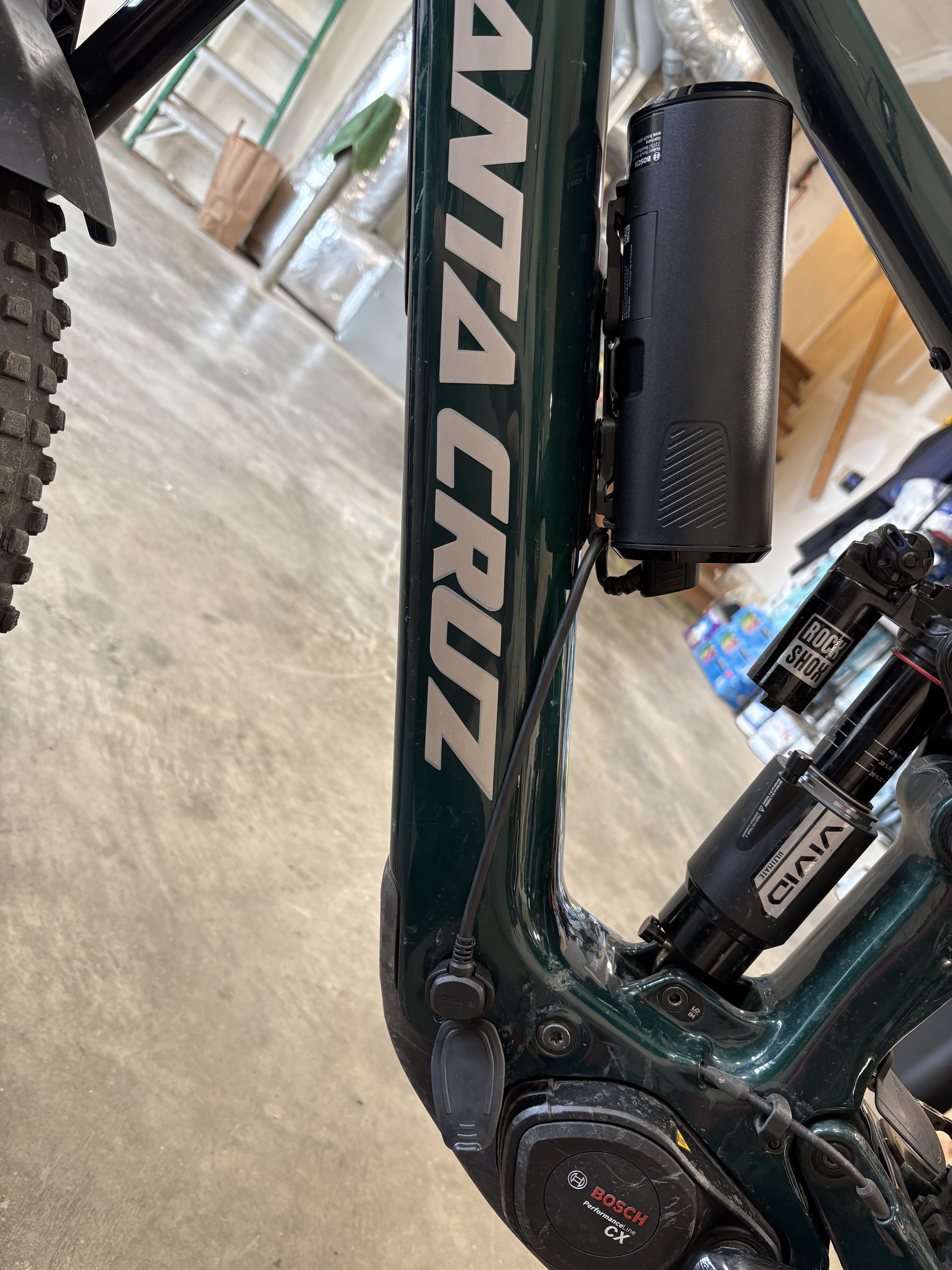

In case anyone's curious about range extender cable lengths, I recently purchased a kit with a separate 150mm cable because the shop said it would fit (despite Santa Cruz saying you definitely need 250mm). The 150 will only fit if you mount the bracket in the water bottle holes, and even then, your shock reservoir will make contact with the battery very early in travel. So get the 250 and do it right. Also, the Bosch "away from" nomenclature refers to the cable pointing up away from the bracket side of the battery, while "towards" refers to angled down towards the bracket side.
150mm (too short)
250mm with SC supplied cable clip
With the range extender should you use the higher set of screw holes or the lower set?
