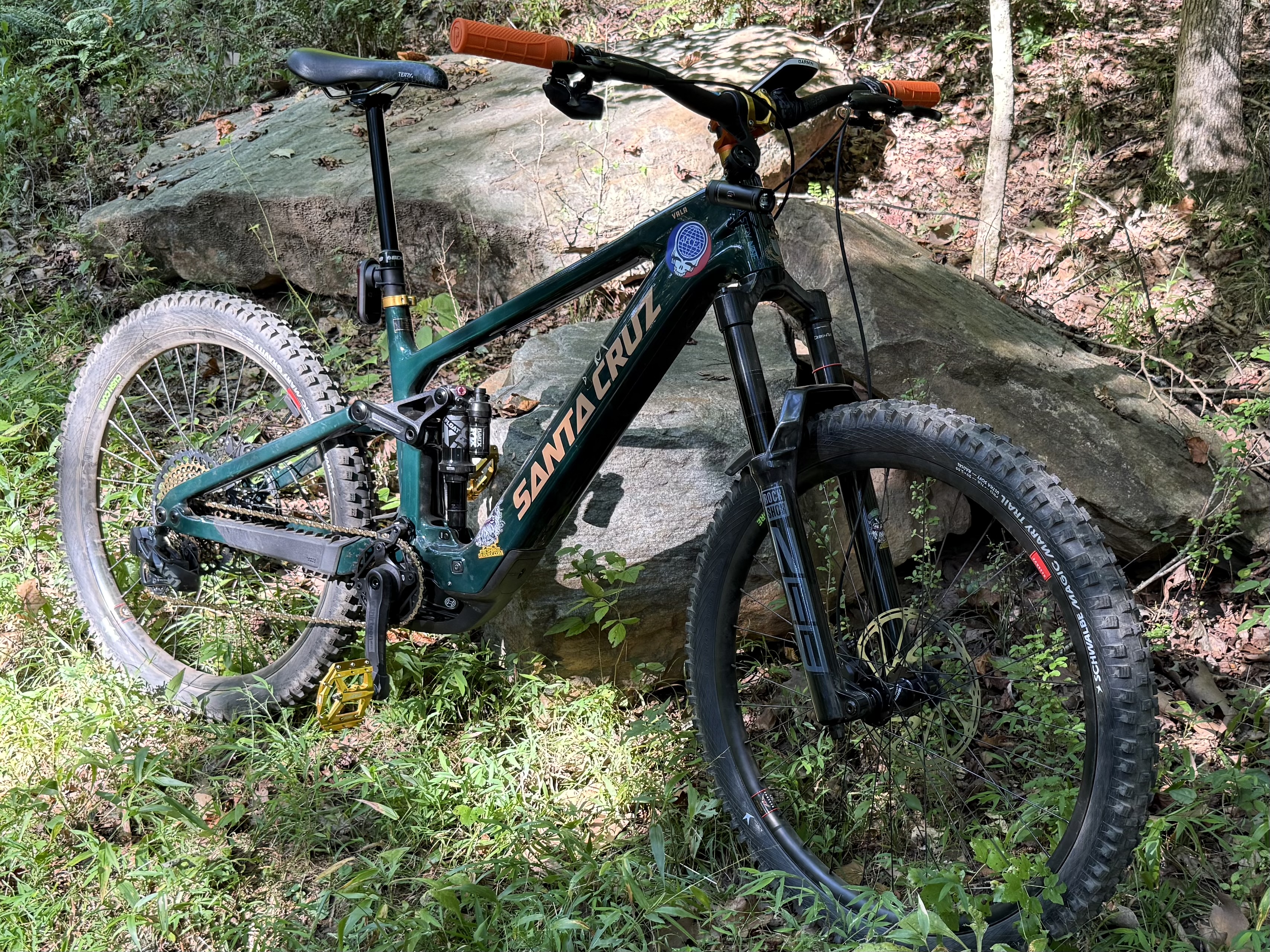

Forth week in. Was a roadie until 2018. Have not ridden since until last June when a heart condition cleared up. The motor is a game changer getting me back out and riding off road. Got the R and upgraded to X01 AXS, CK headset, etc. Waiting on wireless dropper. This day I rode 4 miles on the street to get to these trails in Alpharetta, GA hence the headlight and radar. Those come off to off-road.
On earlier post about the squeak I had that plus the elusive knock sound. I discussed this with my LBS who is a great SC dealer and avid MTB'r and he advised me to re-torqued the CX motor mounting bolts (2 of them) to 30nm. (BTW the 30mn is listed in the 'Setup and Support' section of the Vala in the exploded diagrams tab).
Mine were NOT that tight. Squeak and that knock both went away. So far haven't seen any bushing issues. I've ridden many miles on some punishing single track since in the last 2 weeks and the sound has not come back. Someone said earlier about oiling the seal on the port side which I did to no avail but the torquing silenced it that squeak.

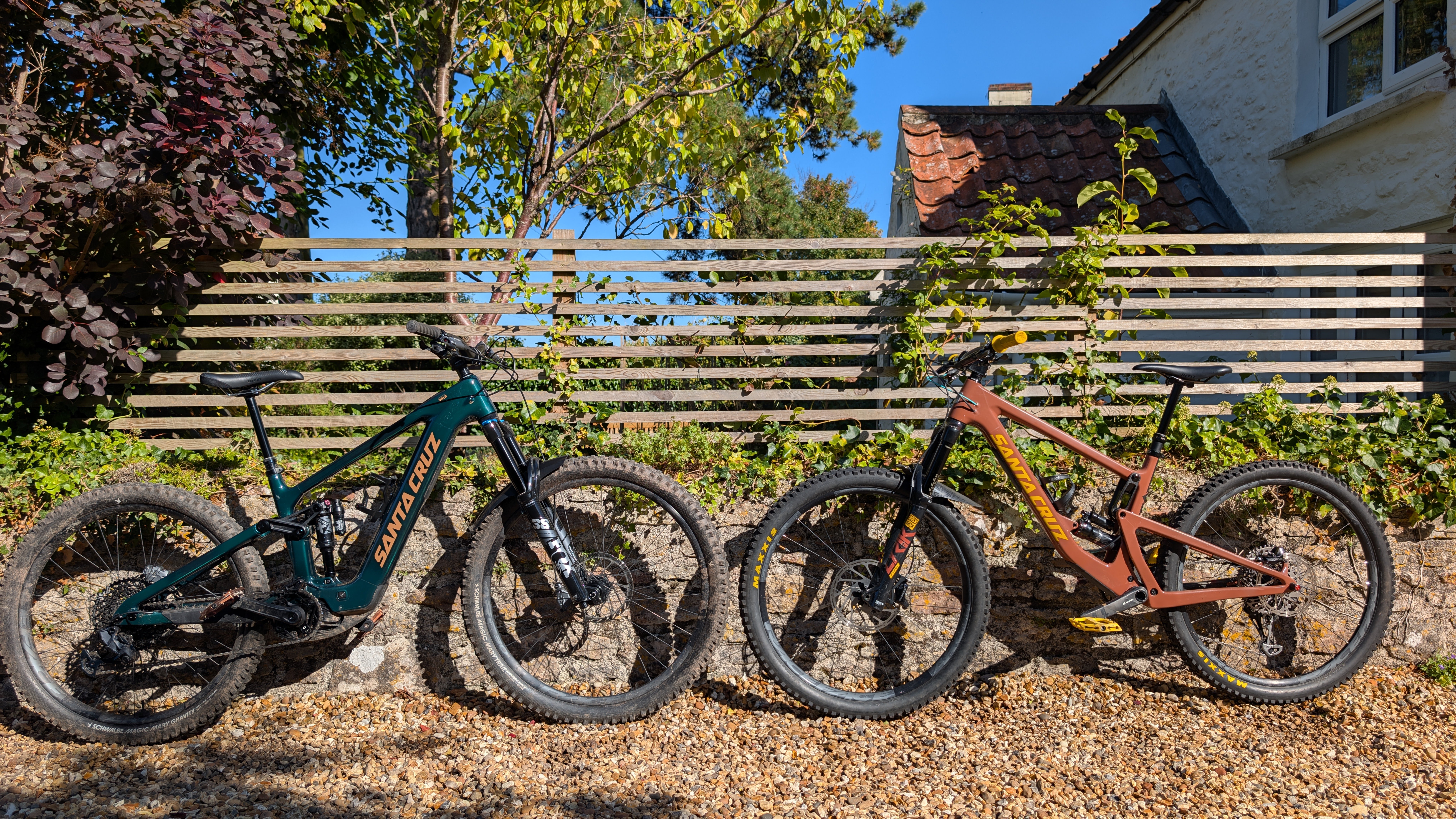

Just sold the Bronson for a Vala, they overlapped in the garage for a day!
Very different riding style but the Vala is just so much more capable. It also loses none of the playful character, even more so with the MX set up. Back wheel can get real lose but never loses control, then you're back up to do it all again in no time at all.
The Bronson danced around on top of the rough, which was great but this sits in and let's the suspension really do its job creating waaaay more grip and predictability.
In love!
In love!

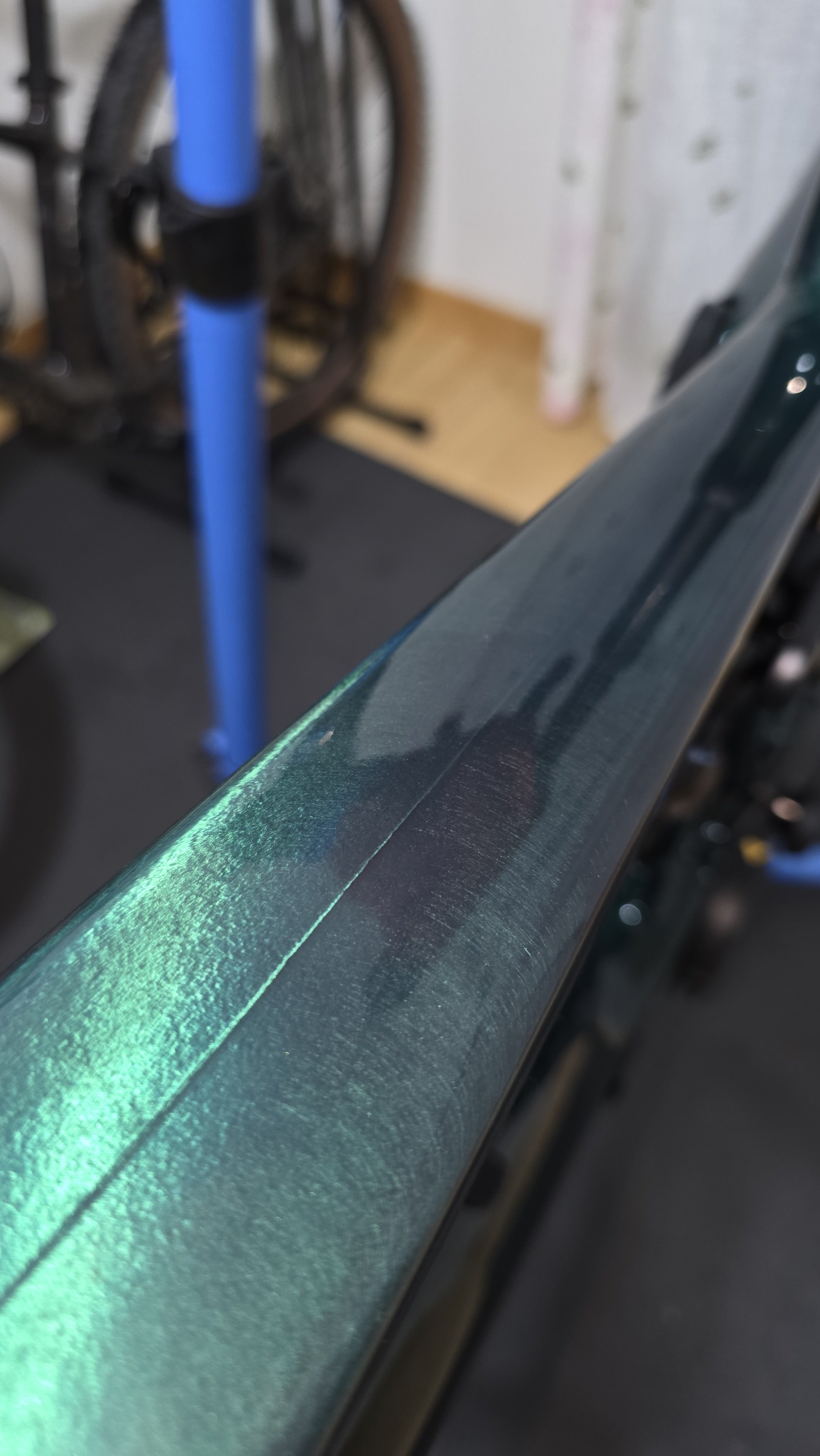

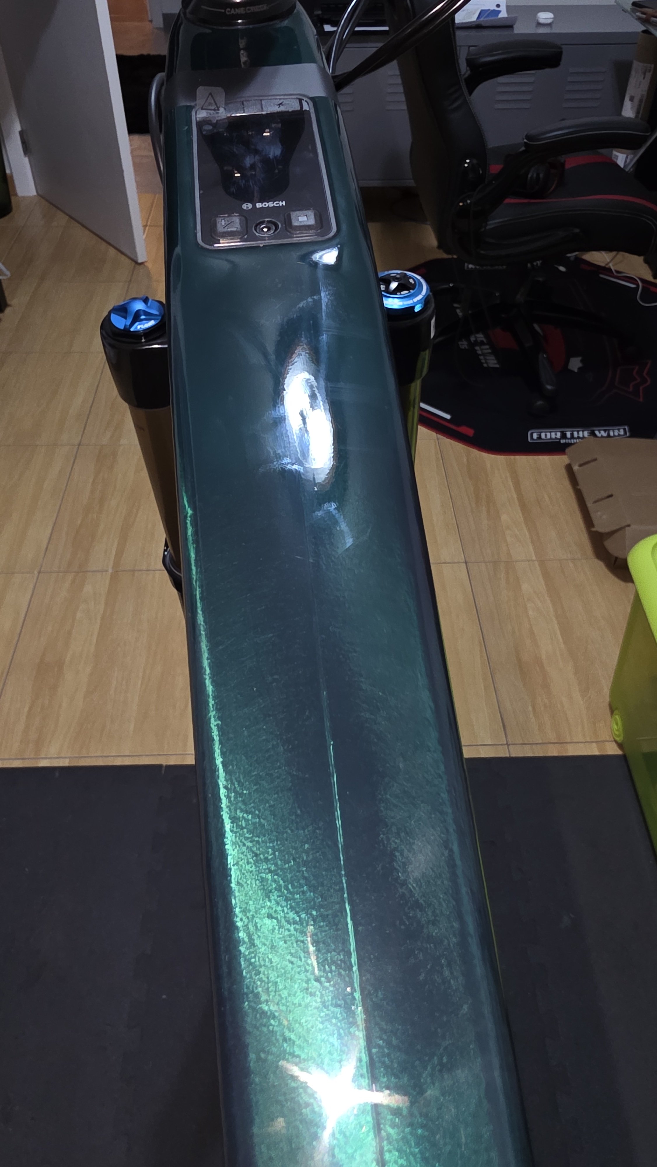

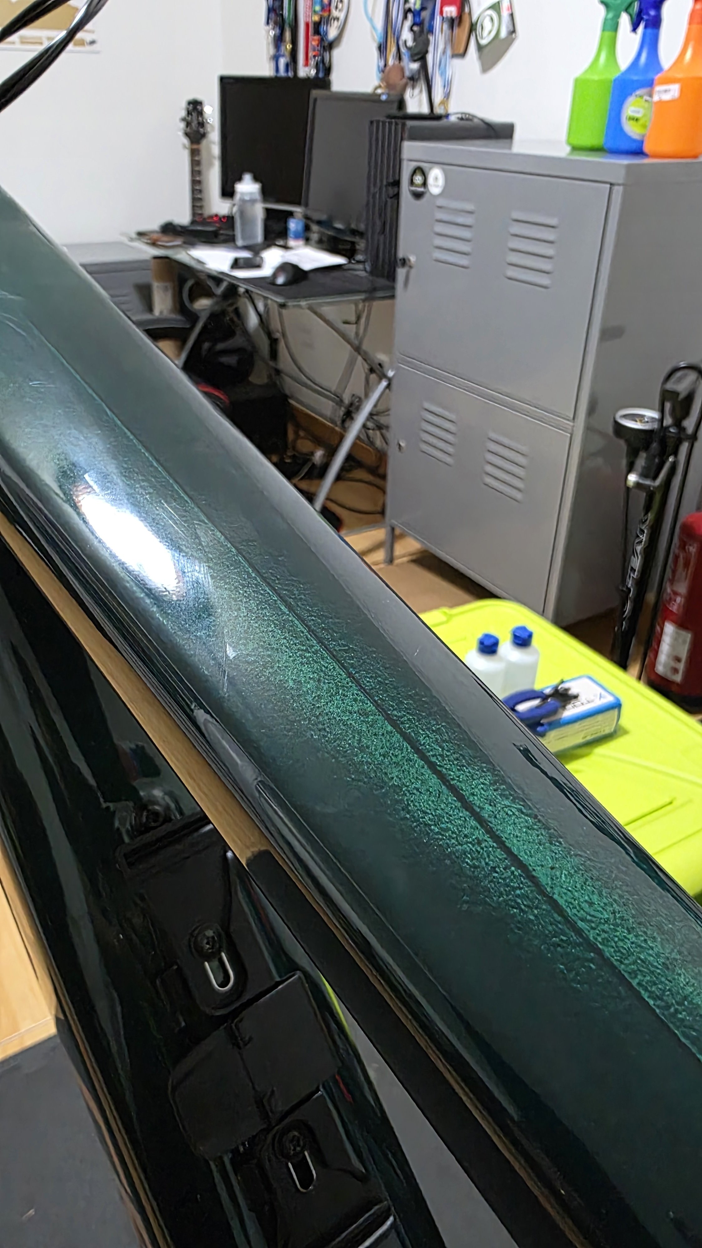

Hey guys, my Vala have a darker line in the top tube, looks line some kind of carbon layup or a paint defect...is this normal or i have to get this checked by SC?
Thanks
That's normal. Mine looks like that. It's just where the 2 halves of the frame mold butted up against each other.
