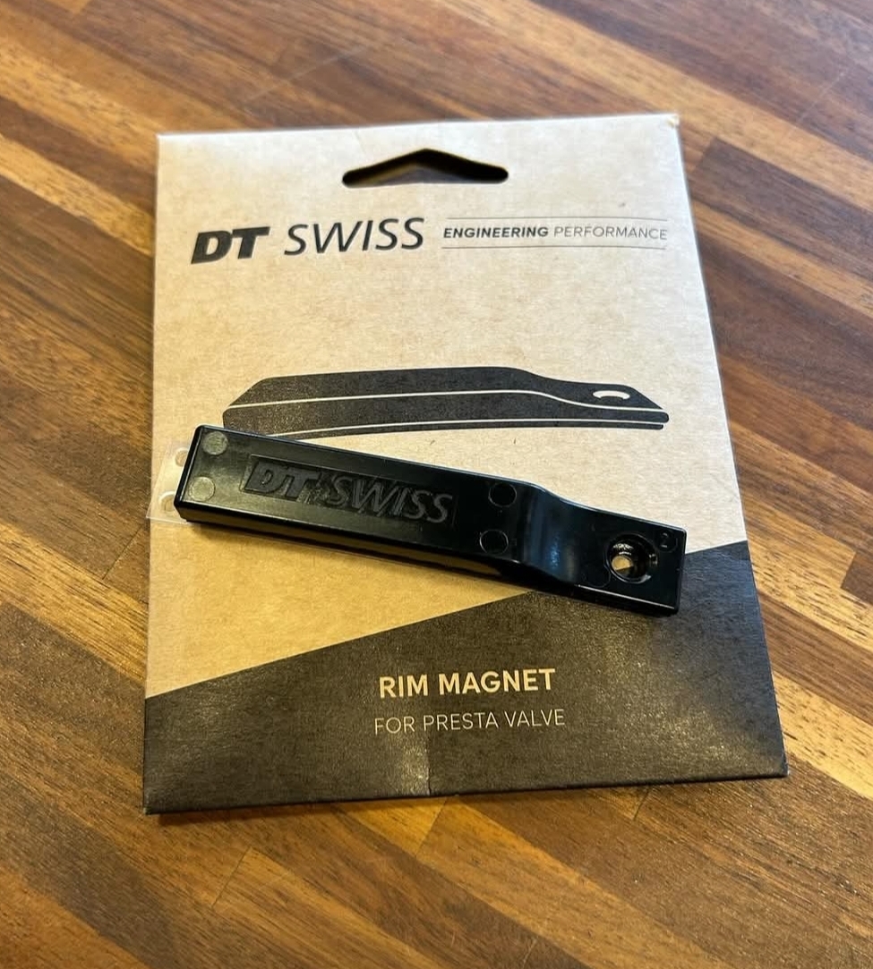

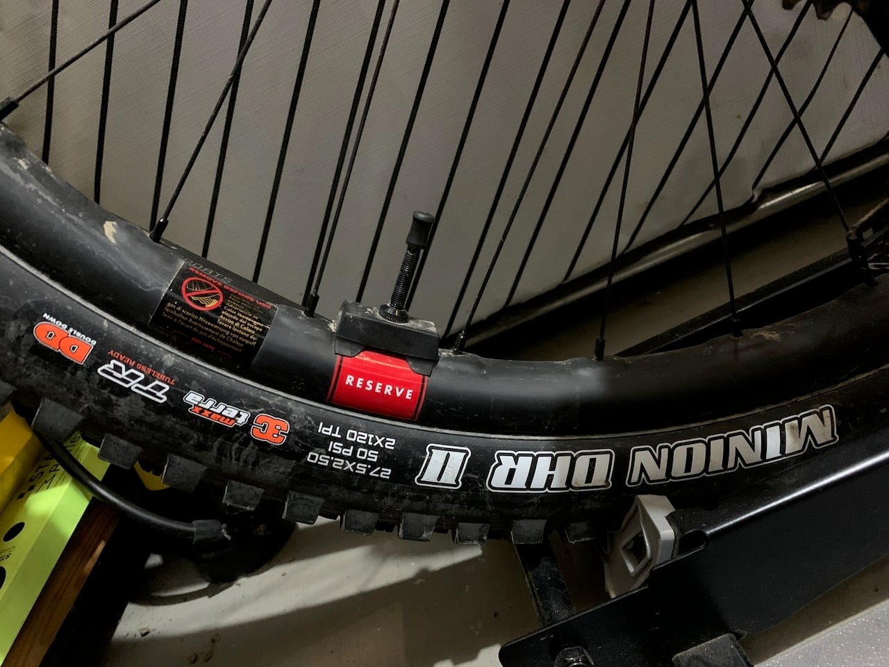

Does anyone have a pick of the location of the speed sensor magnet on the rear wheel of a Vala?
On the rotor bolt or rim valve stem?
Just trying to get ahead of what/where I'll need to move when I switch the wheelset out.

I see on page 3 of this thread that it is a valve mounted rubberized brick, presumably with flexible legs to accommodate different rim shapes. But do they come either way? :unsure:
On my Vala X0 kit there is a rim magnet installed. As far as I remember from what I have seen in the store all the Valas come with rim magnets.
The rim magnet is a standard Bosch part with a plastic housing and four flexible flaps to accommodate different rim shapes. On the photo from my Reserve carbon wheel you see a non-standard valve. I had the dealer install the new Schwalbe Clik Valve type instead of the provided Fillmore valves. I bought them in 60 mm length, but the 40 mm version would probably fit as well.

I picked up the DT Swiss magnet, goes inside the rim/tyre.
Hate the look of the regular standard magnet.
