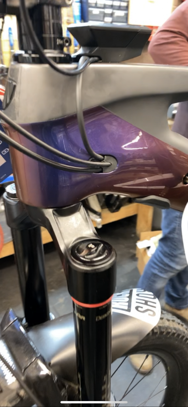

I am looking for the ZEB fork that comes on the 9.8 rail.
Anyone know where I can buy one? These are special as they have an different crown which is much wider than normal. Any help would be appreciated
RockShox ZEB Ultimate, DebonAir spring, Charger 2.1 RC2 damper, e-MTB optimzed crown, tapered steerer, 44mm offset, Boost110, 15mm Maxle Stealth, 160mm travel

So if I want to upgrade my fork on my 9.7 you dont think there is an option for that? If that is the case and that is the way it will be I just bought my first and last Trek two days ago. That is not a good business plan

that is interesting to me if I cant get the ZEBs for sure. I am going to work a bit more with these forks, but I know I will want something more. I just dont think I will like the look of it if I get a fork with a regular crown. I see some have done it as they do fit, but the frame is wider so it has some overhang which probably only hinders the aesthetics. Thanks for your input.

Well sure, you can buy any (available) new fork you want - Rockshox will happily sell you a Zeb, just not the exact same model that came with the Rail.
but the problem is with the way it looks. I dont need that model, just need that top crown. If ya have a rail, you know what I mean. The bottom of the steer tube is much wider than any other bike I've seen. Know what I mean?

Do you have a rail? If ya do, you will see that what Trek is calling an Ebike optimized fork or something like that means that the frame is much wider and they put a fork on it with a really fat crown. its not a standard crown.

The crown diameter difference between the emtb and non emtb zeb is barely noticeable on the bike.
i didn’t let that turn me off my zeb ultimate purchase. Way stiffer than the lyrik/yari chassis.

Thats a good testimony, any way you can take a picture of it??? Thank you!

Correct, it does not have the ZEB, but it does have the Rockshox with the same funky crown. Make sense? The frames are the same on the 9.7 to 9.9.
So TREK managed to run the SAME "funky crown" on both a 35mm and 38mm stanchion fork?
Make sense?
No
Either way, you don't need a funky crown.
Rockshox' ZEB Emtb fork is actually the worst fork in the ZEB line up so just buy a normal one

I have the aftermarket Zeb without the thicker crown. It doesn’t look quite as neat as the one that comes stock but I forgot about it quite quickly.
I contacted RockShox about it already, they mention that it is only aesthetically different, no performance increases on the Trek Zeb specific one.

I think he means it's the same 'funky' crown as in the special wider diameter of the OE Trek crowns around the steerer where it meets the oversized Rail headtube ... so in context it's fair to say it's the same 'funky crown' on the 35mm and 38mm.
I'm pretty sure the 'funky crown' is not found on the worst in the line up Zeb "Emtb" fork that is available after market anyway ... that also doesn't have the funky oversize crown that Trek are using OE.
So to avoid confusion (or add to it if I am wrong) I think there are 3 forks / crowns being referred to ...
1 : The OE Trek specific 'funky' crown... OE only and oversized around the steerer to match the fat Rail headtube.
2: Standard ... standard crown a bit smaller than the OE oversize funky one but fits fine and looks OK.
3: "EMTB version" ... probly on some bikes OE and also available after market... softer tune ? ... maybe slightly thicker crown (maybe not) but not the same oversize around the steerer as the OE Trek one.
I believe that there may be a Trek Specific CSU (the holy funky crown?) available as a part ... but sounds like an expensive faff to buy the whole upper just to get the funk.
Maybe it’s just me, but I took the stock fork off my Rail & put a different make on, without the weird big stepped crown, and haven’t ever looked at it again.
total non issue.
