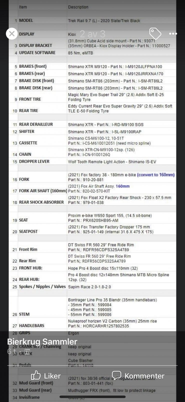

If you want Fox 38 with big crown a guy on facebook in the Treck ownersthread has the partnumer. This was a fork that did not exist.

I don't think that Fox 38 910-20-881 you mention has the oversized crown diameter at the steerer / headtube like the Trek OE forks either... it's the Ebike+ version of the Fox 38. I suspect the crown diameter may even be a few mm smaller than the regular Zeb if anything.

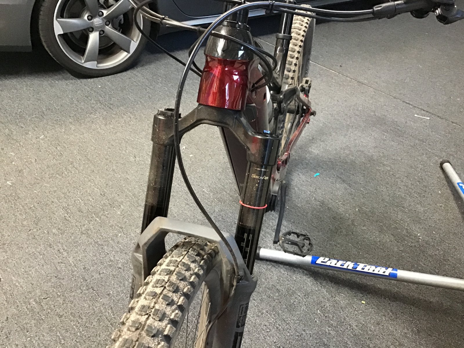

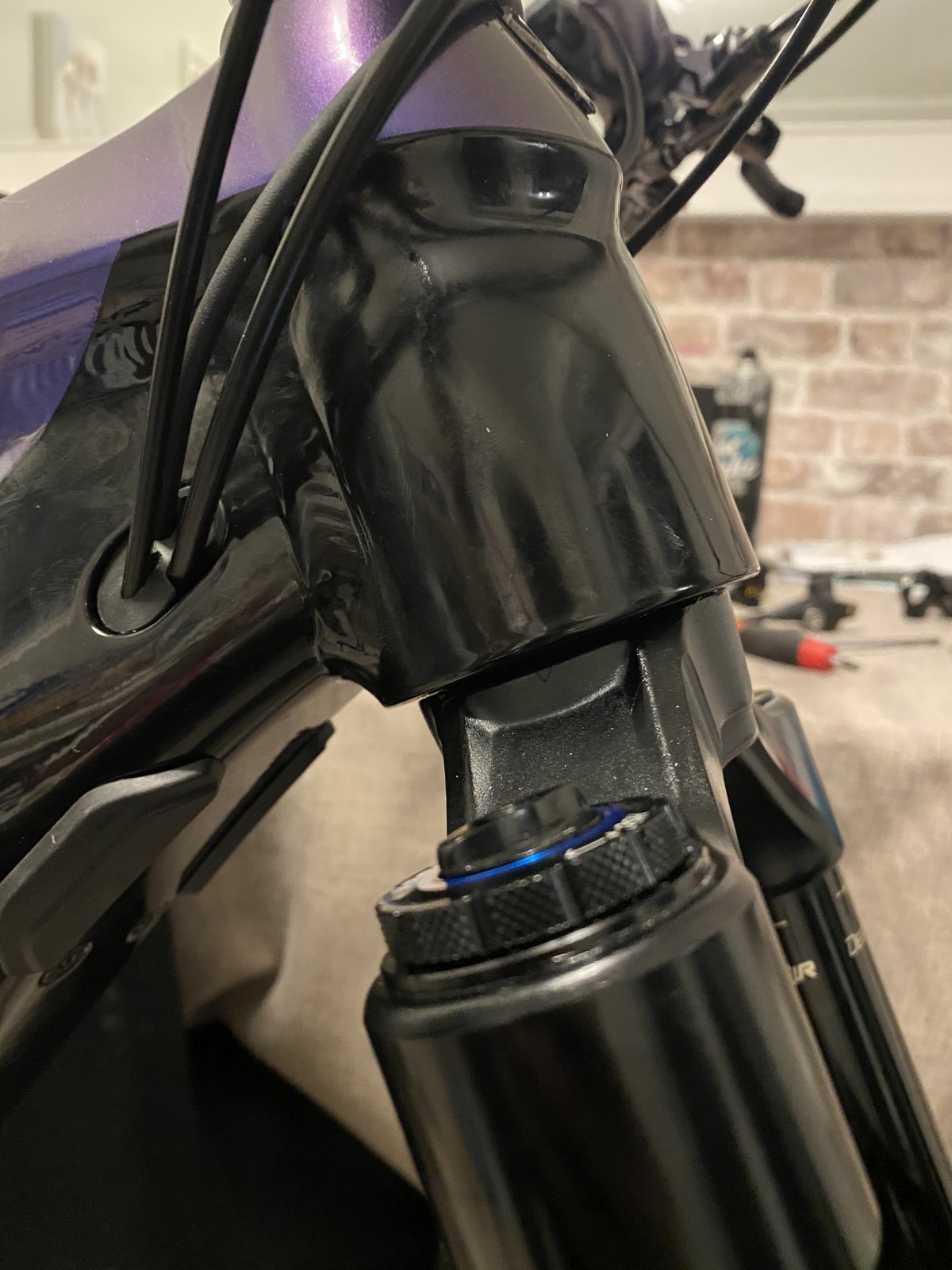

Here is a picture I found on another post showing how the fork has a smaller crown which does not blend in size wise with the frame. As you can see, the crown of this fork is smaller. The OEM forks on the Trek rails are larger and they blend in with the frame.
I own same beauty fault in my Rail 5 as I changed OEM Rockshox Gold 35RL to Cane Creek Helm MK1 Coil. The 35RL protected the headset bearing better as the crown was wider.
Correct, not a ZEB, but the same appearance. Small crown equals this appearance on the Rail Frame.
Yes but the Zeb has a bigger crown anyway that the Yari/Lyric - on my bike I had the opposite worry when fitting a Zeb that the crown would be bigger than the head tube - I really doubt you would notice anything.

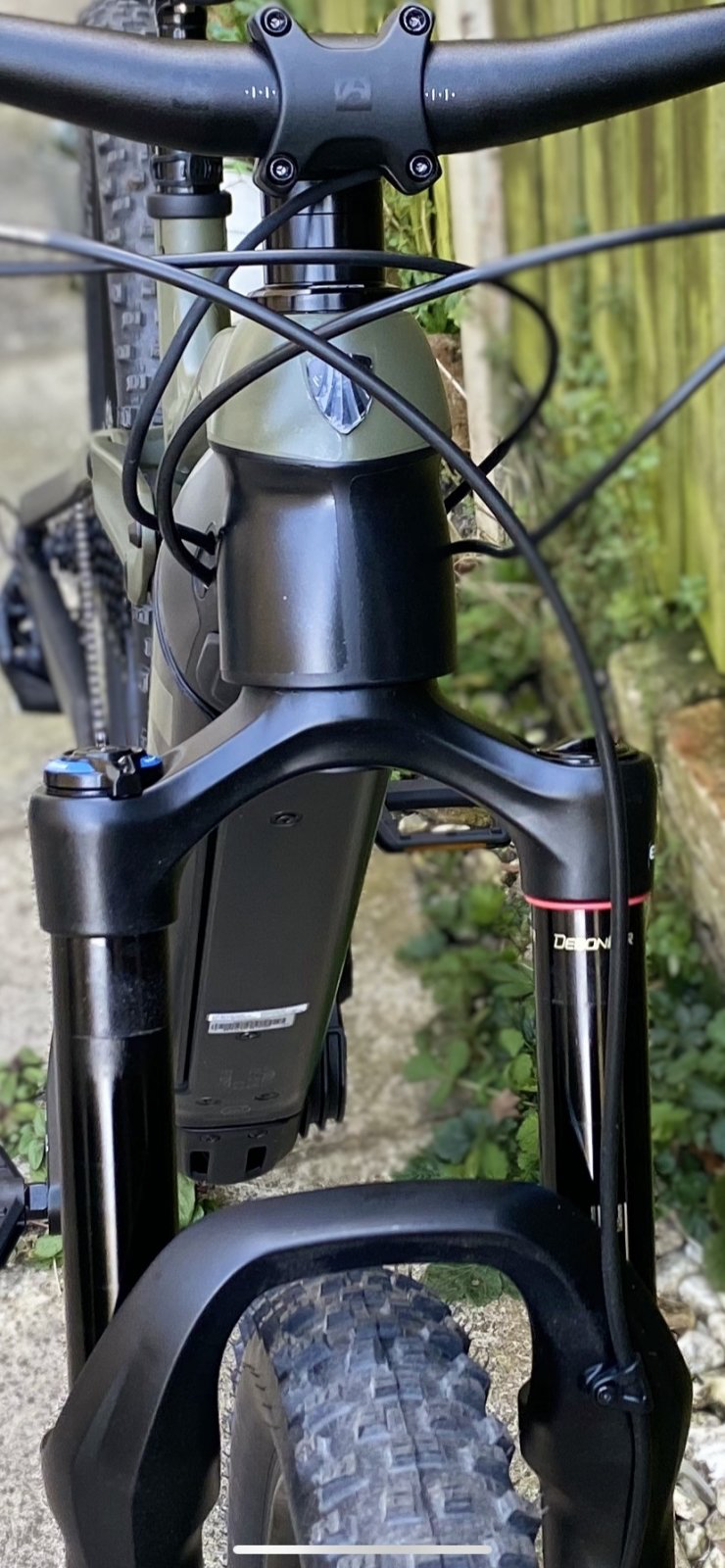

Trek Rail headtube
Trek OEM RockShox 35 crown vs regular Zeb crown (notice the difference in size
Trek with Zeb installed
Original OEM Trek with RockShox fat crown

Trek Rail headtube
really good pics Rob. I was hoping you'd post pics of yours up close. Like another contributor commented, do you feel that it could enable entry of foreign material to the headset enough that it should even be a worry about premature wear etc?
My thoughts are that the crown size has no benefit for protection from water on the bottom bearing. There could be a slight advantage of the larger crown for keeping particles from making contact but I think it’s minimal. The bearings included with the Knock Block headset are not great. Regardless of the crown size, a move to replace the bearings with ones with full seals and stainless steel races would be the right way to go in my opinion.
