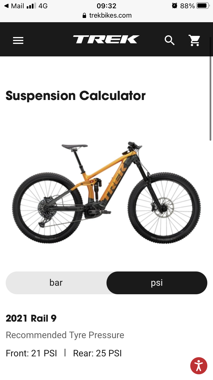

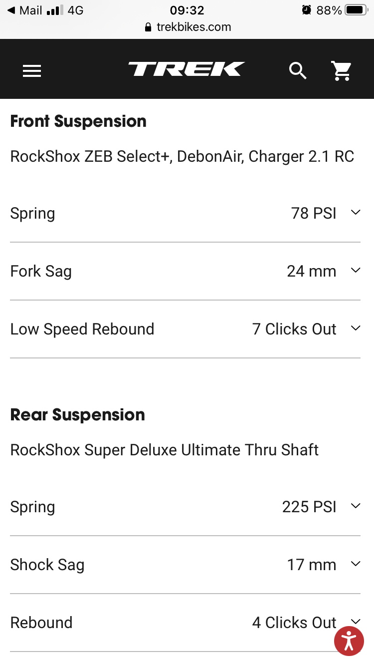

Did your friend use the online setup guide from trek website?
putting a 80kg rider weight in, these are the start points recommended:
