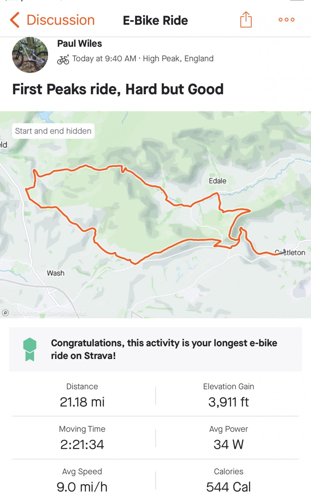

New to the forum, and to eMTB not to giant though my first Giant was a 1998 ATX-970 which i still own :), Had the Reign E+3 about 2 weeks now, had some of the normal issues, dented a rim, loose bolts, low power numbers between it and my garmin (which is how i found this thread) but love the bike I have come from a much shorter and livelier bike to this monster and love it. Only change the cockpit the brake levers were swapped out for some old 1 finger deore which work really well, the bars have changed for a 39mm rise nukeproof cut down to 750 the above was to get rid of some hand/thump pain i was getting which is now hopefully sorted.
Had some good rides so far, best one was this weekend, my first peaks ride with a couple of other eBs, still had 25% battery left so should be able to get 1500m plus if im careful.

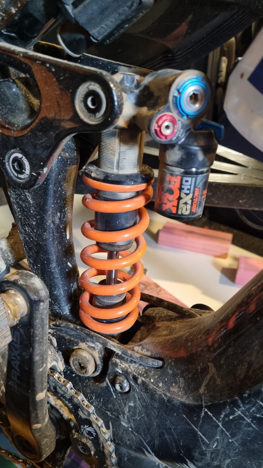

I have a fox dhx 2 coil factory edition.
Exactly same measurement as original shock.
I do not experience a lot of pedal strike in low position as described in this forum on many occasions so suspect it makes bike sit higher in its travel... Either that or the fact I've come from downhill bikes that are low anyway...
