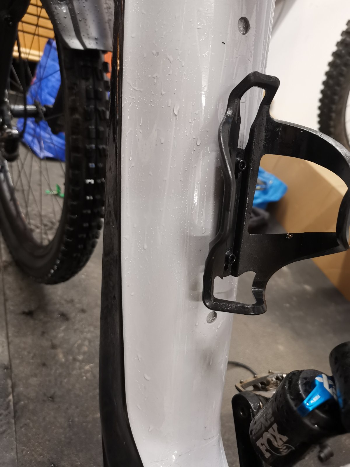

What goes in the holes to blank them off where the range extender fits?
Just given the bike it's first wash after the weekend and whatever was in them isn't there anymore šŸ¤”
Luckily I had put some foam under the cables under the battery to stop then rattling this kept the worst of the water out of the battery compartment.

There are 2 rubber plugs in these holes, looks like the foam you've put in place may have pushed them out.
Cheers
I did wonder that, I'll have a look on the garage floor šŸ¤¦šŸ»ā€ā™‚ļø, I've only just put the foam in before it's wash.

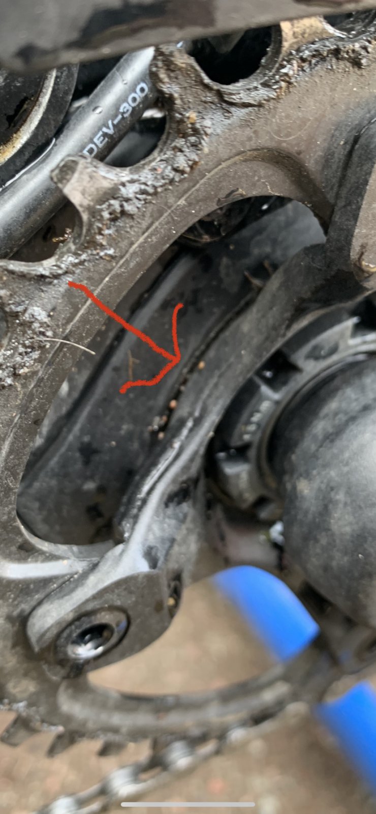

Anyone else have a clearance issue? The ring touches the plastic and create a grinding noise. Feels lite the hole is not centered.

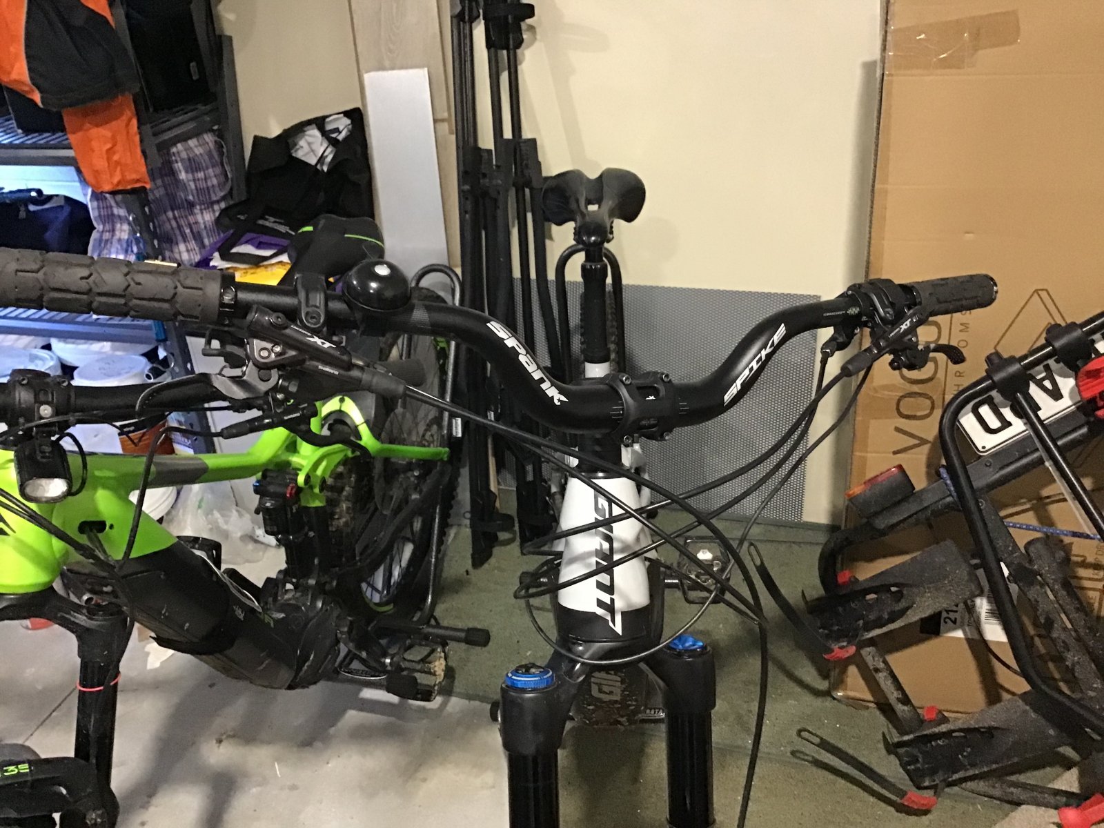

Not too sure of the look but first impressions they feel good Spank Spike 60mm rise. Hope to try them out proper tomorrow.
I had the same bars on my 2020 Trance E which helped a lot with back pain. So far, I donā€™t need risers on the Reign which has better geo and overall comfortable riding position for me.
Whatever works for you to keep riding! šŸ‘

First ride with Spank Spike 60mm rise bars. Not so keen on the look but felt great. Faster everywhere according to Strava but had to be a bit more careful on the uphills.
