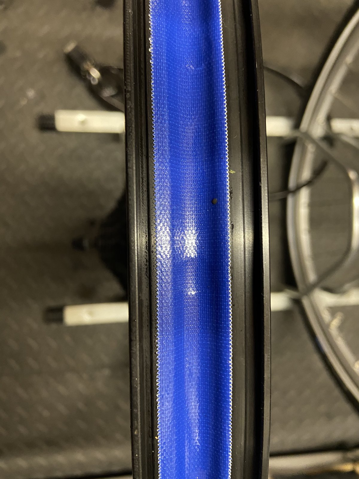

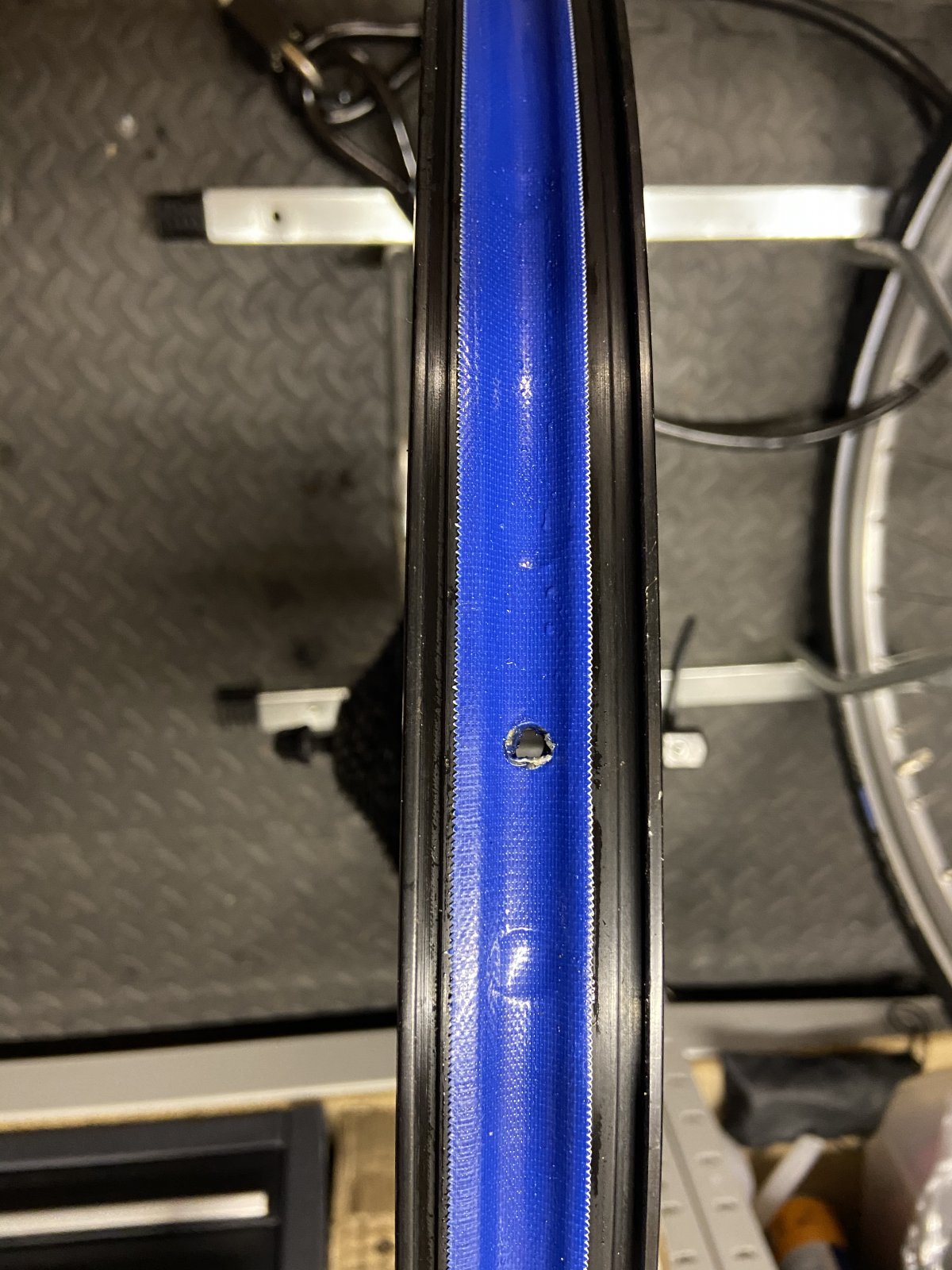

Me again. Can you tell by looking at photo if these are tubeless ready as this is the rim tape as stock standard.

Sorry to say, but in my opinion the blue tape as fitted is NOT quite ready for tubeless.
The sealant will get underneath the edges and leak out. The tape needs to go from edge to edge inside the rim. The tyre then seals against the tape trapping the sealant in (simplified but you get the idea)
I'd pull all that off and start from scratch.

For what it's worth, I bet that blue tape works fine

Yeah I was thinking the same thing and get new rim tape of the correct width for your rims. Muc Off do them.

Rim tape should be fine, my gorilla tape covers roughly the same amount of surface area and is fine. With that said I do find it never holds up and needs to replaced if I ever remove the tyre.

I think that blue tape is ok. It sounds like like you just need a compressor or air tank both of which can deliver a high volume of air in a short time. With a track pump you are leaking as much air as you pump. Even with an air tank it is best to remove the valve core. Air tanks come equipped to connect to prestatyn valves. A garage service will likely only be shraeder

We update everyone. Removed tube, inserted tubeless valve, used the stock tape on rim. After several attempts I could not get the tyre to seal on the rims. I tried my local Halfords thinking they could help with seating the tyre.....hopeless as they couldn’t manage it either. I then went a LBS where they told me my stock schwable smart sams were not tubeless tyres ?. So I ended up buying a set of Pirelli Scorpions which the LBS fitted them and also filled with sealant.
The stock rim tape was okay but tyres were not.

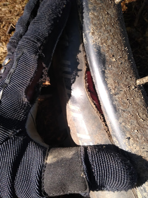

Guess what...I went back to tubes...with Tannus armour. Try re-inflating your tubeless tyre with a dinged rim or ripped sidewall? With Tannus I had a side wall split and didn't even loose any air - continued my ride as normal! Amazing! And that dinged rim I couldn't use with a tubeless setup - no problem with Tannus! Is a slightly more difficult to fit than just an inner tube but that's the only downside. Once fitted - forget and run pressures as low as you like!
High Rock Ruti
Wow split tire and glove, did they fail on the same obstacle?
