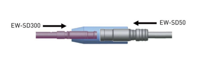

Thanks for this! I did look into this, but the SM-PCE02 does not have a E-tube port connector, so I think I have to drop the motor to plug it in. I've read somewhere that there is an adapter that can be plugged into the E-tube port wire that connects to the Shimano EW-EN100 Junction, which is near the handlebar. If this is correct, then I wouldn't have to drop the motor. Trying to find a shop near me that may have the SM-PCE02, so far no luck.
Shjay
Apr 30, 2019
835
488
Kent
You can’t plug the PCE02 into the EP8 motor as they are the smaller fitments, you can on the E7000 & E8000!
I used an SMJC-41 to plug the PCE02 into with an extra cable
Dirtyrig
Dec 26, 2021
44
8
New York
Yes!! This is what I was looking for. So I assume I can just unplug the wire coming from the motor that goes into the Shimano EW-EN100 Junction then plug it into the SMJC-41 then to the PCE02?
Funks
Oct 8, 2021
82
48
Dublin, CA
Yes 👍🏼 So need
PCE02
SMJC-41
1 EW-SD50 wire
There a reason why the SMJC-41 is needed? Can't use just use an EW-AD305 conversion adapter instead?
If one wanted to drop the motor - hook up the COMPUTER -> PCE02 (has an EW-SD50 cable end) -> EW-AD305 adapter -> EW-SD300 cable -> EP8 Motor.
For the Rise's that came with the EW-EN100, I'm assuming one can disconnect the SW-E7000-L (switch) from the EW-EN100, then
COMPUTER -> PCE02 (has an EW-SD50 cable end) -> EW-EN100 -> EP8 Motor
My H30 came with the SC-E7000 Display, and it has a couple of extra ports (so no need to disconnect the switch).
COMPUTER -> PCE02 (has an EW-SD50 cable end) -> SC-E7000 -> EP8 Motor
My H30 came with the SC-E7000 Display, pretty sure I can just unplug the SW-E7000-L (switch) from the SC-E7000, then

If it comes with the SC-E7000 display then plug the PCE02 straight into the display otherwise you need the SMJC-41 junction box otherwise if plug into motor it will only bring motor up on diagnostics, same as Di2 you don’t plug directly into shifter or rear derailleur unless your running diagnostics solely on that part! Need junction box & extra cable to run diagnostics on whole bike! Hope makes sense
Funks
Oct 8, 2021
82
48
Dublin, CA
The use-case here is how to re-flash the motor (and not really diagnostics of the entire system). Additionally, it's about the Orbea rise as well, so rear derailleurs and other components are not relevant.
For most rise users (who have the carbon, or the alloy version) - the only thing they really need is PCE02 (and nothing else), and the procedure is basically to unplug the SW-E7000-L switch from either EW-EN1000, then plug the PCE02 to where you unplugged the switch. If you have the SC-E7000, then plug in the PCE02 onto any of the extra ports on the SC-E7000 (no need to disconnect the switch). Basically, there's no no need to take out the motor, or the fork out.
Before buying a PCE02 though, might be a good idea to drop the motor, disconnect the power cable to the motor (give it a minute or so), then plug it back in and see if the motor gets out of firmware update mode and boots up with the old one. This time, try the flash again with the phone and making sure you are in airplane mode before doing so.
