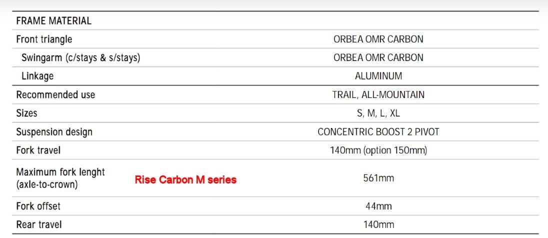

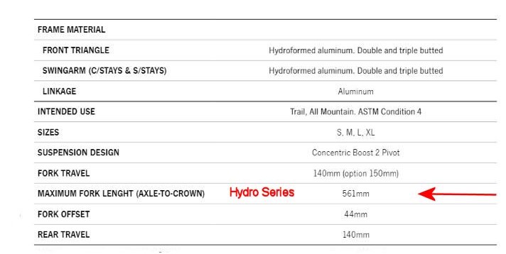

If you check the Orbea Blue Paper for the Rise, you'll see that Orbea sets a maximum Axle to Crown length on both the M and H series Rises at 561mm. I'm not an engineer, but I'm guessing that extending the travel on the front fork beyond the 561mm limit, probably puts excessive stress on the head tube and voids the warranty. Fortunately, Orbea has extended the limit. When the Rise first came out, the limit was much less.
Rise Hydro maximum axle to crown length
Rise Carbon maximum axle to crown length

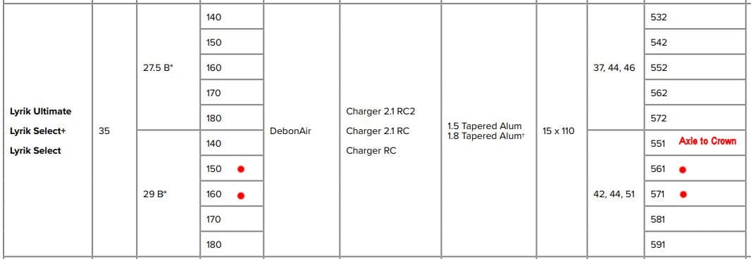

My buddy has a Rockshox Lyric 160mm on his Rise. He is a much lighter rider and very fast. I tend to think the Lyric offers the best of both worlds when it comes to "Super Light Ebikes." With the Lyric you get a lighter fork with 35mm stanchions and the Lyric Ultimate with buttercups is a brilliant performing fork. The drawback to the Lyric is it might be a bit flexy for a heavier weight rider in the chunk. The Fox 36 with it's 36 millimeter stanchions is slightly stiffer.
You have a choice of going with a 150mm Lyric fork at a 561mm and staying within standards or go big with a 160mm Lyric and potentially void the warranty with the 572mm axle to crown length.
Rockshox Lyric Specification - Axle to Crown Length

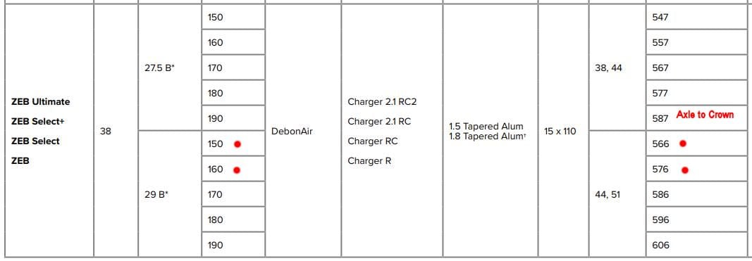

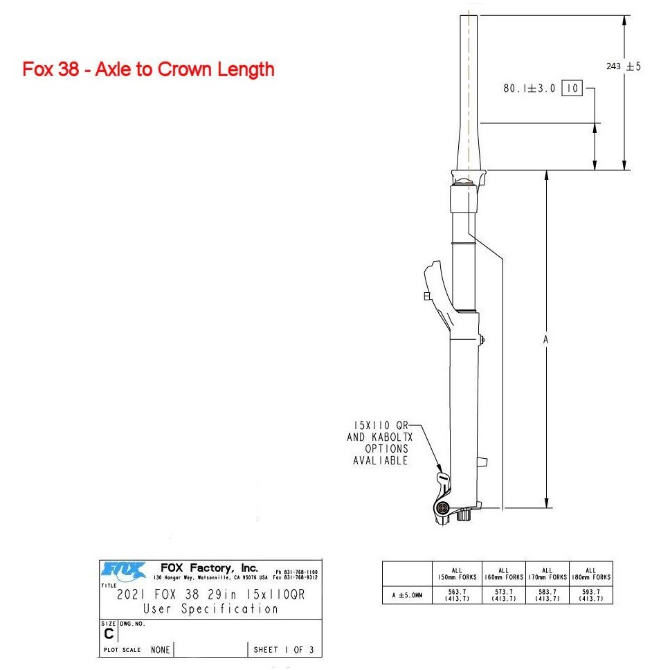

With your weight and also mine, I think we benefit from a stiffer fork such as the ZEB or Fox 38. I would suggest going to Pro Bike Supply in Newport Beach. Pro Bike supply has a large rental fleet of eBikes with various grades of suspension. A new fork is an expensive proposition and you don't want to donate your hard earned cash only to realize you bought the wrong fork. Demo a ZEB or Fox 38 and see if you like it.
I have a Rockshox ZEB Ultimate 170mm on my current eBike (Levo). The ZEB is a really good fork. The Fox 38 is also extremely good, you can't go wrong with either fork. I will say this, the Rockshox's tuning manual and phone "Trail App" tuning guide for the ZEB RC3 Ultimate sucks....I hope you're reading this Rockshox.
Unfortunately, the ZEB and Fox 38 conflict with Orbea's Axle to Crown Length standards. If you want to use either one of these forks you'll have to play it a little loose with maximum length standard.
This is my own opinion and it doesn't mean much....I'm of the opinion that modern bike frames have enough of a built in safety margin that unless your hucking your Rise off 10 foot drops and 15 foot gap jumps, you'll be fine. Here's a picture of my friend Noah with his H30, it wasn't quite 15 feet so he was okay.
Rockshox ZEB Specification - Axle to Crown Length
Fox 38 Specification - Axle to Crown Length
