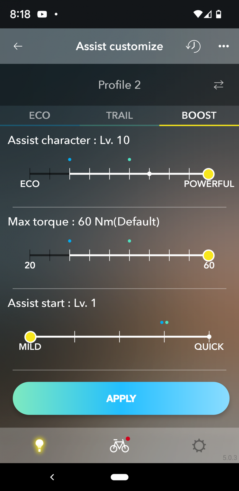

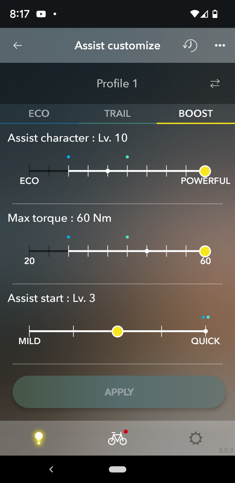

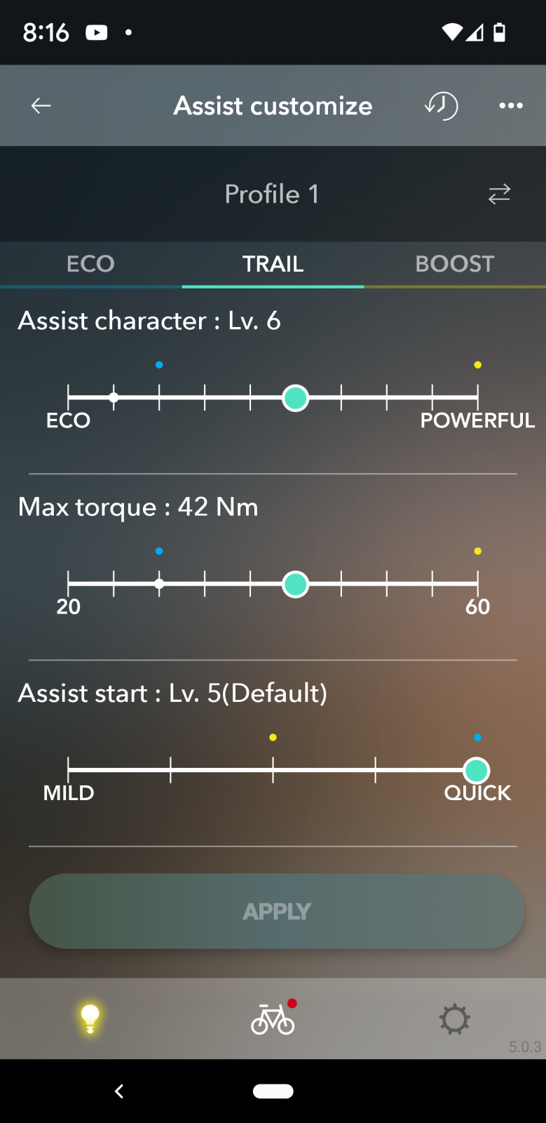

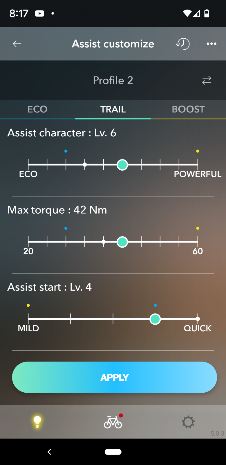

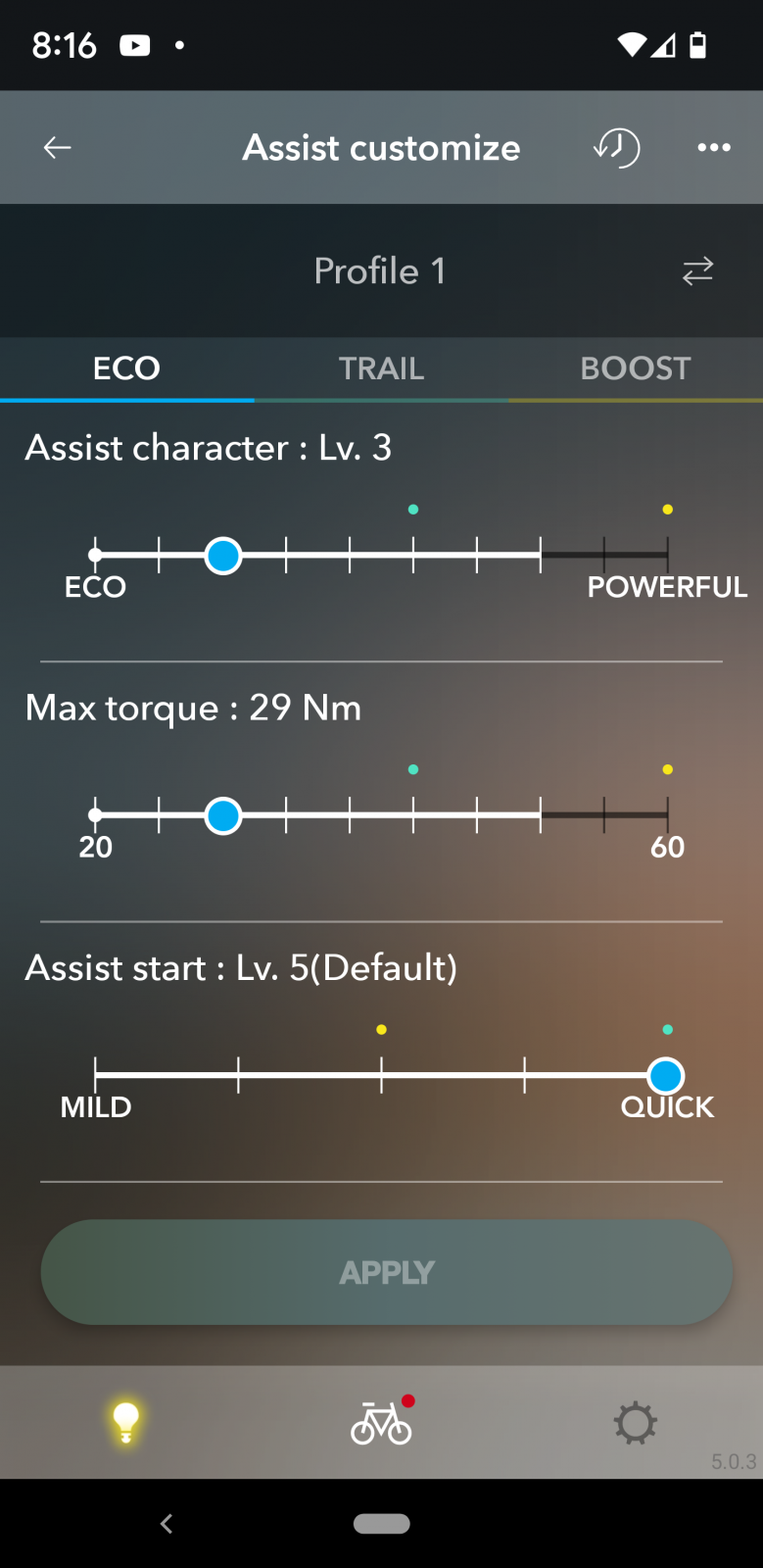

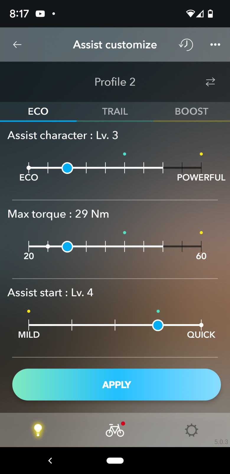

Hi thanks a lot for those screens. I am also running the standard EP8 firmware having updated at least three versions with the ETUBE app.
I have used that information to set profile one as standard and using profile 2 to take advantage of the extra power. On my M10 i have not experienced any of the problems that some have reported with vibration at low battery levels.

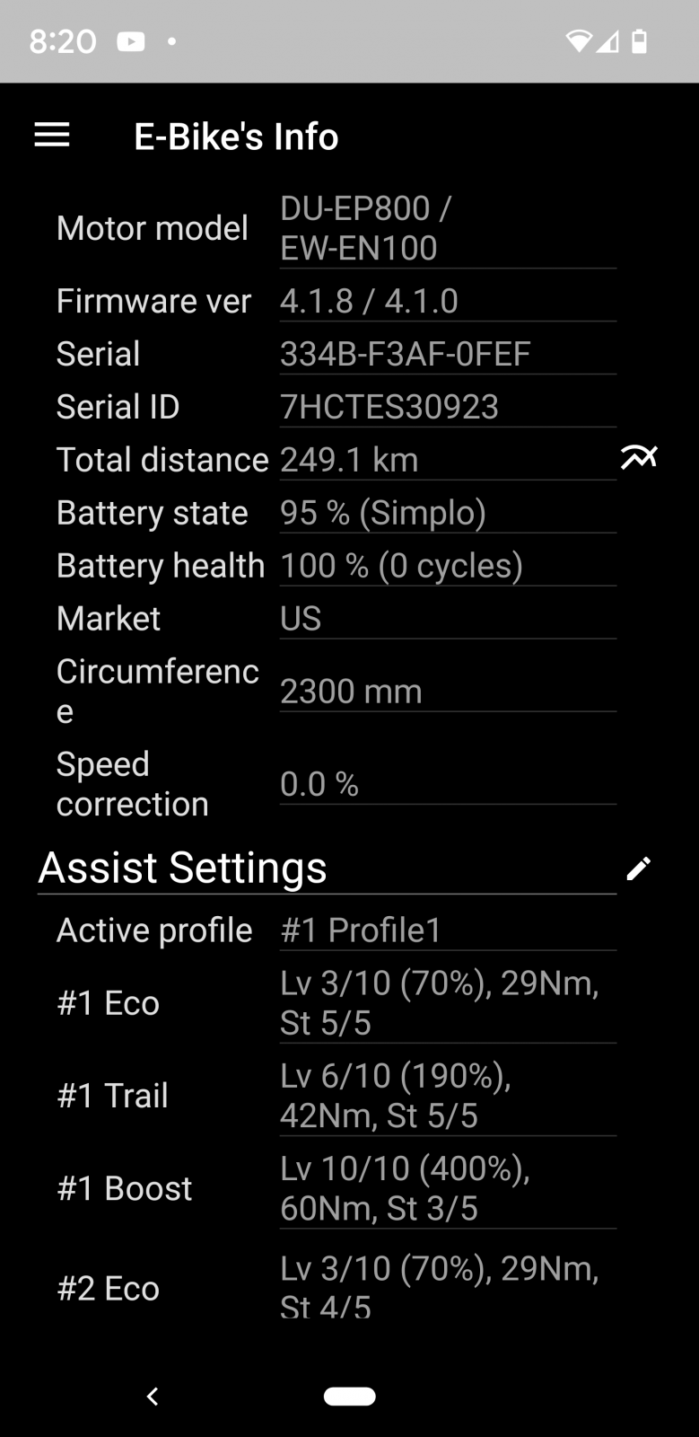

BTW, how does one display the following screen using the iPhone eTube Project App? Can't seem to find this screen.
It's from the ST Unlocked app, just included it so you can see firmware version and name. I don't use the app for anything other than viewing information. Oh and the screen shots are my settings not default settings.
