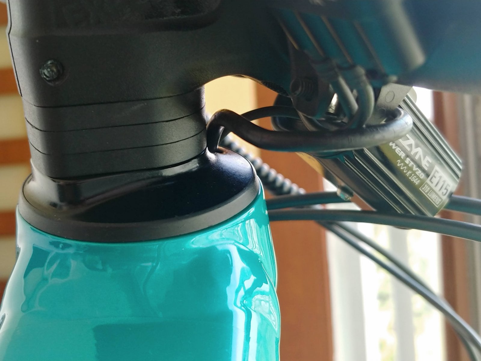

Can you post a photo showing the cables coming out of the cover?
Mine looks similar. On one of the bikes anyway. I'll take it apart and have a look. Can't be the cable pulling it so has to be something else....
I removed cables from the headset and the cover still rotate after ride counter clock wise.

While the top bolt is tightened it is way too hard to rotate that piece. Also, the cables are long enough and internally move with that piece. I have tightened my top bolt a good bit to see if it makes any difference but have not gone on another ride yet.

Not really. I tried to turn it by sticking an Alen key into hole and pulling but iI couldn’t. Without the pressure on that part it rotates easily so it can’t have any play even after it rotated.
With the increased torque on the top screw I have had no creaking and the cover has not rotated. I’ve only been on two rides, about four hours all up. I’ll keep an eye on it and will let you know.
