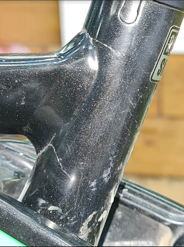

Anyone else had their aluminum eone-sixty frame cracked and replaced by Merida ?
After opening service request, How much time does it takes to get a response from Merida service ?
How much time to approve a replacement ?
Local dealer claims Merida is stalling.

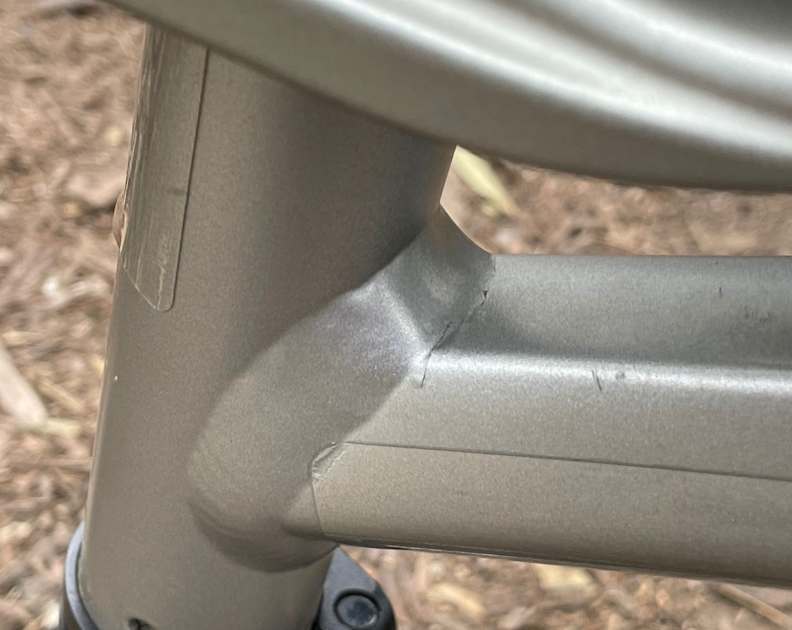

I have a crack in my frame too, I sent it to the factory when I called the warranty and despite being told that the frame was going to be replaced, at the moment they didn't have stock and they gave me a (absurd) delivery deadline for December. I was also told that the frame was analyzed and that I could continue to use it.
ps: I called the warranty in February... So technically 10 months of waiting
In process of having a 2021 Carbon e160 front triangle replaced (Uk based) after finding delamination inside the headset during a service. Issue reported start of May. My LBS had to go through Merida UK then Merida Taiwan to get it looked at (via photos). Warranty replacement approved start of June. When it went to Taiwan it took probably 2 weeks for them to respond. Expecting the frame in August at some point (probably towards the end).

I ran one on my old E160 800, which worked great, but the frame cracked on that bike in the same place as other people have experienced (top tube weld to seat tube).

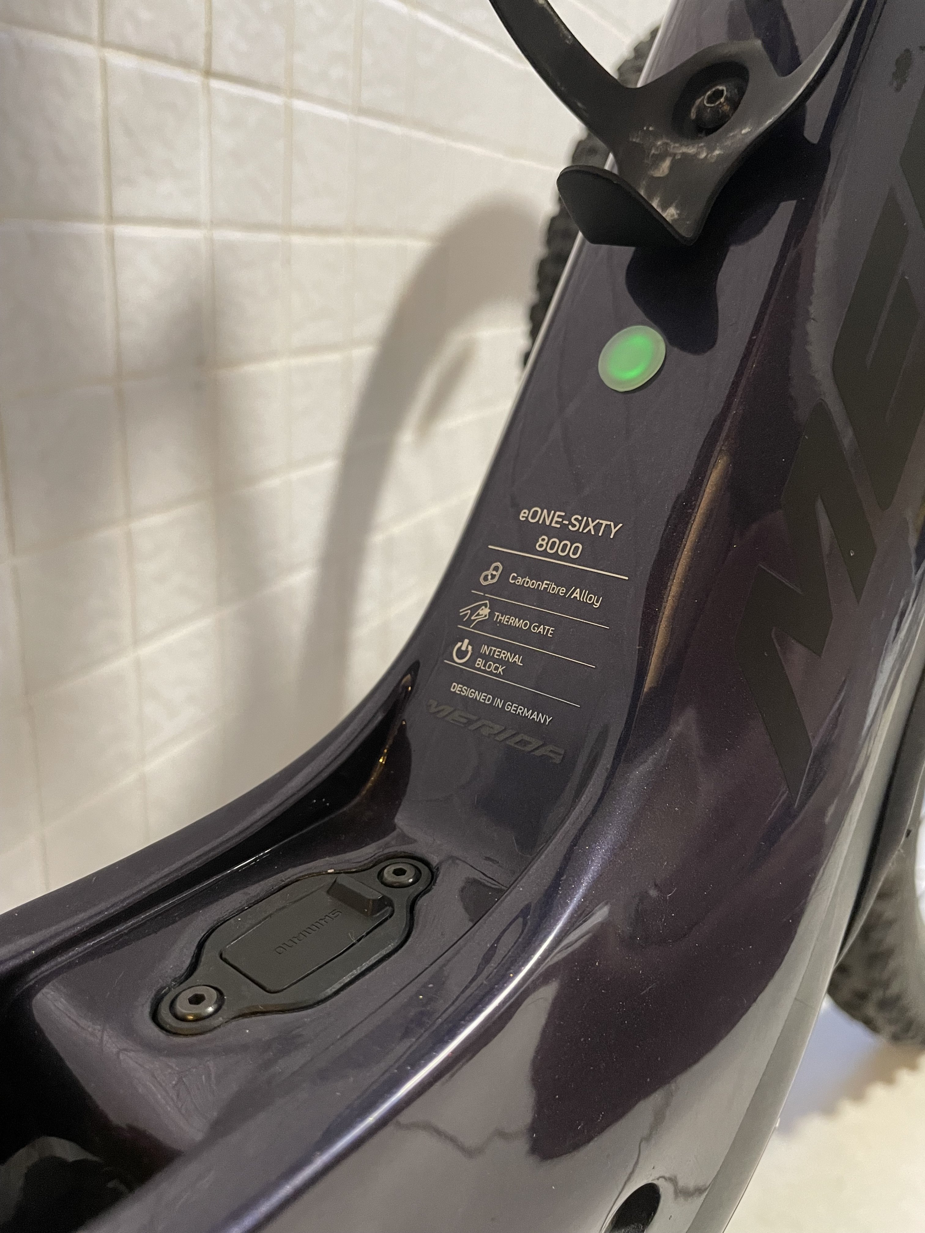

FYI, Charging indicator mod:
I replaced the black plastic cap in the downtube with a white silicon 8mm cap.
Now the LED that’s on the battery itself illuminates the cap.
While charging, number of blinks = number of bars.
That's genius! All the engineers at merida and they didn't think of that. I'm doing that to mine!

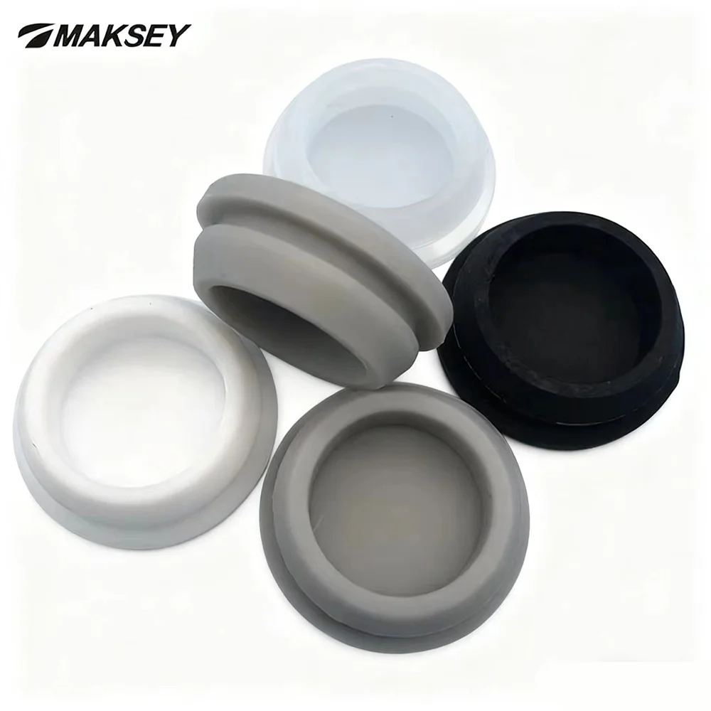

I used the one from the link below, 8mm, transparent.
That's awesome man! Have ordered some of them!

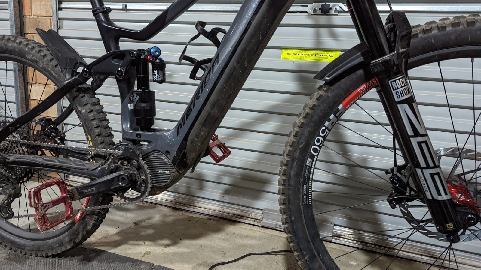

My Merida is riding like an absolute dream now.
180mm Zeb with smashpot coil conversion from TF Tuned (40lbs/in spring for my 60kg weight) 1 shim in the hydraulic bottom out for minimum resistance (endless coil feel).
Fox Van RC coil (same as the Marzocchi Bomber CR) Trunnion 205x65 400lbs/in. Much better than my MegNeg for compliance and endless plushness and you can adjust the compression damping to fine tune the support and bottom out. I was going to get a progressive rate spring but I really don't think it is required as I don't need it to be any more plush at sag. Highly recommended coil at both ends! Still playful as ever but eats up rough terrain with no arm pump.
I was initially concerned that maybe the shock is a bit cheap but it performs as well as I could possibly want.
