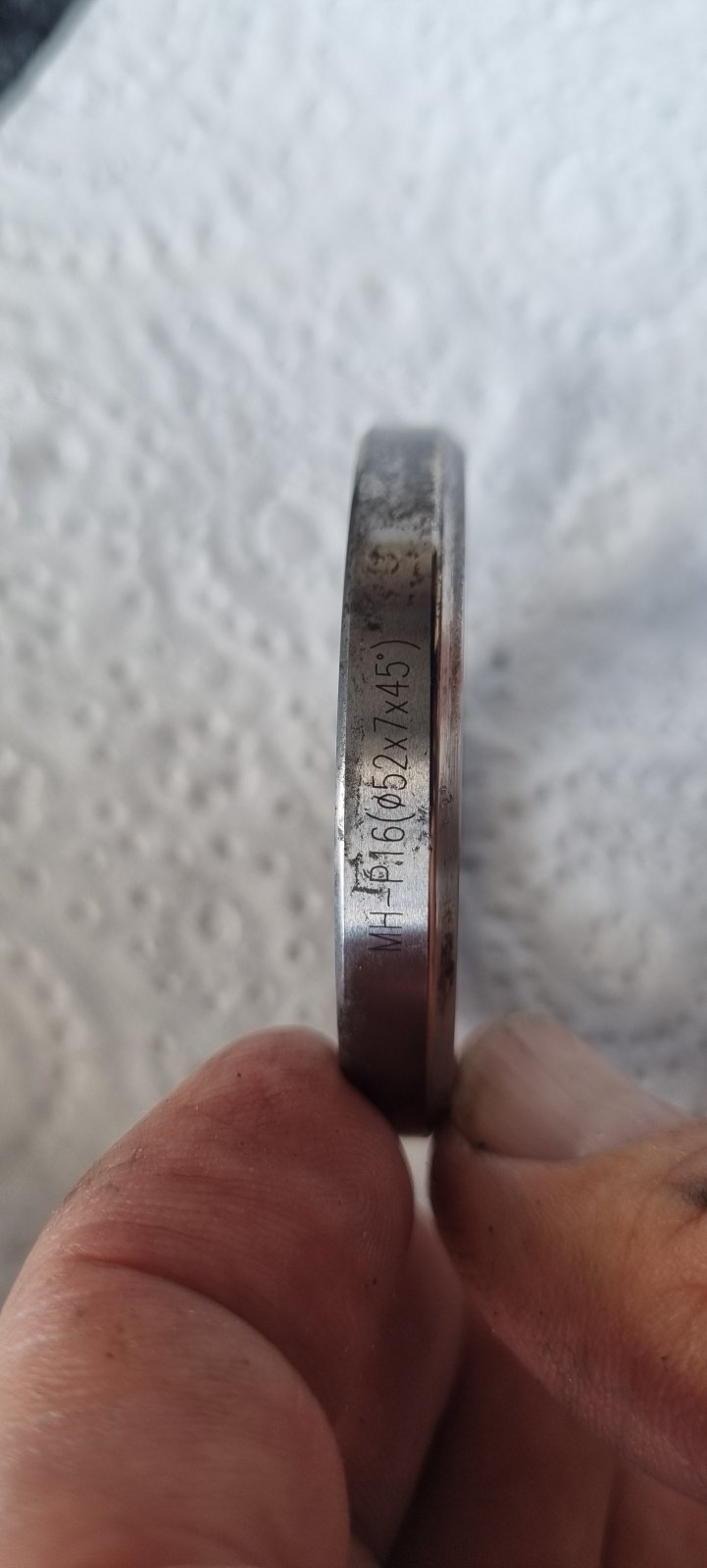

Anyone know what headset bearings fit the 2022 Carbon frames? Pulled my fork out and the lower headset bearing has fallen apart.
I had my lbs order some Enduro bearings. Not sure if the carbon are the same size as alloy, but here are mine. Yours should have the sizing on the shell also?
