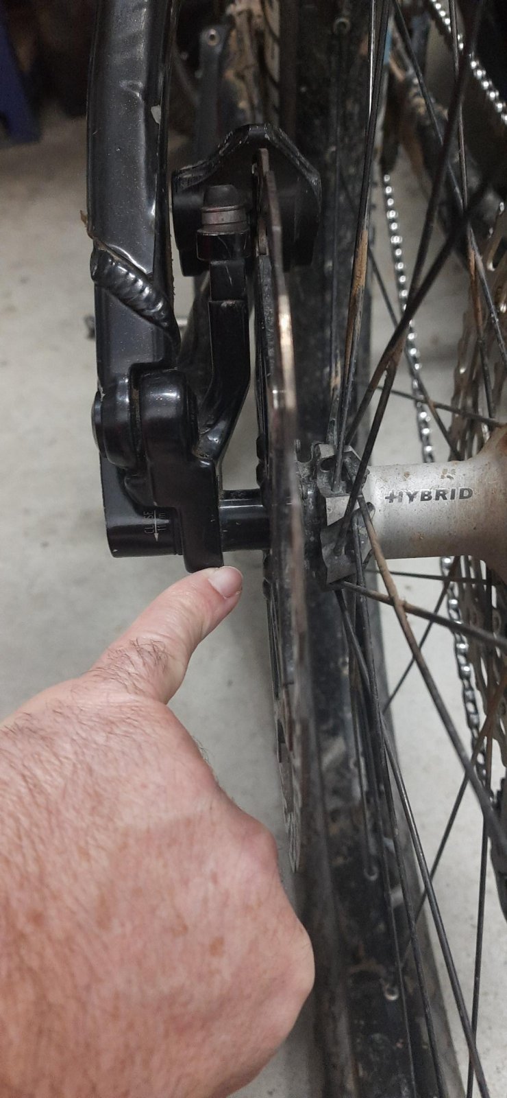

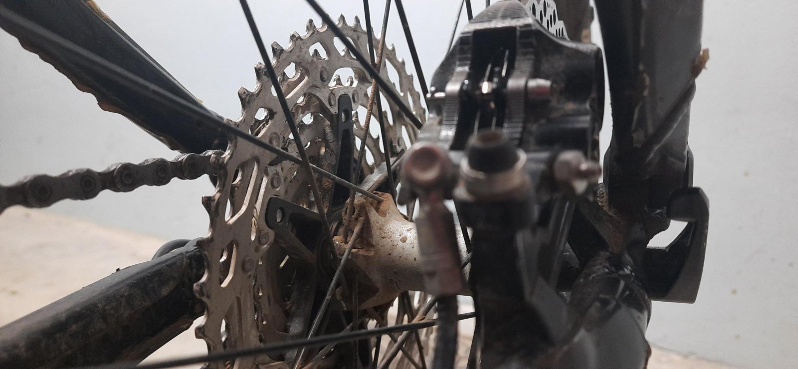

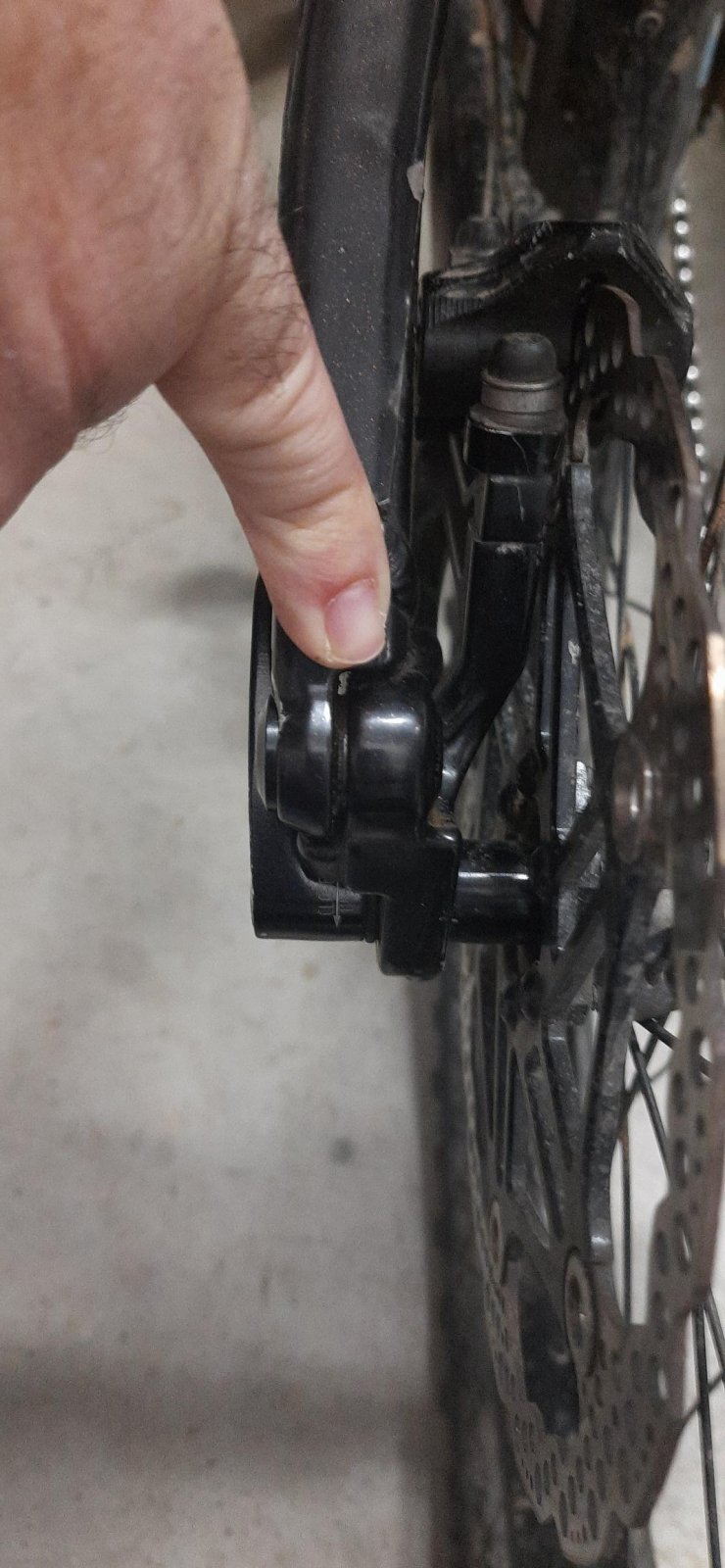

Buenas yo tengo hace 2 años colocados Hope tech 3 E4 en mi Merida Eone Sixty 900
Tienes que colocar en el eje de la rueda en el lado del disco una arandela de 2mm y otra arandela en tornillo basculante de 1mm.
Llevo ya 2 años y sin problemas, un saludo soy nuevo por aquí.

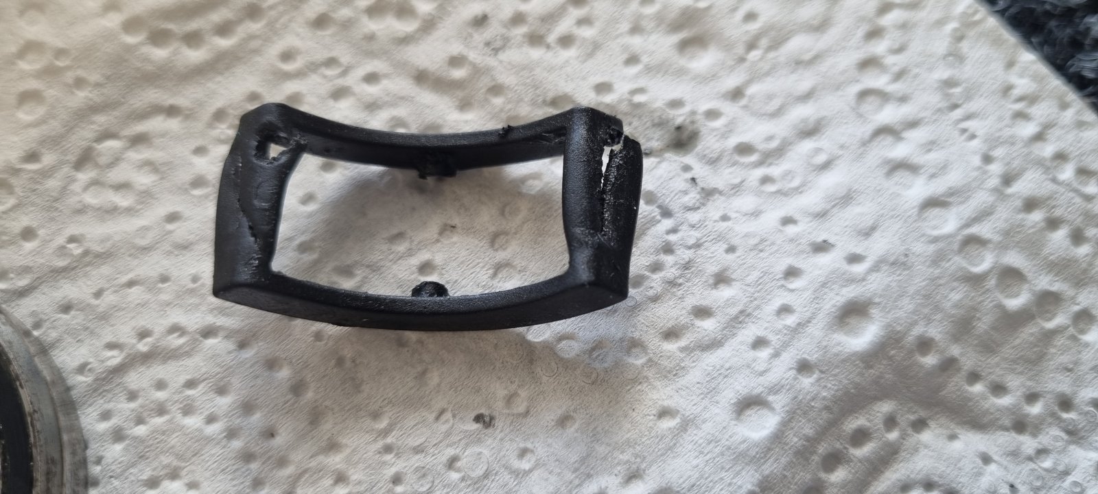

Do a bolt check obviously. When you turn the bar do you feel it hit the block? It's just a thing thats clamped around the steerer tube.
I ran over all the cockpit bolts to spec just last night - everything feels pretty tight up there.
I don't have the tool to check the engine bolts but it feels rock solid with no play.
The bars do hit the block when turning to the extremes - there's probably about 160 degrees of arc there. Curiously it used to be silent when I turned to the limit. Now there's a little tap when I hit the limit. With very mild pressure I can exceed that point of resistance, perhaps suggesting something is loose?
Sounds like you made a sensible call removing it. There's zero risk of the forks hitting the frame on my XL but potentially more than zero risk of the internal block severing wires. Curious little design, given Merida brag about it a lot.
Initially the block will hit the rubber stopper making it silent, but it quickly splits which renders it useless. Terrible design. Photo is of mine before I removed it. I still have the knock block in there as I've rerouted the cables outside of the headset.
Thanks, might get my shop to reroute the light and display cables next service. I feel resistance on those cables at full lock, which isn't a great sign.
i fixed it with glue on the knock block. no problem, still silent.
