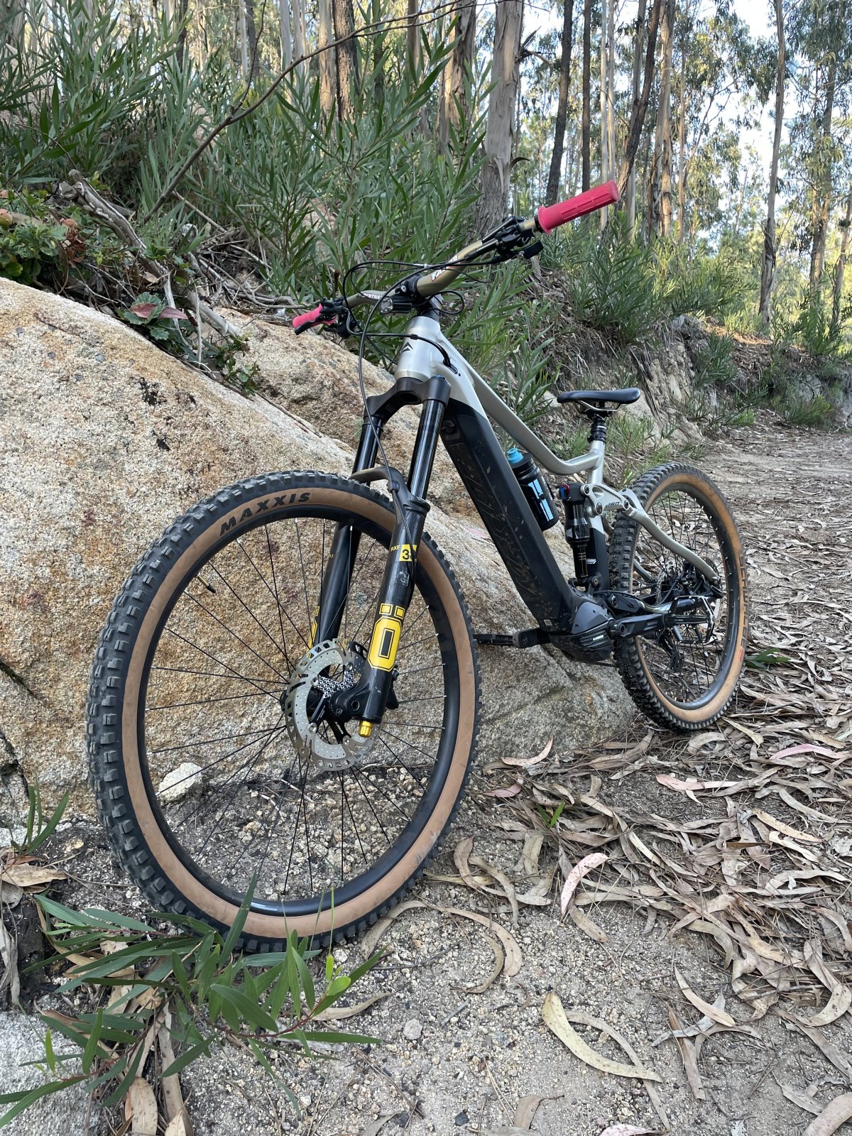

Hello there!

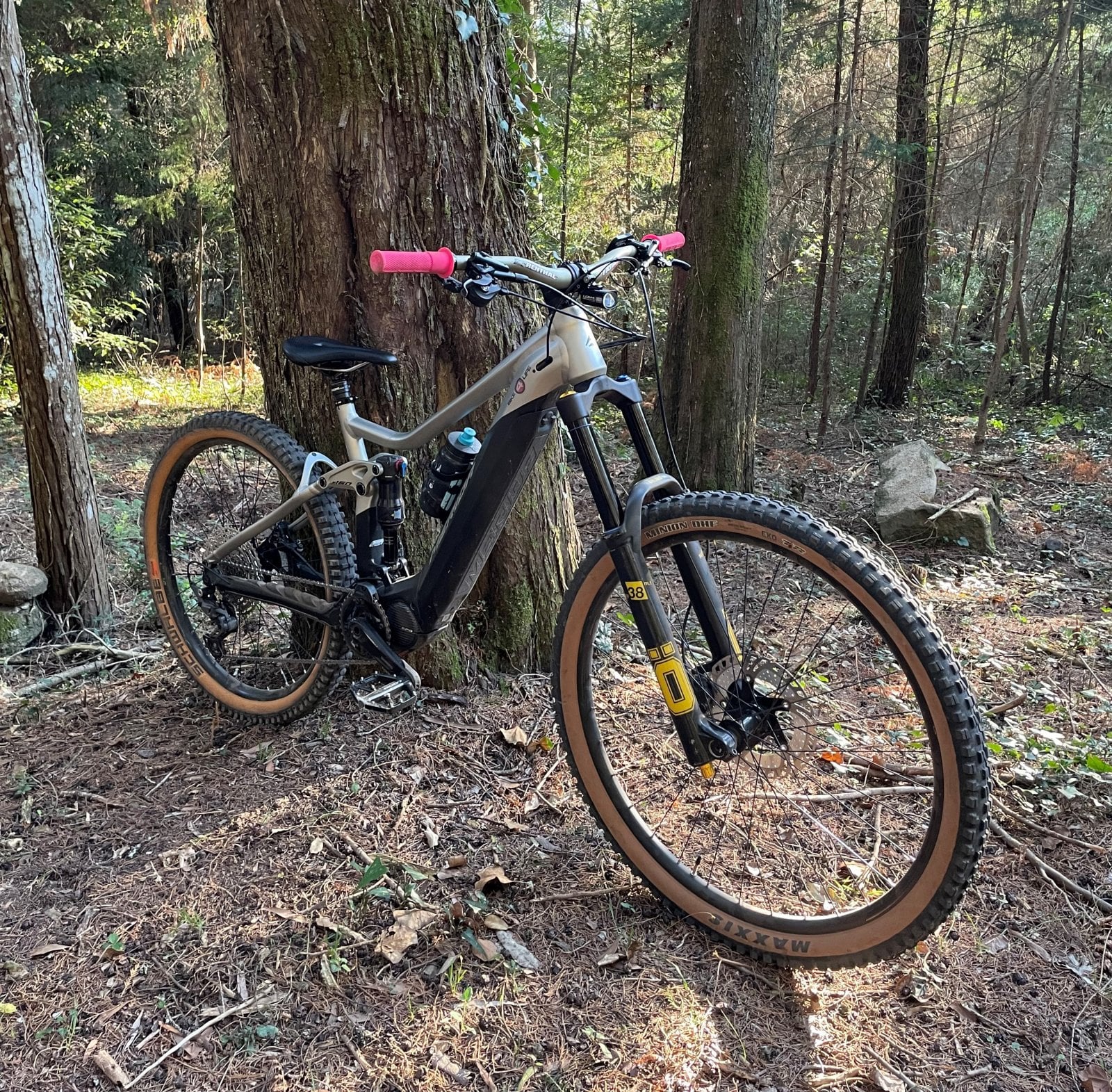

Here's mine with some upgrades,
Looks sick mate. How are you running your MegNeg?
I'm running 4 band negative/2.5 Gnar dog positive and it's super supple, but still supportive and poppy.
thanks bro, right now i am running 1 band and standard (1 token) on positive chamber, i like a lot of sag, make it better on small bumps sensitivity. But i am looking for a coil shock, just dont choose one yet.
Cool. Did you try any other MegNeg setups before getting there?

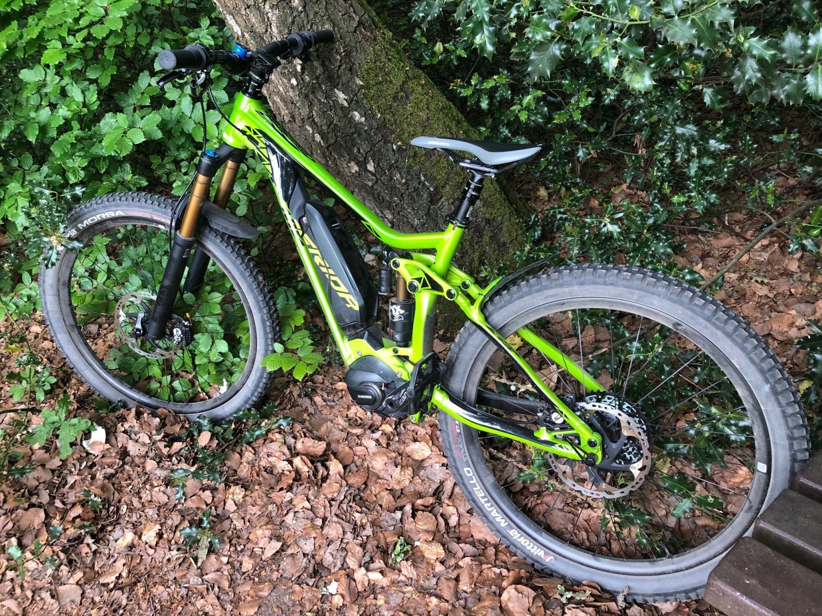

Hello from Germany,
riding my eONE-SIXTY for a year now I made some improvements:
-FSA cockpit with carbon bar
-sintered metal brake pads
-Ergon saddle with carbon rails
-Giant TRX 0 carbon wheelset (tubeless)
-Vittoria Morsa 2,35 and Martello 2,6
-Garbaruk lightweight cassette
-Renthal 34T chainring
-Miranda carbon cranks 160mm
Changing the complete setup of the wheels was a metamorphosis! No more feeling of riding a school bus!
Increased agility and speed enormously and reduced rolling resistance. A complete different bike!

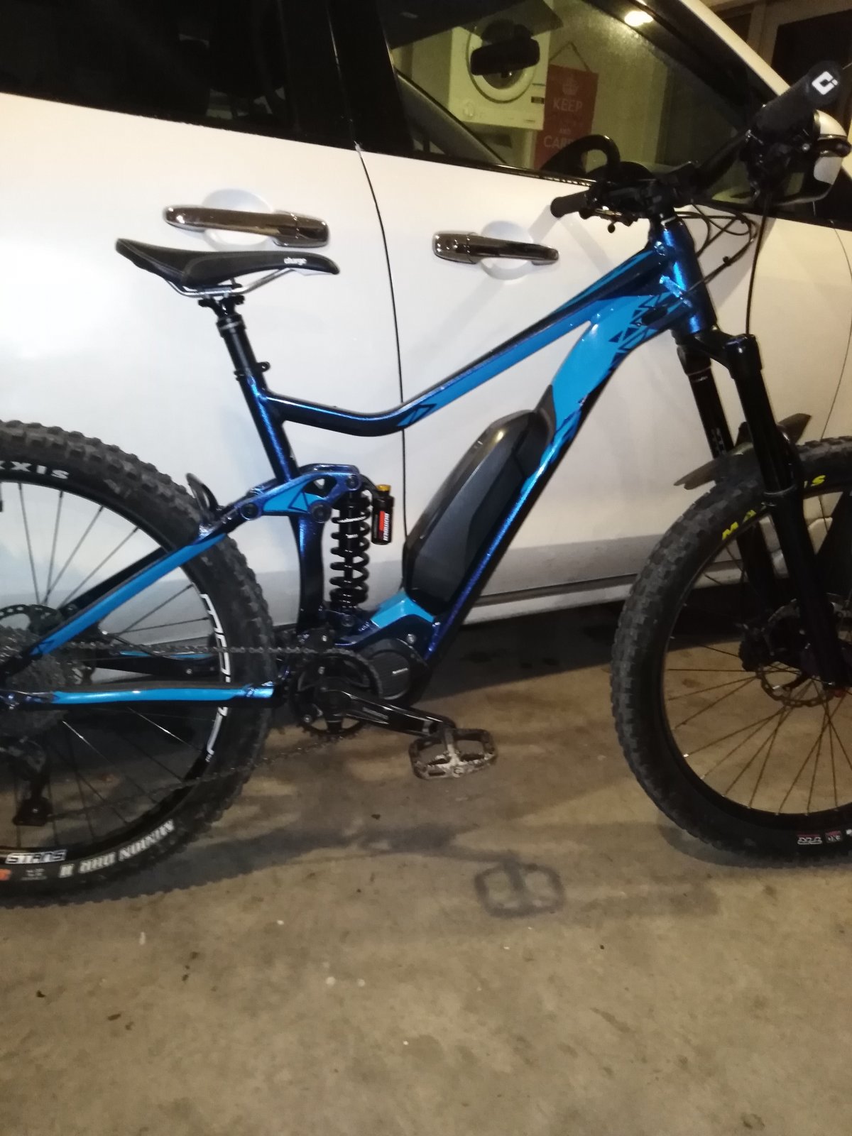

Hello from Rotorua NZ, I've had my Merida eone sixty for about 3-4 months and made a few mods.
- marzocchi bomber coil shock
- Yari fork with 170mm v3 air spring
- XT 1x11 drive train
- Oneup carbon bars
- Hope pro4 hubs on Stans flow rims
Kneedown69,
Did you originally have centre lock brake discs? If so, with the new rims did you have to change to 6 bolt discs?

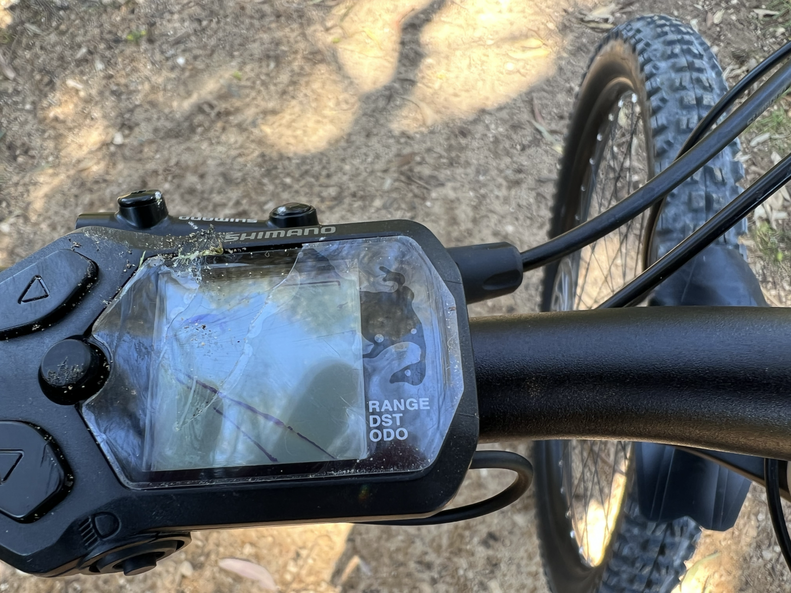

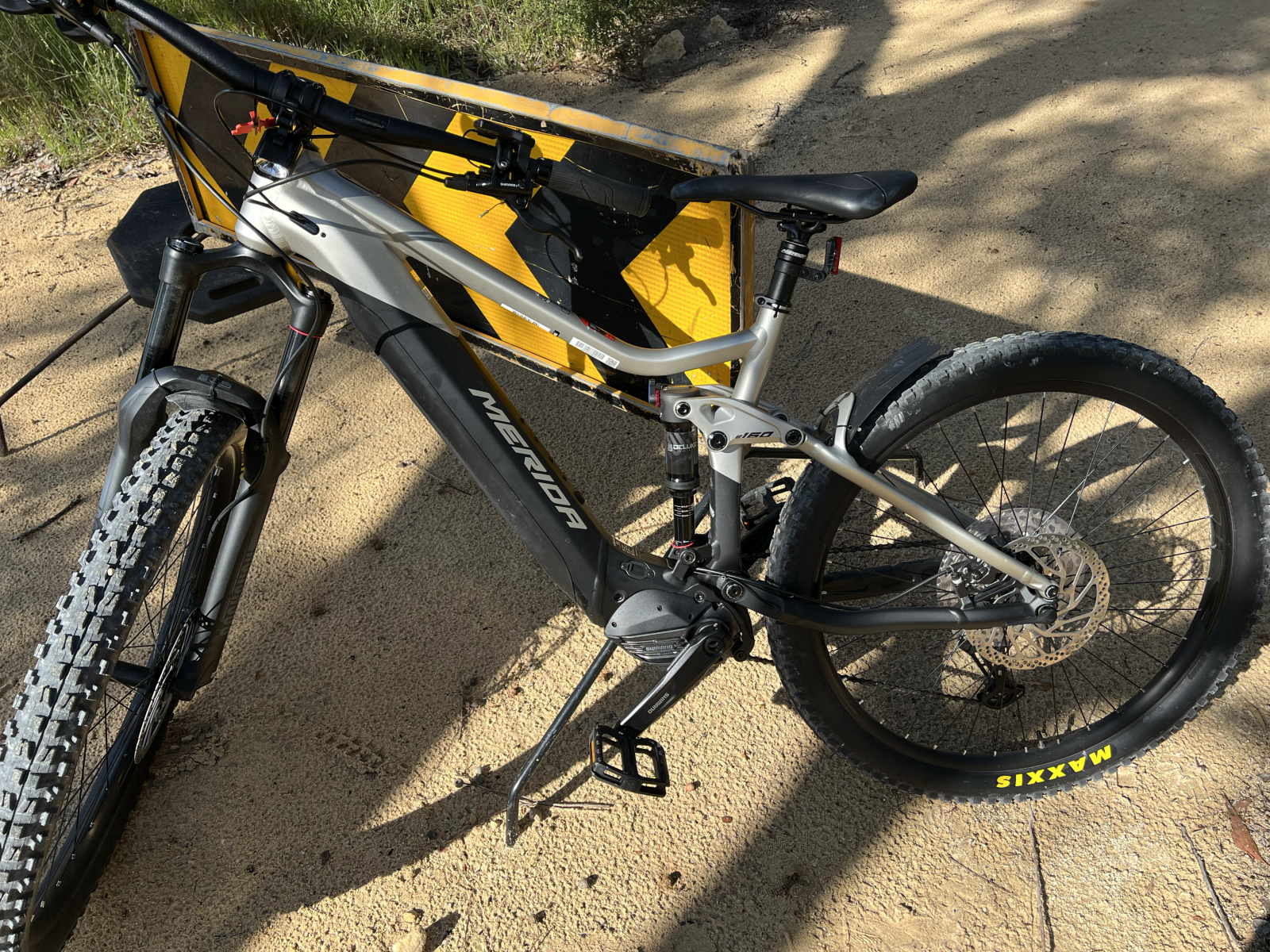

This afternoon was going around a hairpin corner down the steepest hill on the Yaberoo Budjara track, went wide off the track, hit a log and...
Killed my E5003...it was a mercy killing anyway. The electrics still worked and I rode about 6k back to my car.
I like the track between Lacy Road and Yanchep National Park and beautiful weather.
I got checked out at the hospital in Joondalup as I had some nasty crunching noises from my neck as I went over the handlebars and gravity didn't help as I was going down a steep slope. All good although they did X-Ray everything, just gave me plenty of painkillers and told me to rest up. I still managed to take the wheel off my bike and stash it in the boot of the Adrian. On the way back from the hospital I dropped the Merida off to 99 Bikes in Joondalup for it's first 'Safety Check'.
Weird how things happen. I couldn't lift the bike out of the boot and so there I was at 4:55pm at their shop. They were very helpful. I still had the blood stains and marks from the shrubbery on my t-shirt.
The bike looks fine but yes a safety check is probably a good idea but just not for the reasons expected.
Now...ribs and shoulder sore but some Codeine Forte to chew on.

Just an update on my accident...
I had an issue which I didn't connect to the accident which was the moving fork block designed to protect the frame.
That is 45 left and no further due to resistance then right to 90 degrees. If you then go left and force the bars, they go to 90 left but then only to 45 right.
My accident was low speed going around I would guess 110 degree right hand downhill corner. The accident happened too fast to process but I think I just ran into this block going right and the resistance would guess is about 20 pounds, too much to easily push through on the fly like that, lost the track and crashed.
I'm OK but it was over the handlebars and a pretty good hit, smashed the computer, and I am still sore and a few scratches but OK so pretty lucky I'd say.
