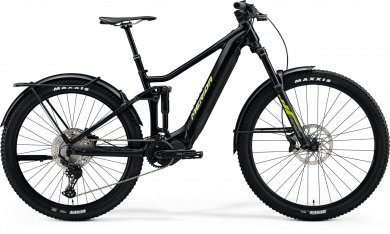

Hello! I am the owner of the bike merida eone sixty 500se. Can I buy and install on this bike a rear rack and a rear fender that come with eONE-FORTY EQ bikes? where can i buy? F38B8605-AB8F-4CF7-8576-55ACF2251D9D.jpeg

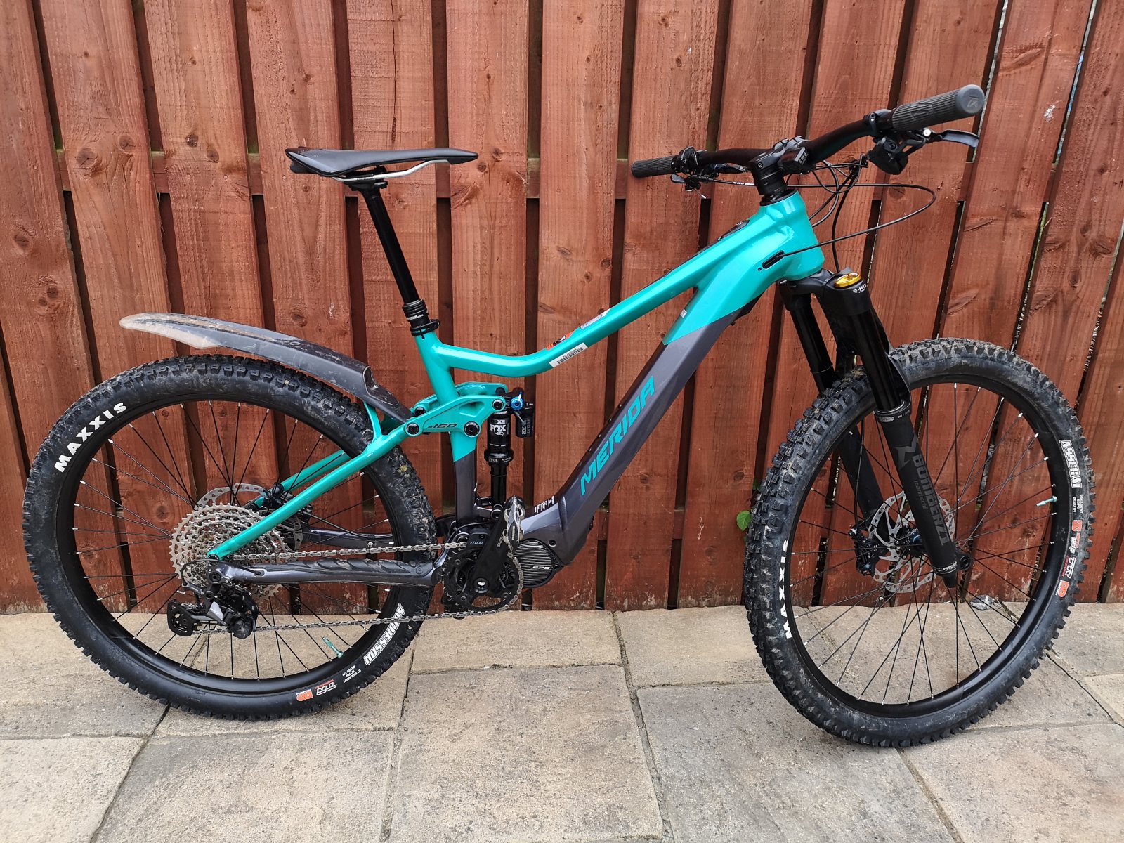

I think I spotted a discussion on dropper posts so I thought I'd let everyone know what's possible. This is my 2021 700. Not sure if the carbon models are the same but I've managed to get my 170mm dropper pretty much right down into the frame by a bit of wiggling and easing on the cable. It works perfectly, no binding or catching. Frame is a Large. There is, however, a pretty big loop of cable out the front :)
