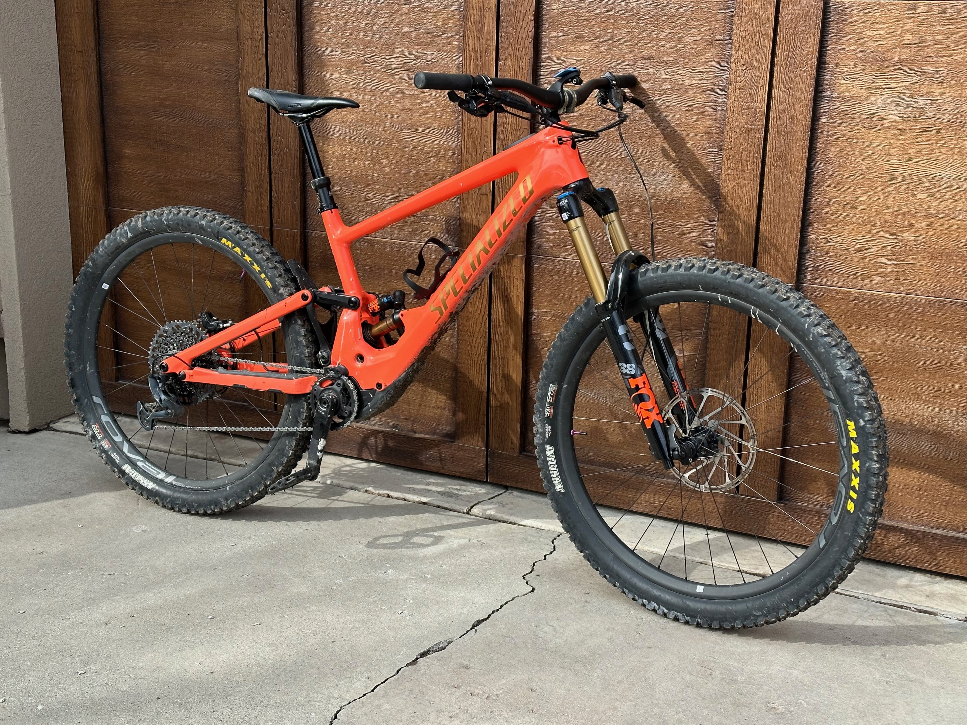

Loving my Kenevo SL. Bought it to replace one of my Levos and an Enduro. Really, really like the way it rides. A few upgrades: Fox Factory 38 fork, Fox Float X2 Factory, Traverse SL carbon bars, Traverse carbon wheels. Oh, and I made the Kashima matching Specialized decals with my wife's Cricut die-cutting machine.
Great looking bike. You should replace the grey Fox decals with gold for the matchey matchey look.

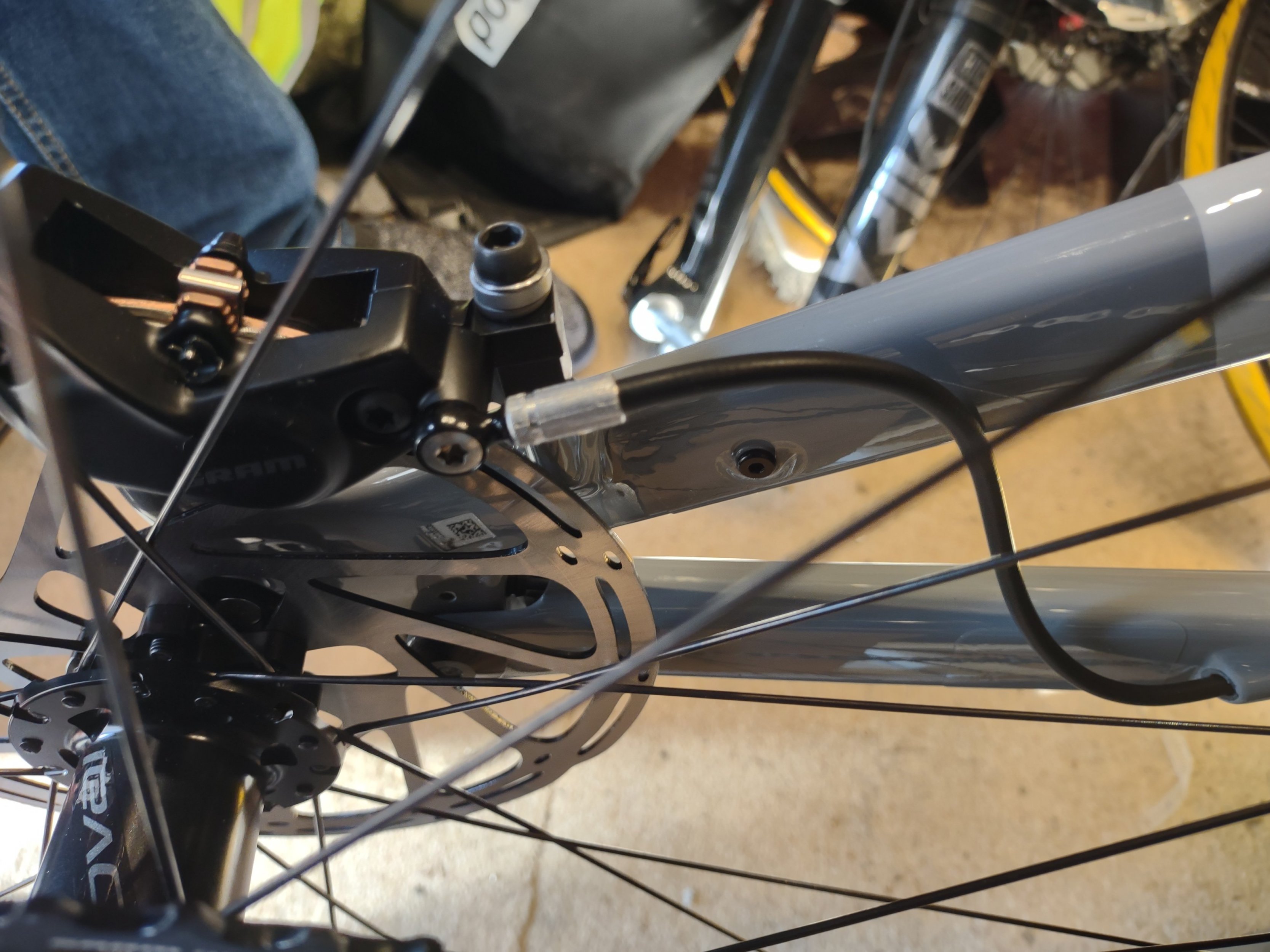

Just got my new bike. Is there a clip missing to hold the rear hose. The shop thinks not 🤔
