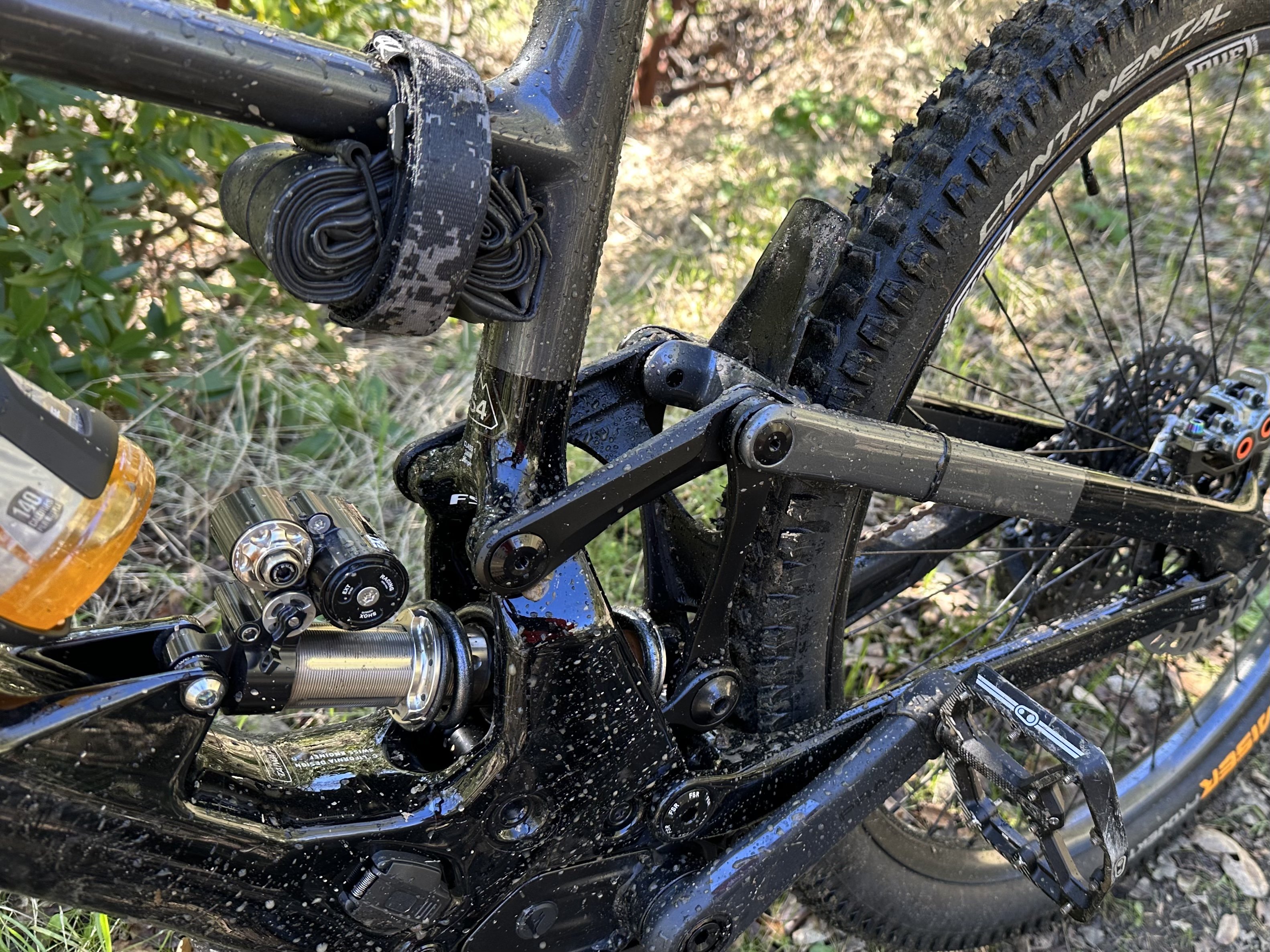

Hi all, How are you carrying a spare tube on this bike?
Here’s what I do. Does not interfere with legs and shock.

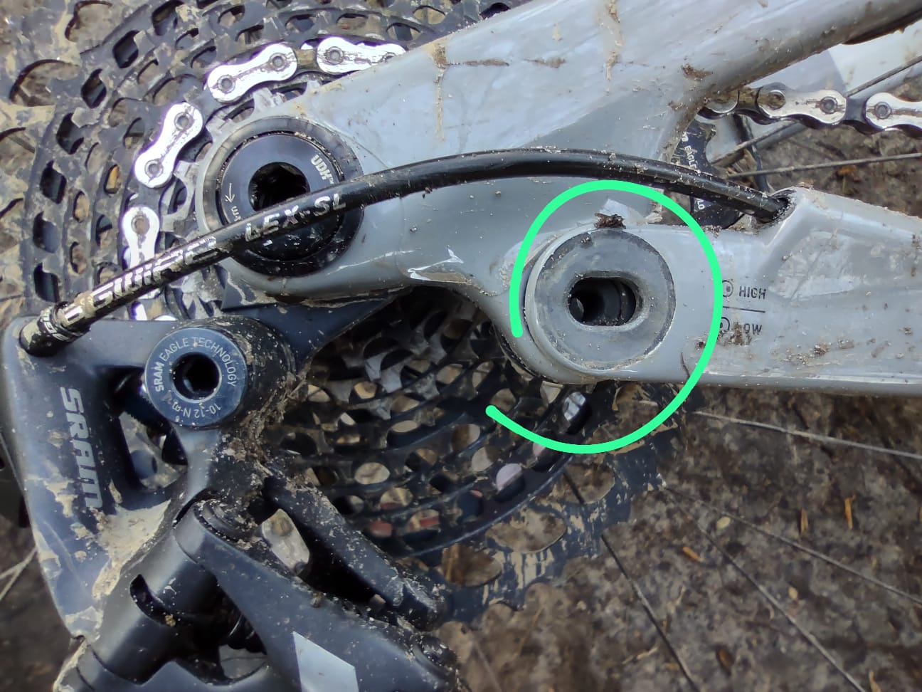

On my second ride tonight (40 miles total from new) a bolt fell out 👌 bumped into another kenevo rider on the hills whilst walking home and he said the same had happened to him and his son. Mmmm
