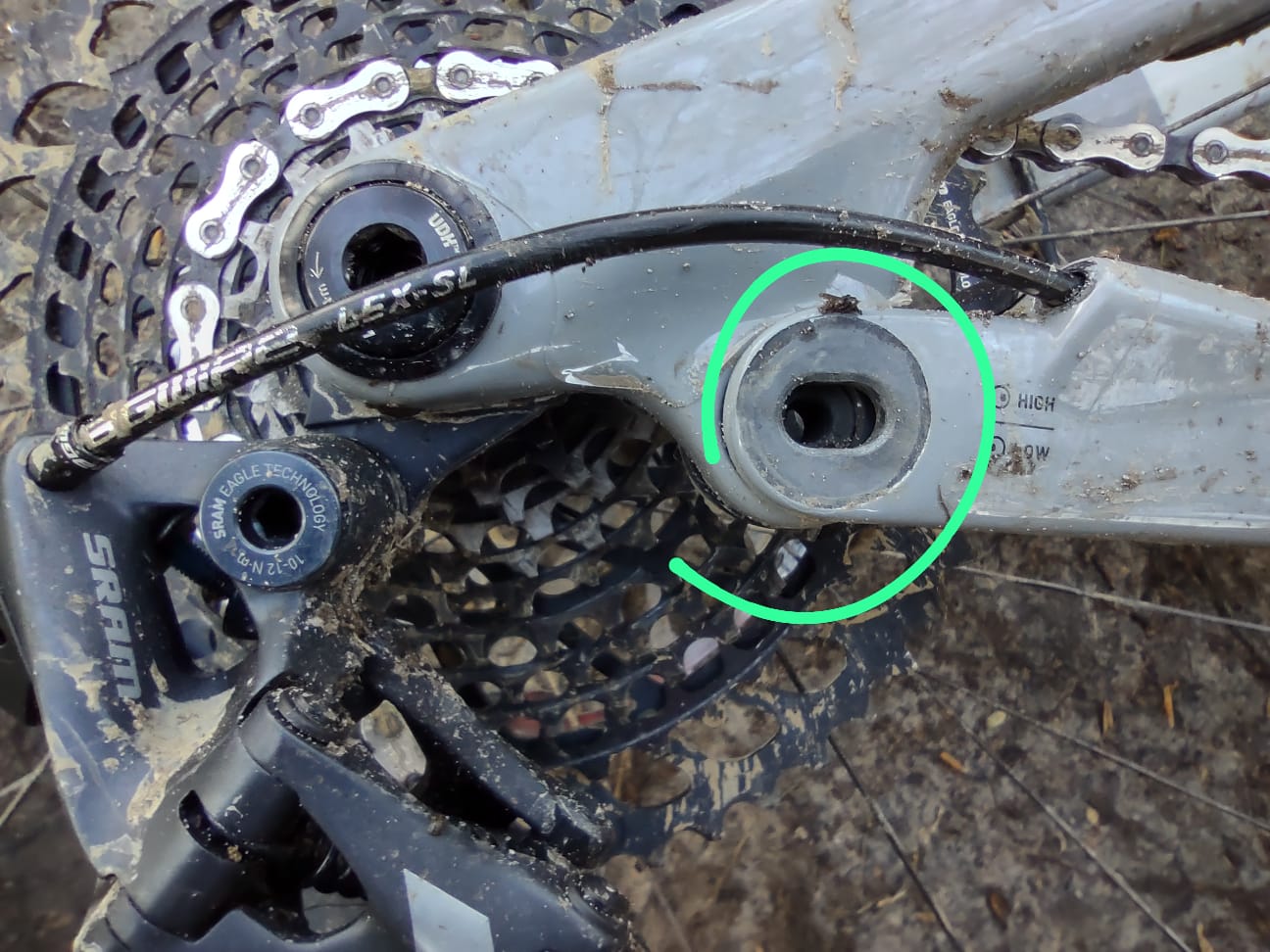

On my second ride tonight (40 miles total from new) a bolt fell out 👌 bumped into another kenevo rider on the hills whilst walking home and he said the same had happened to him and his son. Mmmm
mmmm maintenance.
Turned into a Ebiker Dave! That’s the flip chip bolt/bush missing. Sure Berkshire cycles could help you out.

It's going back to the bike shop where I bought it. Their plan was to nip everything up after six weeks of use. That's come quicker than they suggested to me

[Deleted pic of missing bolt and flip chip]
When I bought my bike, I took everything out and locktightened everything that should be....very little had threadlock applied where needed. Greased/lubed everything else.
Torque itself does not hold for long under vibration. Check this video out for fun, I used plenty of these nord-locks on cars, and I still mark every nut and bolt when building...: I especially thread lock my through axles....., just a dab though especially when going for epic days or traveleling.

It's gone back under warranty anyway and they have accepted it as their fault. The parts aren't in stock and are a long wait (months) so a whole bolt pack has been ordered under warranty by the shop
At that point I would be demanding a replacement bike or a refund. It's not like there's a shortage of ebikes to buy right now
Take it back to the shop.
I always go over new bikes with a torque wrench, every bike Ive bought has had stuff loose from the shop.
