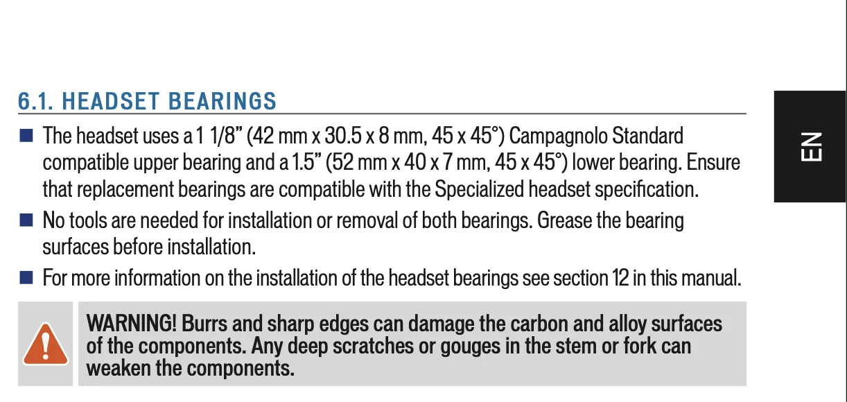

can someone put me out of my misery and tell me what headset bearings I need for an SL2? Upper one says MR215 on the side but measures 7mm thick, most that I'm seeing are 8mm.
Full dimensions from the manual!
