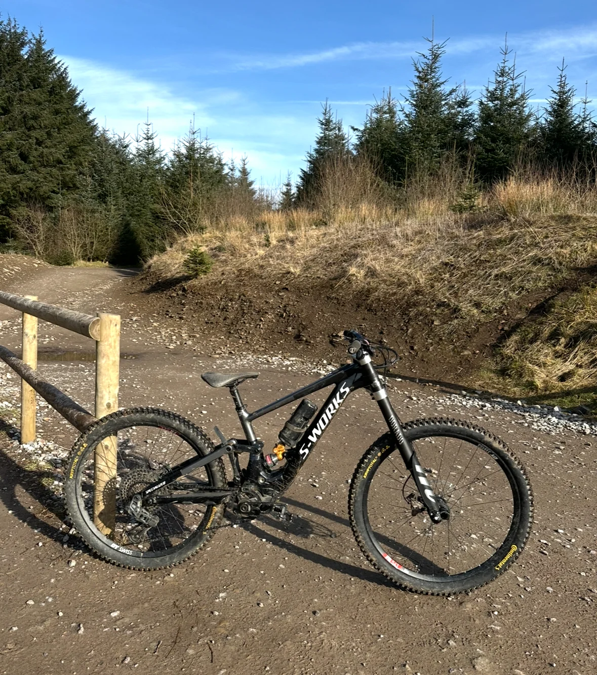

I am running my S4 KSL as a mullet, headset mid, flipchip low. 190 mm Boxxer up front, 155 mm cranks, 27-28 %-ish sag.
Yes, the BB drops quite low, but with the short cranks I only get occasional pedal strikes on technical trails. The only place where I’m feeling discomfort is decending rock gardens with a scatter of tall pointy rocks, where even the bash guard could get a hit. In all other places, bikepark or trail, it’s a beast yet remains agile to throw around with the smaller rear wheel. The +5 mm of chainstay lenght with flip chip on low makes all the difference in a very balanced feel on the bike and especially when railing corners IMO. I simply cannot go back to high flip chip, but wouldn’t mind a bit taller BB, hence the interest for a mullet link also from my side. No gripes with other aspects of the geo with the setting described above.

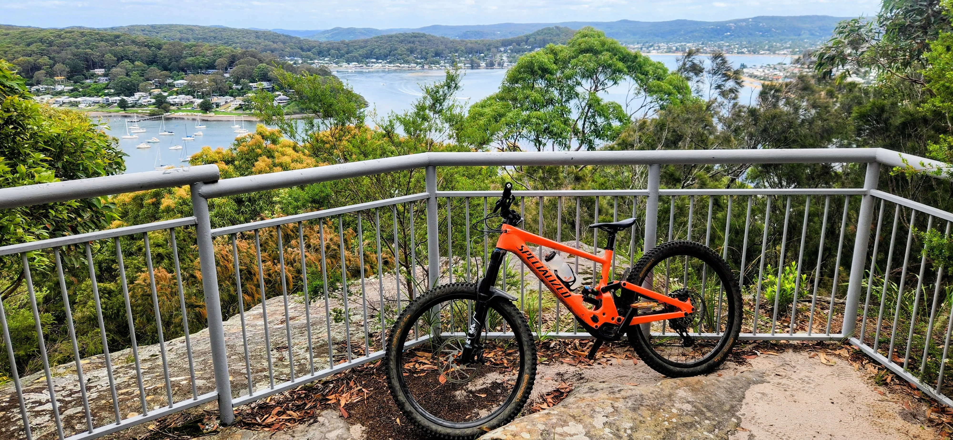

Mullet ksl with flip chip in high and headset in steep is very similar geo to 29er low/neutral. It works really well as a mullet.

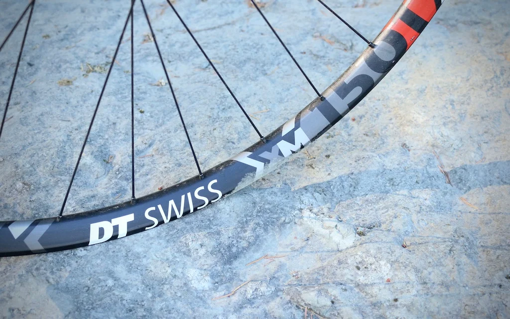

Looking for some wheel replacement suggestions. I currently have the Roval Traverse Alloy 350 6B. They seem to be made of cheese or some other material with no strength. My rear wheel currently looks like someone has used it for target practice with a shotgun. I was think possibly Hope? Or DT Swiss H1900. It would be good to hear what others are running. Thanks
DT Swiss EX511 on hope pro5 have proven incredibly strong. Despite falling out the sky at Dyfi and heading the back rim hit the ground, it’s still round and holding air.
DT Swiss 240 hubs with DT FR541 rims, they’re basically indestructible. Prior to using FR541 rims I destroyed 7 rear wheels in a year!
I had a Hope Pro5 rear hub for a while and could never stop the rear brake from rubbing because the disc mount face hadn’t been machined straight, so it looked like every disc had a massive “throw” in it! Cost me about £400 in different (new) brake discs before I figured that out 🤡.
I swapped over to some DT Swiss XM 1501 aluminum rims which are stiffer. I run them on my other bike and like them a lot. They didn't absorb like the stock Roval's so I swapped back over. The Roval's absorb better so the ride is better for me.

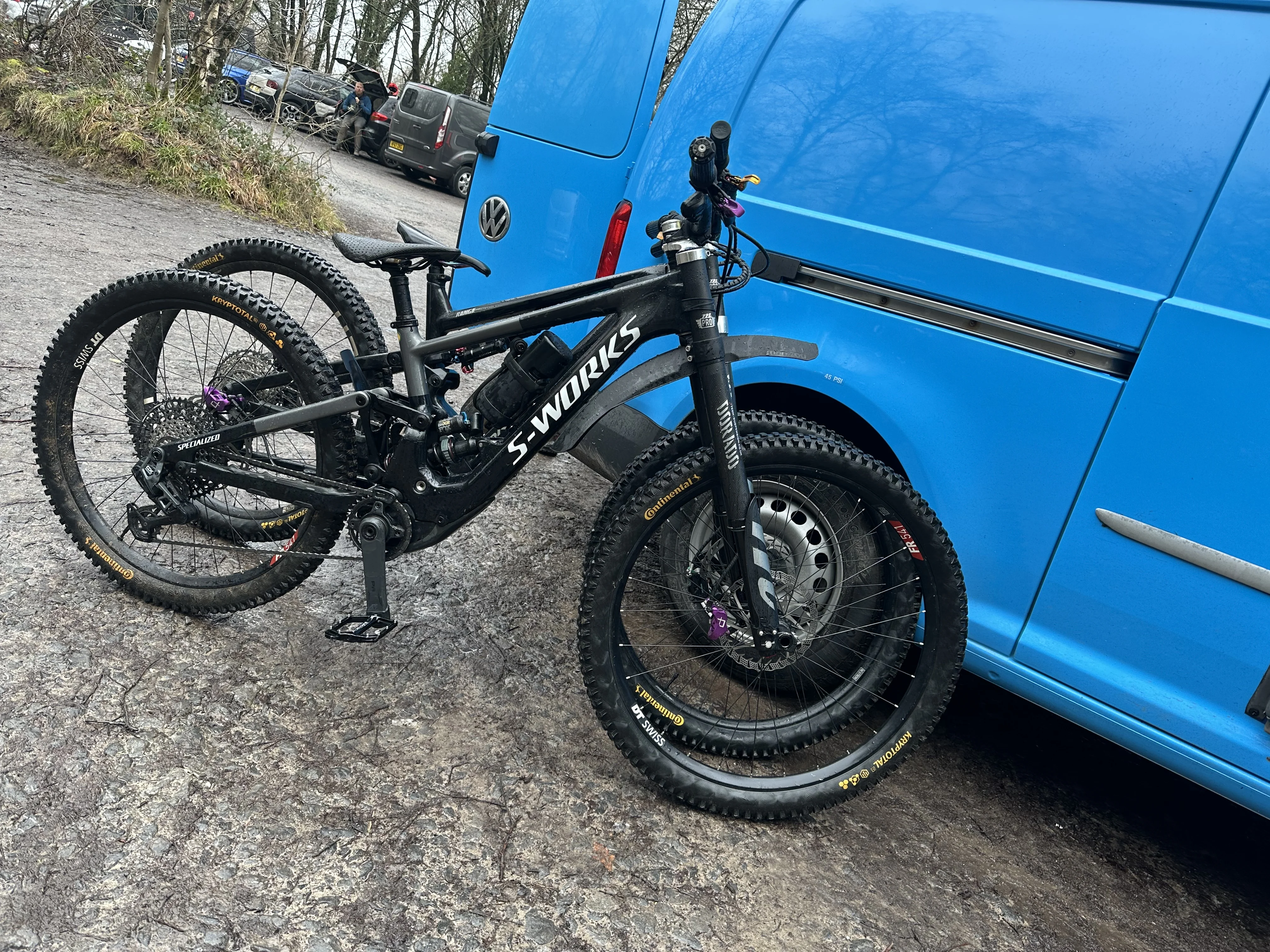

Mullet makes the bike so much easier to turn and better in steep and tight stuff, mine’s S2 and I’m only 5ft4 so as a full 29 the wheelbase was just a bit too long for me.

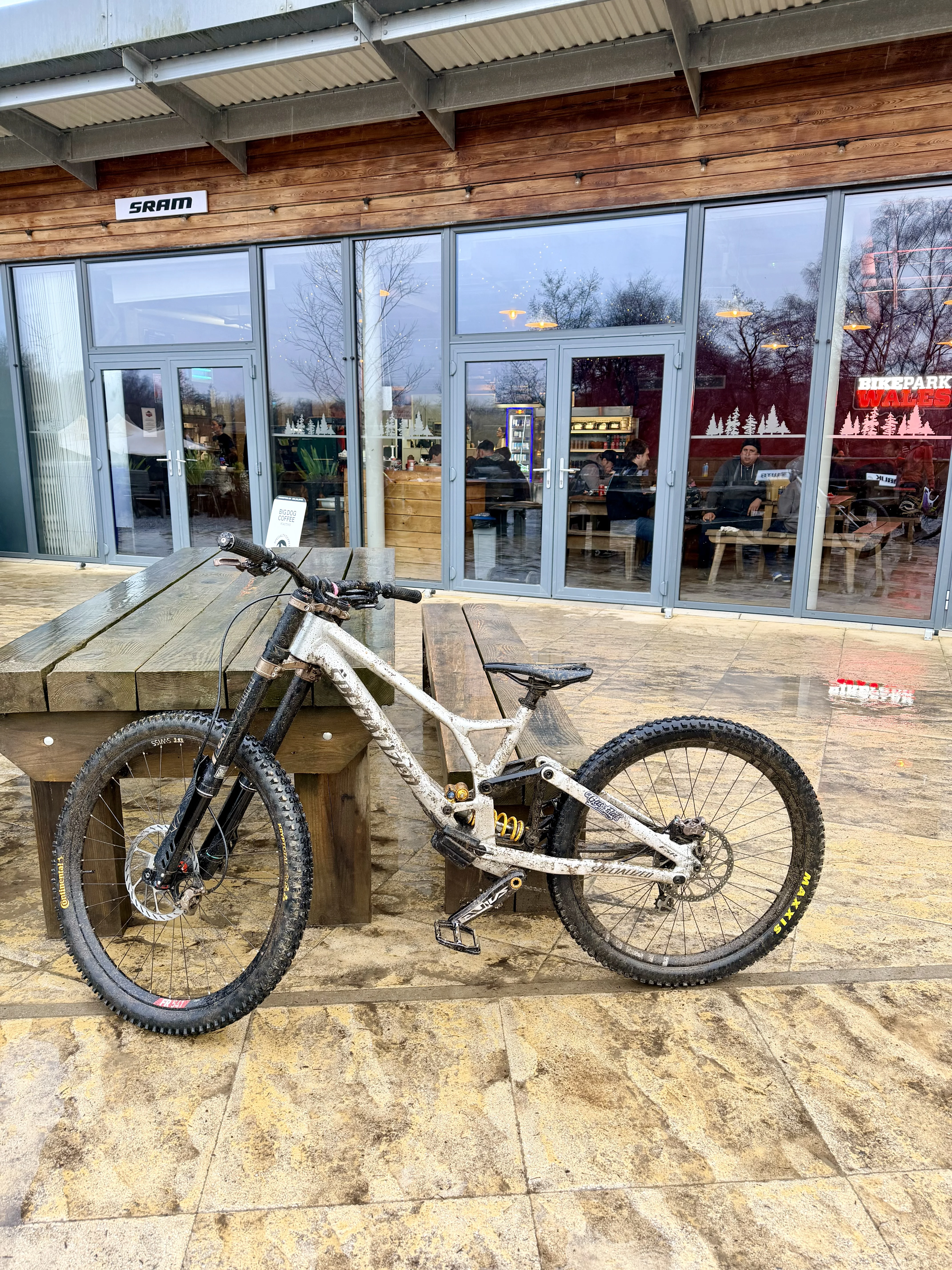

This is my “spare” frame with 155mm Praxis cranks on, the frame I’ve been riding for the last 12 months still has the stock 165mm cranks on but I don’t have a good photo of that one!

Interesting you picked up on how slack that front end is, it was a bit too much so I swapped the crowns for ones with a different offset to steepen it closer to stock geo and it’s spot on now. The forks are set to 180mm so only 10mm up from stock. It’s unbelievably good downhill, on par with any of my downhill bikes (Spesh Demo, Commie FRS, Intense M1), and actually jumps far better than the high-pivot Intense. It carries speed through chunk better than the Demo so I’ve added 2kg to that to make it the same weight as the KSL.

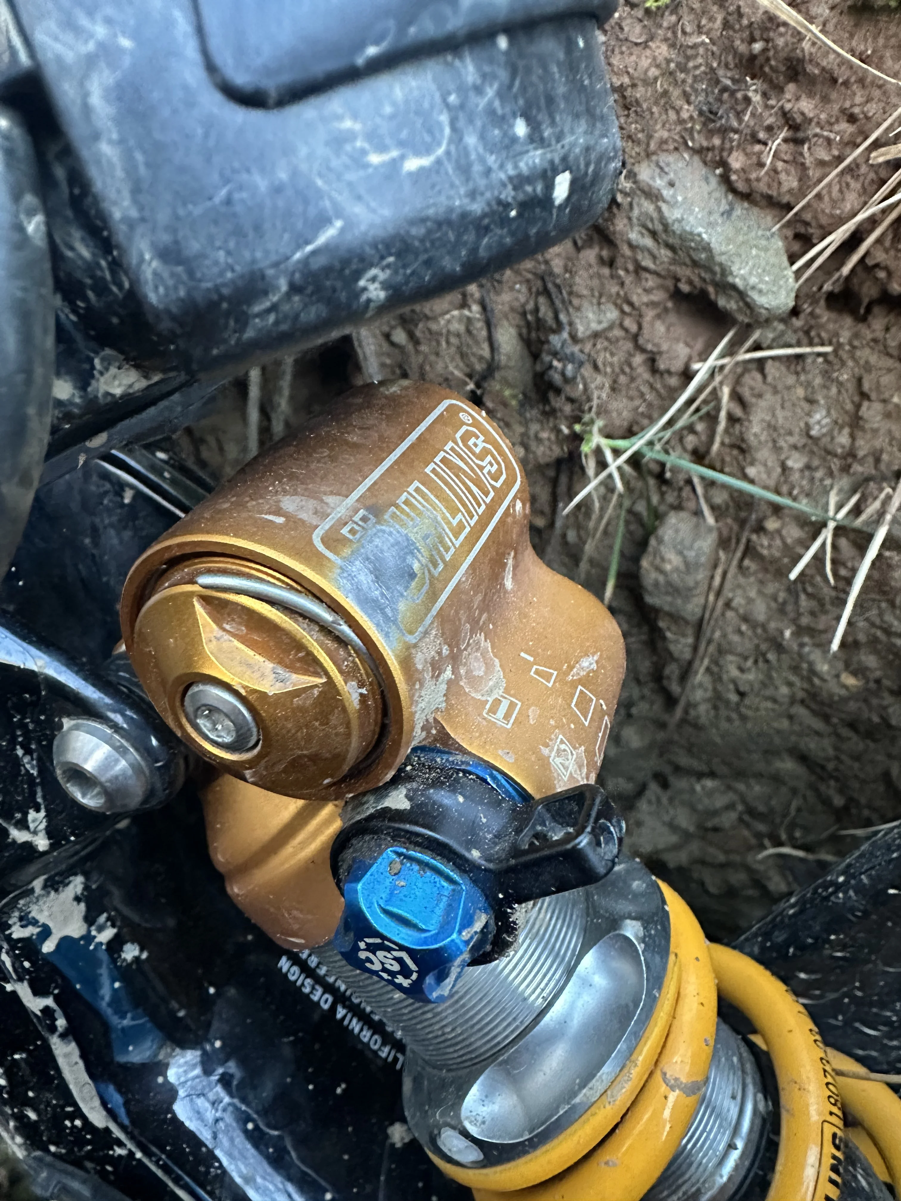

The Ohlins coil was great until it decided to throw its toys out of the pram and came out of the van like this one day.
My OH and Mark at the BPW workshop (who is a gem) managed to fix it but the damper is now making a horrible noise on compression so it’s in the corner waiting to go back to JTech.
