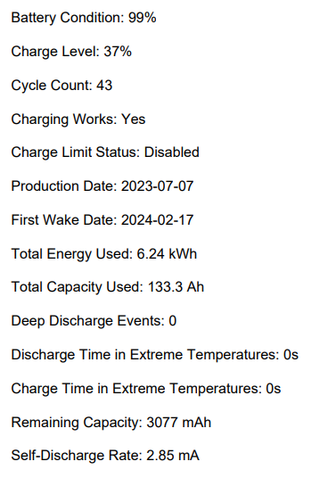

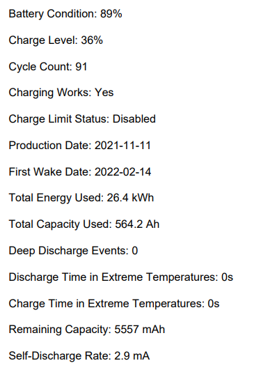

got my main battery and the extender analyzed. They said it had to be lower than 75% before 300 cycles. So hugely dissapointed. They proposed however 50% discount on a new battery. Below the analysis.
MAIN BATTERY
EXTENDER

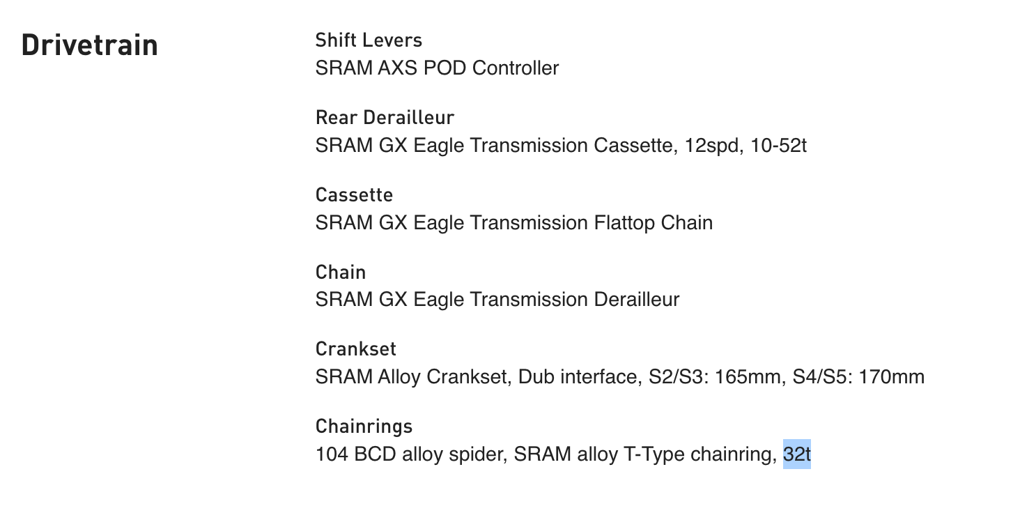

only for the 1st gen, 2nd gen is 104bcd and if you want to run transmission 34t is mandatory
Whatever's wrong with you, keep it to yourself. KSL 2 comes stock with 32t. My KSL2 came with 32t and Transmission as well. Have look below (source: Turbo Kenevo SL 2 Ohlins Coil, retrieved on 2025-06-05)

I have the normal S-works, not the Ohlins Version. Link was just regarding the 32T/34T discussion.

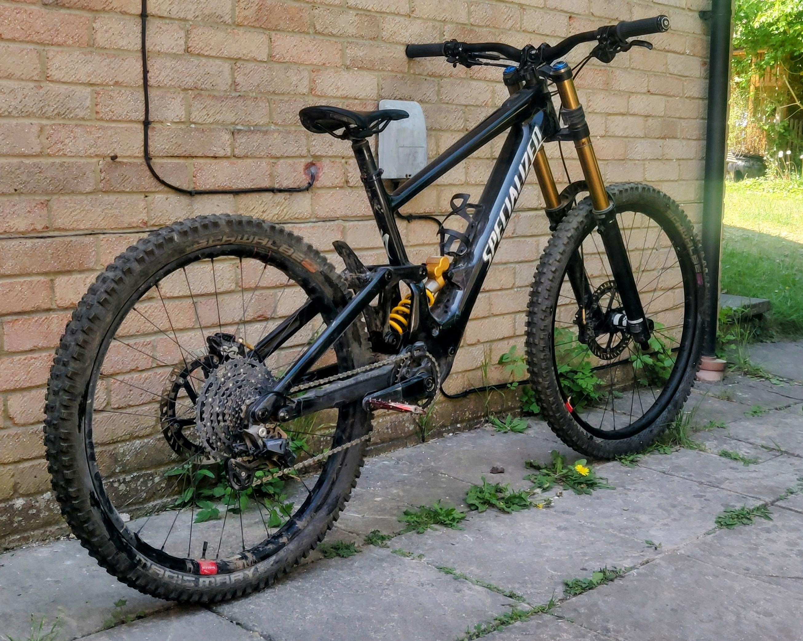

Purchased an estoria for my kenevo to try, so moved the ohlins over to the sl with a fresh new 575 spring.
I really want to take it for a session but always remember how hard it is to pedal uphill at the local bikeparks 🤣.
Will hopefully get a few uplift days in this year once fully recovered from injuries.
