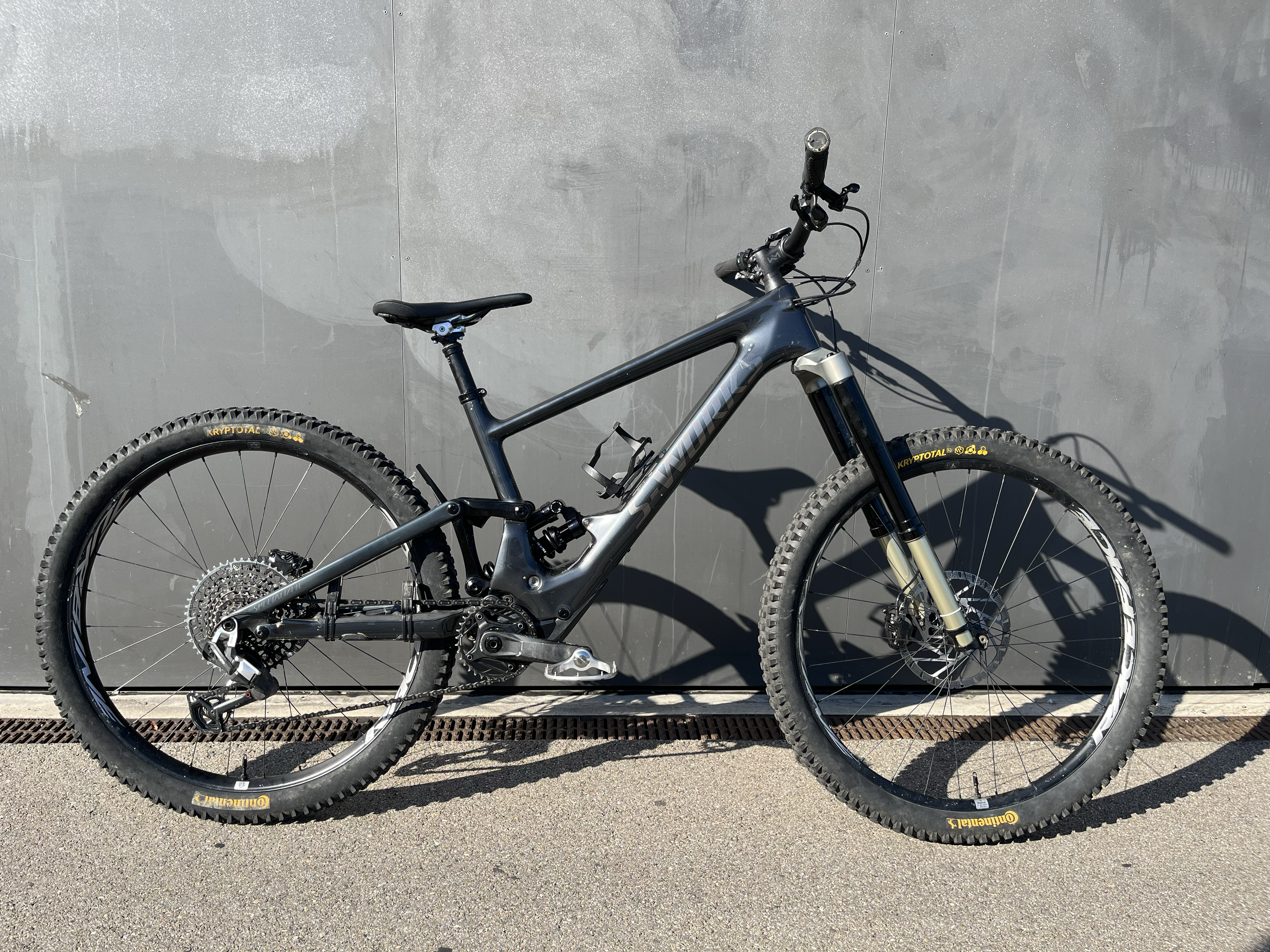

mine is now pretty much dialled, this year I added Intend Trini[ti ]brakes, Intend Flash, Eagle90/X0 Transmission mix, the Outlier pedals and today my new Fast Suspension Fenix 2.0 shock in complete black no decals
You went all in as they say! Nice build. Really curious to hear your opinions of the Trini[ti ]brakes, Intend Flash, Eagle90/X0 Transmission??? Sorry, not sure I'm aware of what the "Intend Flash" is? I've been contemplating the Eagle transmission. Does it shift any cleaner? I'm not a fan of the the stock setup, but I keep comparing to my analog Yeti SB130 which shifts like butter in comparison.

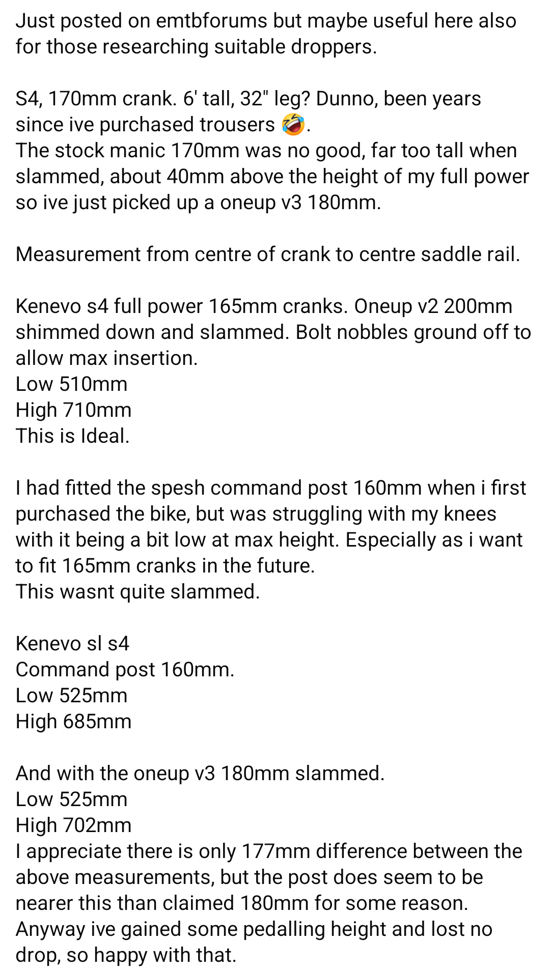

Hello KSL owners! I've a KSL S4 size, and I'm constantly hitting my butt with a seat in the bike park (e.g. jumping). I'm wandering is it possible to replace the stock dropper post (xfusion manic)? In the default inserted position it has a 80mm height on top of the seat tube ending.
I reviewed a discussion about oneUp dropper posts. What dropper posts you can advice to reduce the height of the dropper post in the inserted position?
I did a detailed writeup on the sizing of a 180mm oneup on the s4.
The stock one was far too tall.
However i have now reverted to the 160mm spesh command post, as i used the oneup on another bike, plus the ksl is an uplift bike only now, so no real need for efficient pedaling.
