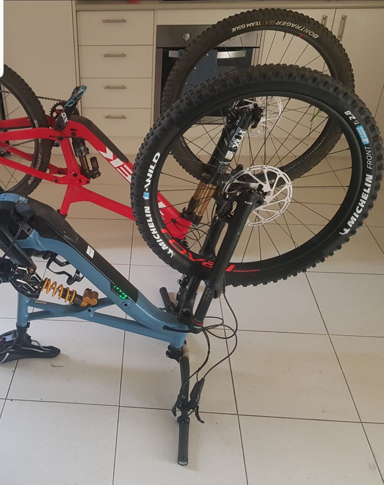

I got the Michelins and Cush Core all mounted up yesterday. Can't wait to test it out ?

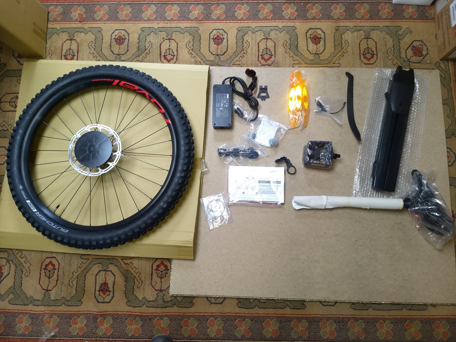

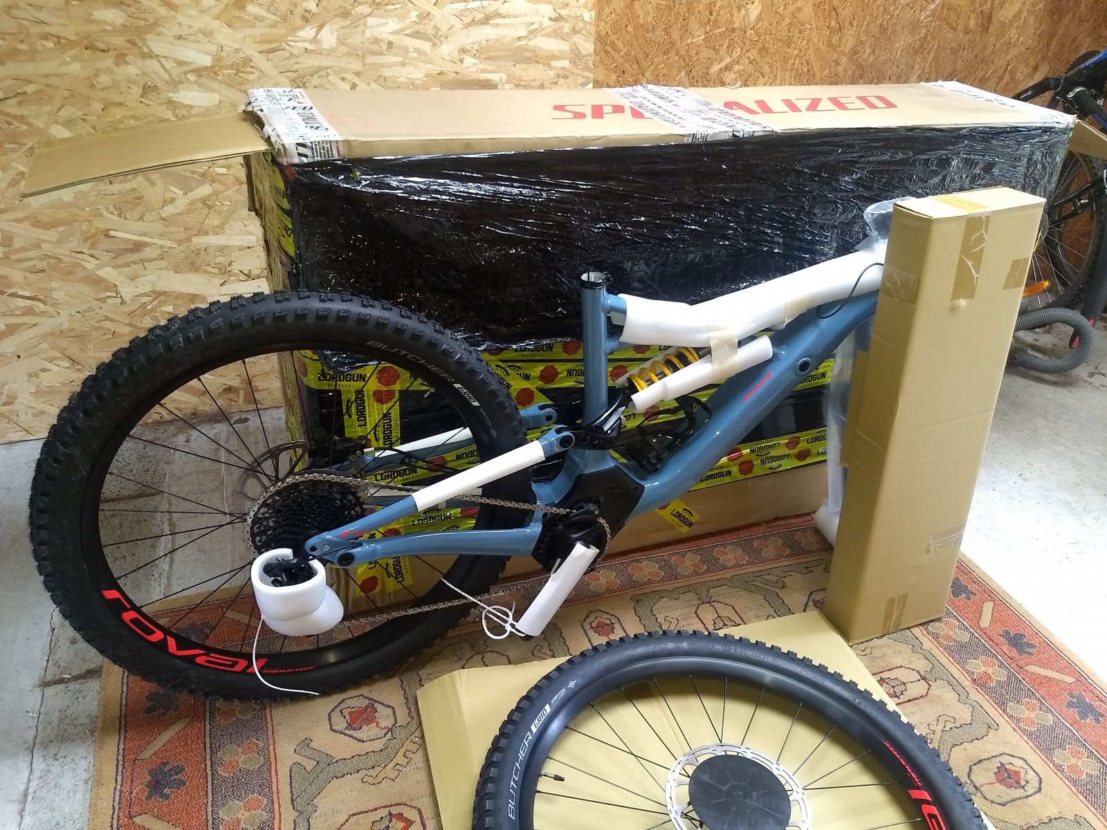

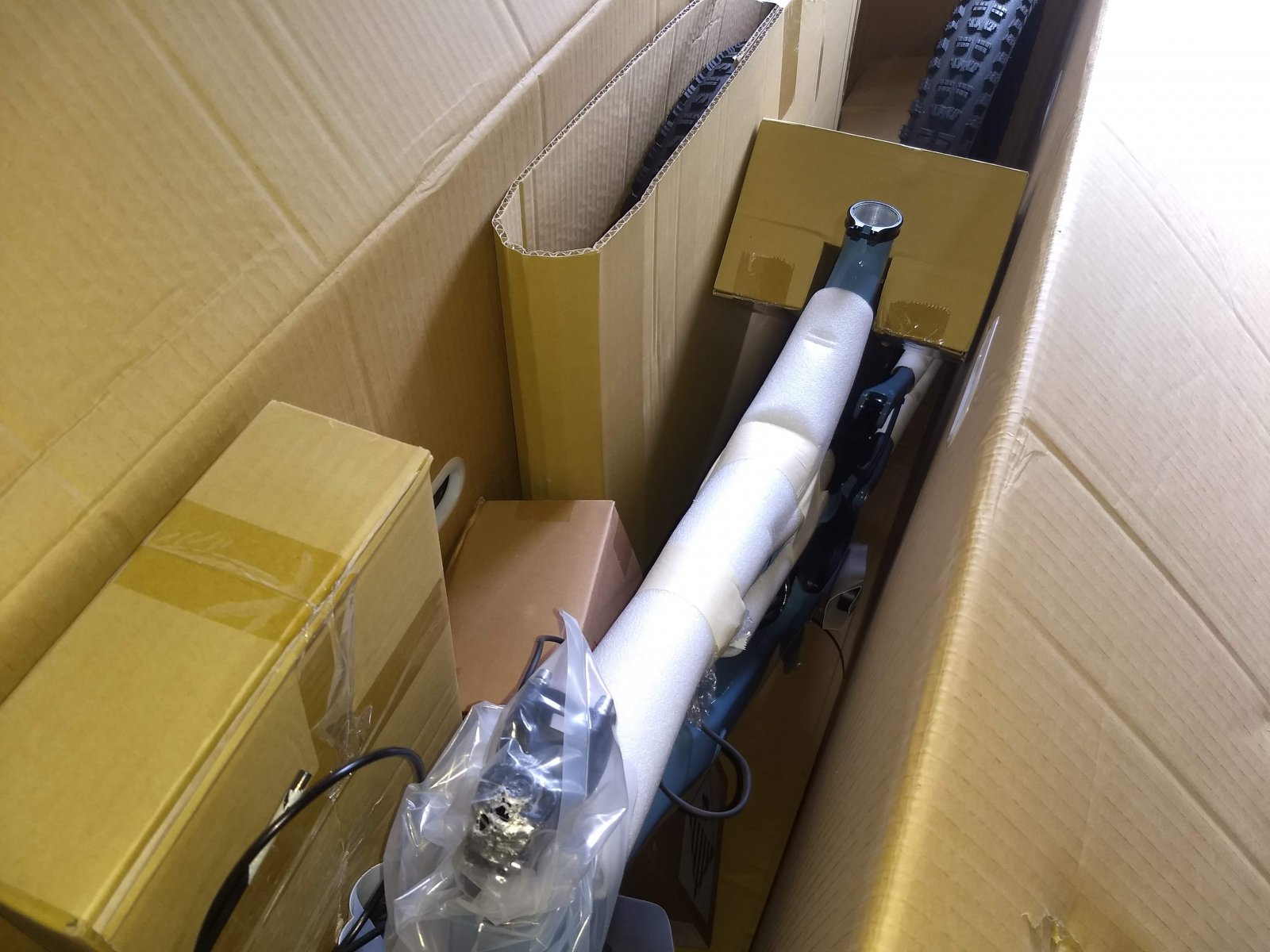

Just arrived ! Sadly no time to do anything with the huge box at the moment ...
I think it's maybe new bike day for you too ????
Wonder if they accidentally put a 2020 bike in the box .. I think, according to Schrödinger's cat / Quantum mechanics and the entanglement theory .. as long as I don't open the box - I might have a 2020 Kenevo ...
Lashings of armoured tape .. ?!?
Things were looking up ...
Bloody Schrödinger's cat ... it's a 2019 ..
Might find sometime tonight for some assembly ..

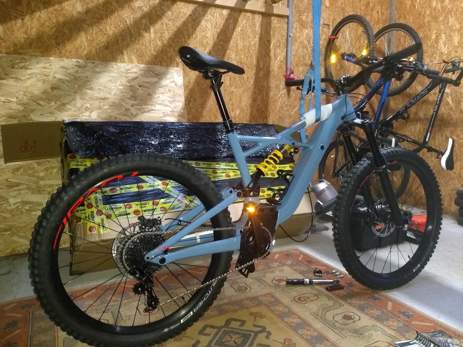

Battery charged and pretty much together. Need to check it all over tomorrow. It powers up, connects to mission control .. seems to have a zombie walk mode if you press the down button the back wheel just turns on it's own forever .. is this for chain lubing or a pretty display mode ? :) Did a 20 meter ride just to make sure it works and it does .. The Kenevo has landed !
It certainly looks a beast ..
Once question which I will regret asking for all eternity due to it's stupidity .... HOW do you tighten up the handlebar mode controller switch ?? it slid on, but I didn't notice anyway to secure it ?!?
