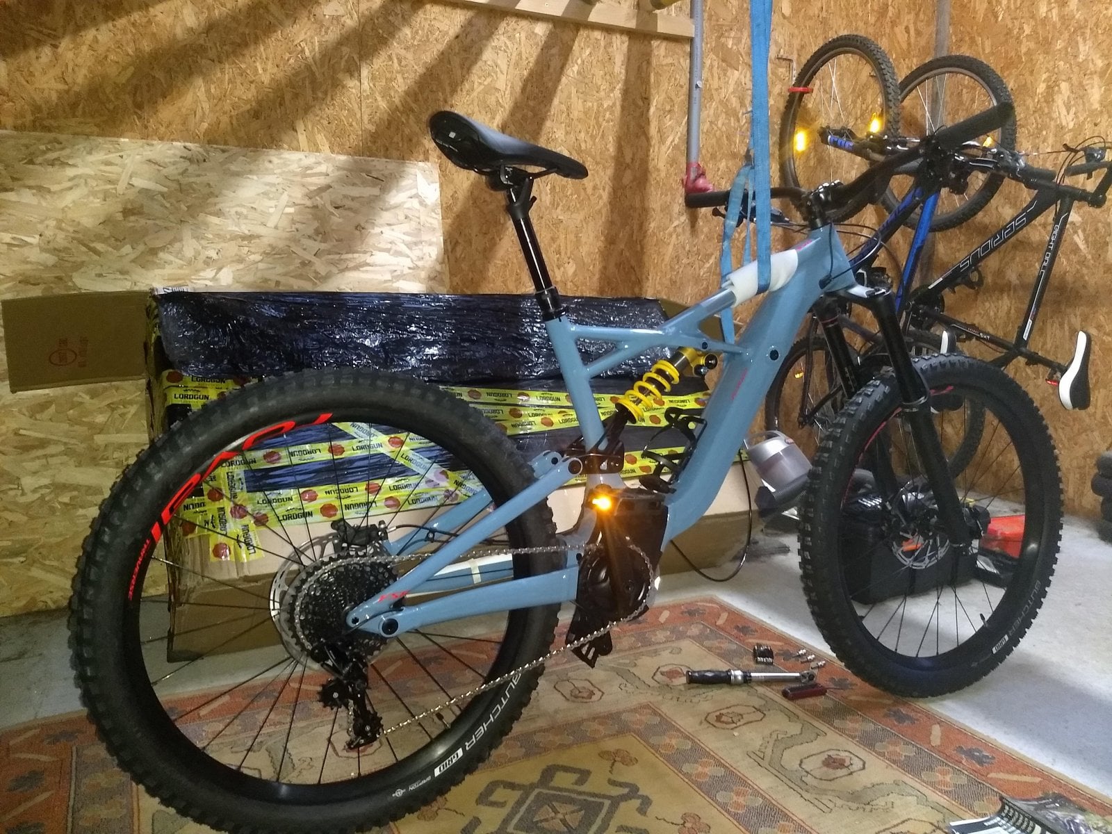

Battery charged and pretty much together. Need to check it all over tomorrow. It powers up, connects to mission control .. seems to have a zombie walk mode if you press the down button the back wheel just turns on it's own forever .. is this for chain lubing or a pretty display mode ? :) Did a 20 meter ride just to make sure it works and it does .. The Kenevo has landed !
It certainly looks a beast ..

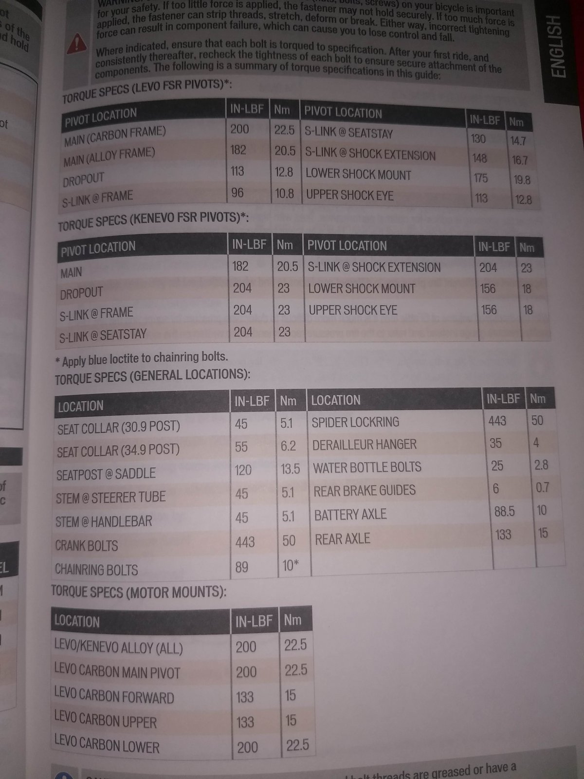

Some levo and Kenevo Torque settings lbf &nm : (which are probably available on-line, but what the hell)

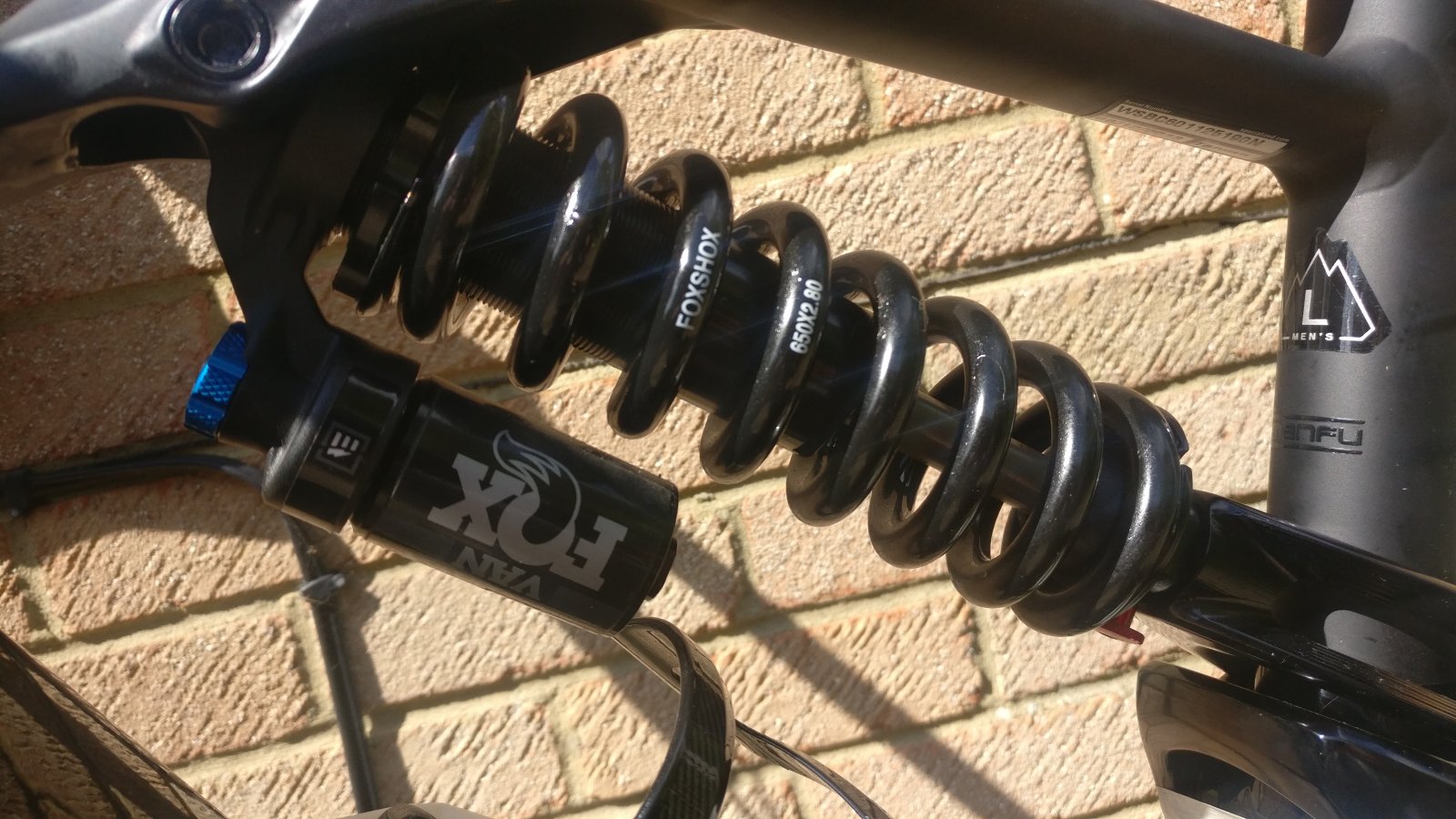

FFS mine has arrived but has a fox van coil shock fitted instead of the ohlins.
EDIT in addition to being the comp shock (I didnt know that cheers Christian!) Its also covered in oil, so looks to be leaking.
Whhoooop happy new bike day :(
Your is a comp model. They come standard with that.
No its not. Its an expert. Everything else appears to be expert spec, but the shock. Although I am very carefully checking over now..
