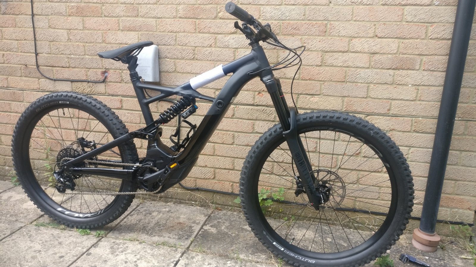

Is it black or grey? It looks gunmetal grey in the photo which I thought was the US spec Comp
Definitely black. Definitely an expert. All the other bits are as they should be now I've checked it all. Back to Rutland we go..
EDIT It feels a bit weak riding it around also, not much power despite a full battery. Need to check its not got the 1.2 motor also.
It does look hot with that blacked out spring though. But yeah get it checked out, you should get what you paid for.
The firmware is old but the bike is exactly as it should be bar the wrong shock. The fox van came with a 450 spare and fitted 650.
I'm actually wondering if I should negotiate a decent discount and keep the fox van rather than getting Rutland to fit the correct ohlins? It looks pretty smart all in black. the bottle cage can't be used with the piggyback though, which is annoying.

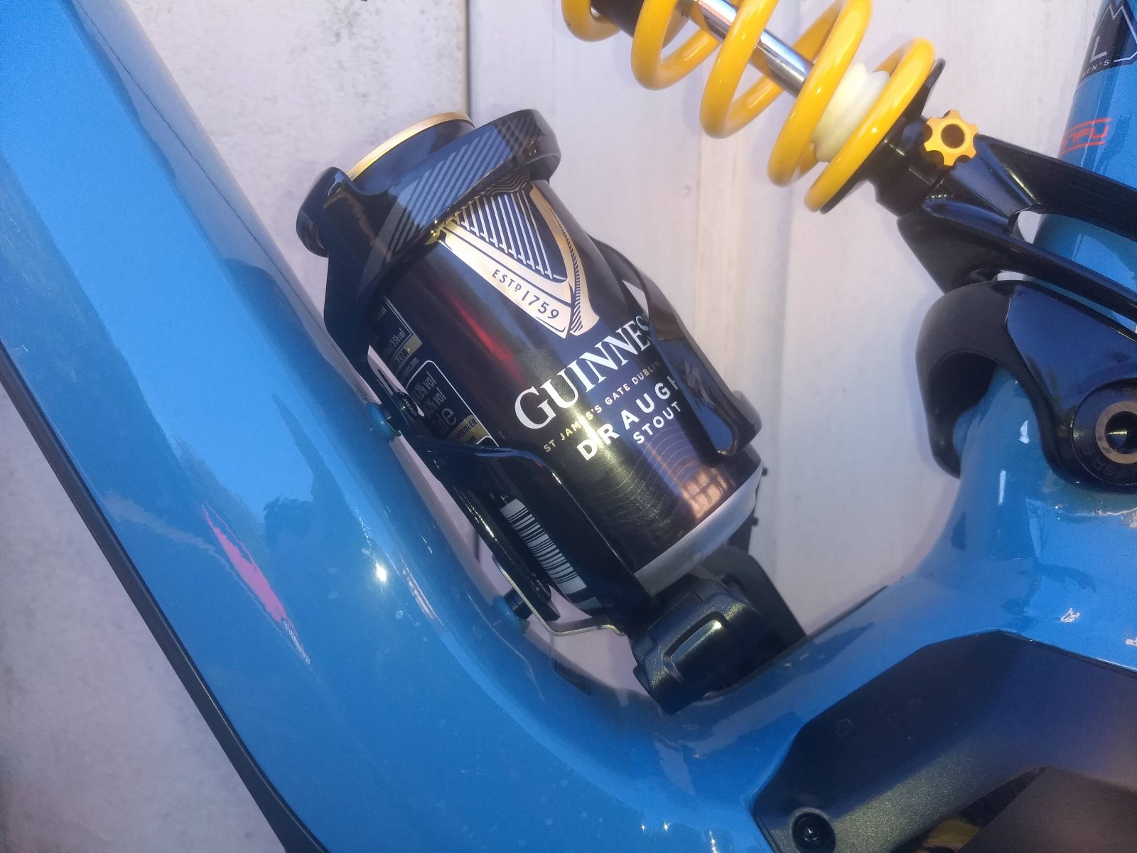

You can still use it - and maintain the black theme !

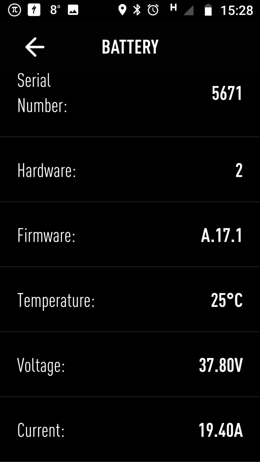

Can you get it to connect with mission control ? you can check somethings in there too and check the firmware etc at the same time - like mine.

If I get time later I'll see if the Fidlock bottle fits on the Kenevo. Probably too long at a guess without looking, so might need the 450ml one.

Would be nice .. I can't even get the mission control software to show me power and amperage usage ?! just seems to show my speed and a couple of other bits.. I guess I'm being dumb.

Fidlock 600 does not fit the Kenevo Expert. I think the Fidlock 450 would probably fit.
Need to find a new place for the swat tool if you went that way.

I can see current under diagnose > battery. The max I saw with me holding the phone with one hand & pedalling hard was about 12 amps. I recall seeing I should see up to 20amps on another site, lots of disjointed information.

Ah ha ! I was right .. I was being dumb .. I was looking at "motor" to see what it was drawing .. not "battery" .. will try that !
The easiest way to see if your motor delivers the 20A is to find a small hill, set “Turbo” to 100/100 and pedal as hard as you can in a little too high a gear for normal riding. MC should instantly show just around 20A. If not, it’s on the Brose fall back safe firmware and it then need a forced firmware update from a specialized dealer. This is for the 1.3 motor, I do believe that the 1.2 is limited to 15A by Specialized.

The easiest way to see if your motor delivers the 20A is to find a small hill, set “Turbo” to 100/100 and pedal as hard as you can in a little too high a e 1.3 motor, I do believe that the 1.2 is limited to 15A by Specialized.

Useful. I hadnt set it to 100% on turbo. I think the default is 50% or so. If I can get the damn thing to turn on later, I will try it :)
A two minute "play" in the interest of scientific advancement .. uhmmmm .. ok, so it was just a 2 minute play ..
Did the Karsten technique, twice .. same results both times .. 80% battery.
High gear, standing start, hill .. (how does Karsten know this technique when there are no hills in Denmark ?)

EDIT: the shop also had more love for the fox van than the ohlins, so I may try to get some money off rather than waiting on rutlands trying to source the correct shock for this bike. Retail a fox van is about £300, the ohlins £600. If I can get £100 or so back that will do I recon.

I had had a bit of a result after my purchasing woes. The shop offered me £300 back due to the wrong shock as they couldnt find the ohlins, way way more that I was expecting. This along with £44 of rewards from the bike purchase, plus a £50 off code on their website, plus them being £35 cheaper than other places, brought the price of a new spare battery down to £321 :eek:
What shock have you got?
The bike was supplied with the fox van from the comp model rather than the ohlins the keveno expert should come with.
Based on advice from berkshirecycles they suggested I was better off keeping this shock anyway.
